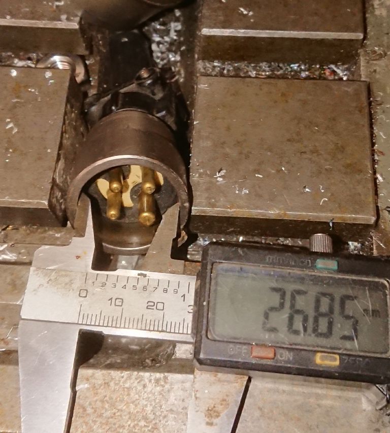

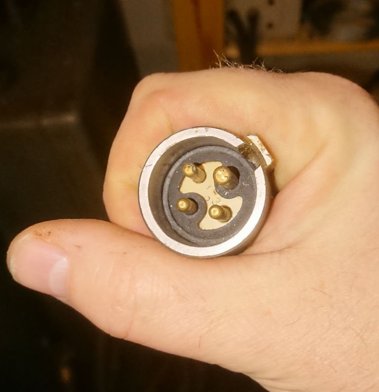

      I need a connector for my Adcock&Shipley Bridgeport, but I don't have the foggirst idea what to search for. Can anyone ID the type for me?

              On my A&S made Bridgeport it says on the connector they are made by LPA. Rather to my surprise LPA are still going and are relatively close to me, in Saffron Walden.
              LPA Group
              The part number on my connector is X4S which is part of the LPA Niphan industrial connector range. However the push fit/panel mount version appears to be obsolete. The group as a whole seem to be heavy industrial so their products are unlikely to be stocked by distributors.

                That's it! Thank you so much Andrew. It's definitively the X4S, and from what I can tell it's completely proprietary and obsolete. Guess I'll have to swap out that plug with something more current. It's a bit of a hassle but it would be nice to have a spot light wired to the control box.
