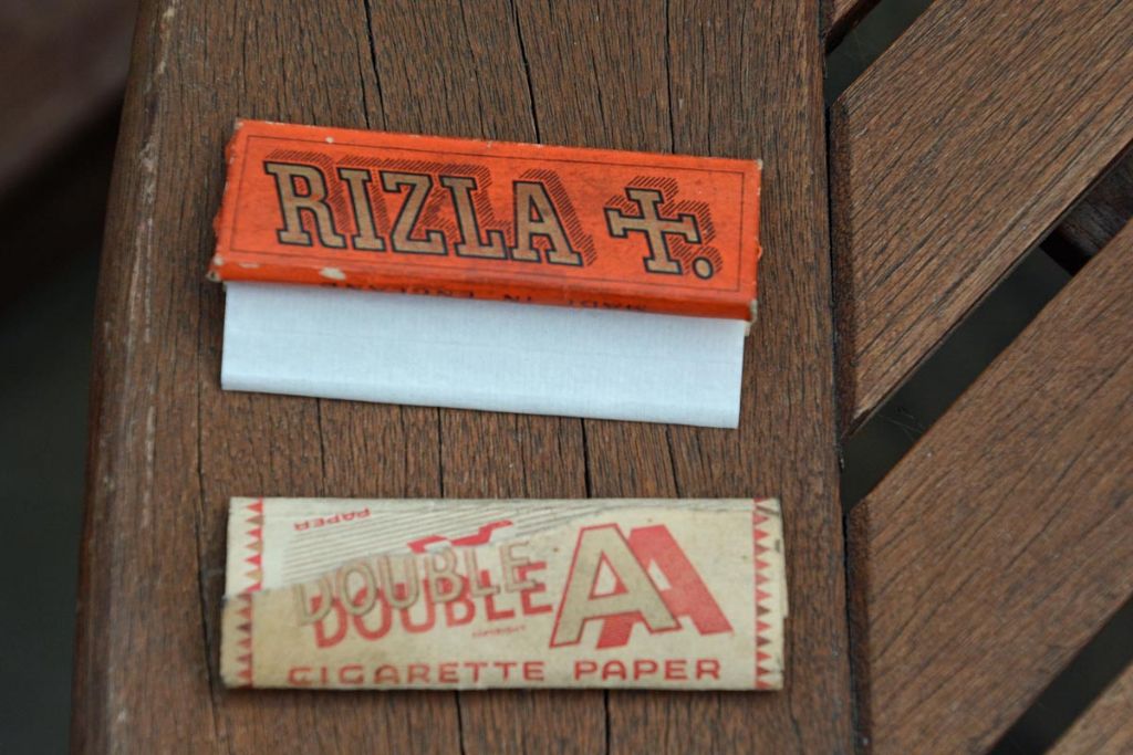

                                            Roderick Jenkins
                                              @roderickjenkins93242
                                              These came with my s/h S7:
                                              The Rizlas are 1 thou.
                                              The Double As are 1.5 and may be genuine antiques wink
                                              Stay well,
                                              Rod
