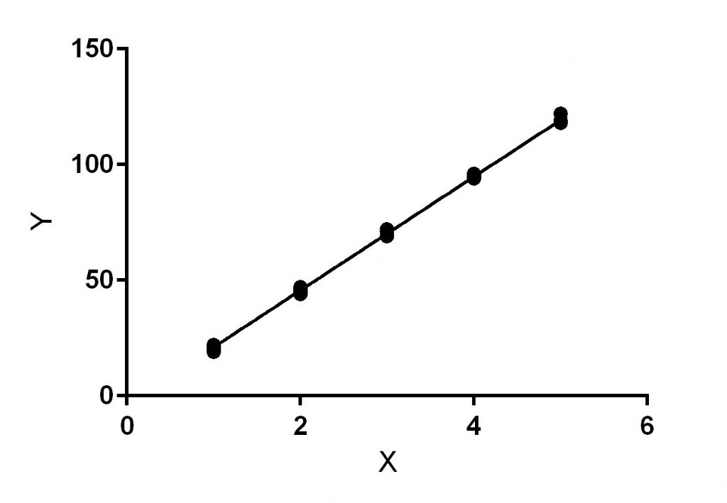

                          Robin Graham
                            @robingraham42208
                            I obviously have too much time on my hands – a while back I also asked myself about thickness of fag papers, and made measurements of stacks of 1,2,3,4 and 5 papers, taking five measurements at 'random' locations for each stack. Results for Rizla green (X number of papers, Y thickness in microns):
                            Linear regression gives a slope of 24.56 +/- 0.18 microns, with 95% confidence interval 24.20 – 24.92 microns. So I think we can say a thou! No doubt, in time, metric papers will be available.
                            Robin.
