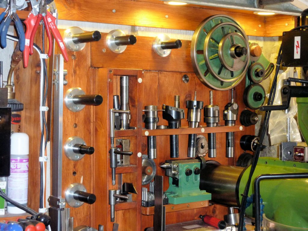

        Originally I used wood dowels knocked into 4×3" timber to hold my chucks but upon inspection I found one had split meaning there was a risk of it breaking and falling off. Not good. So I removed all the wood dowels (with the exception of the one for a small 4" 4-jaw which weighs little) and replaced them with Delrin rods screwed into alloy flanges. The other advantage of doing this was each mount could be re-positioned if required as my collection of chucks changed. The Delrin rods are screwed into the flanges with an nice fat thread (0.75" x 18tpi) so no chance of them working loose or falling off

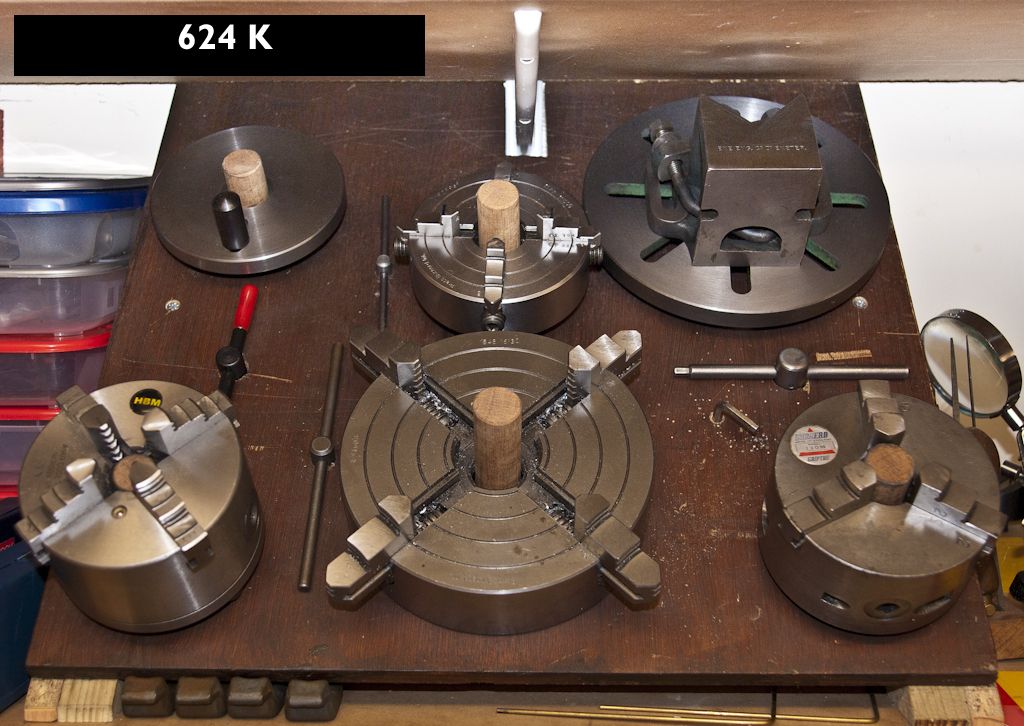

          I too store my ( comparatively measely !) collection of chucks etc. on a board – but in my case the boardis  on a shelf above a bench. The fact that the board slopes helps to keep the chucks on their pegs. Various MT items ( chucks,die holder etc) are mounted through holes in a similar board.

            I was taught that chucks should always be stored the other way up for 2 reasons:-
            First, to prevent swarf and other muck falling into the scrolls / slots the jaws slide in
            Second, so that the chucks do not rest on the back of the register (I think that is the correct way to describe it) so that nothing sticks to it or marks it.
            Please, what is the collective wisdom of other more experienced people here ?
            Thanks, Stephen S.

              You raise a couple of fair points Stephen, but I don't think it is the actual storage method used that is of concern – materials like alloy/wood/Delrin are not going to damage the register even if it does rest on it. Swarf and muck will work its way into the scrolls mainly whilst in use on the lathe machining stuff (and opening and closing the jaws drags it into the scroll), but not when it is sitting in a rack in storage. Personally, I always clean my chucks after use with a vacuum hose which removes any loose material, and wipe out the register with a rag before it's mounted onto the lathe. Maybe once a year I will strip and clean the chucks depending on the amount of use each has.
              However that raises another point – lubricating chucks. I note even Pratt-Burnerd specify a ceramic grease for their chucks, but I wouldn't put any sort grease on a lathe chuck. Grease attracts and holds particles of swarf so it won't fall out and you can't suck it out either so a full strip down is needed to clean it. Machining cast iron would be quite destructive with a grease-filled chuck. I use a light oil instead (and only just enough to do the job). Yes, it tends to spray out when the chuck is turning at high speed but that is a minor irritation.

                            I have two brackets made of 1 1/2" x 1/4" angle iron, flang down , and a bit of hose split along its length over the edge where the chucks lie. The bracket is at lathe bed hight, and in line with the tail stock end of the lathe, and are moved back and forth with my over head hoist. Hoist made from a garage door opener motor, and the rails made of two lengths of angle iron, welded back to back. Ian S C
