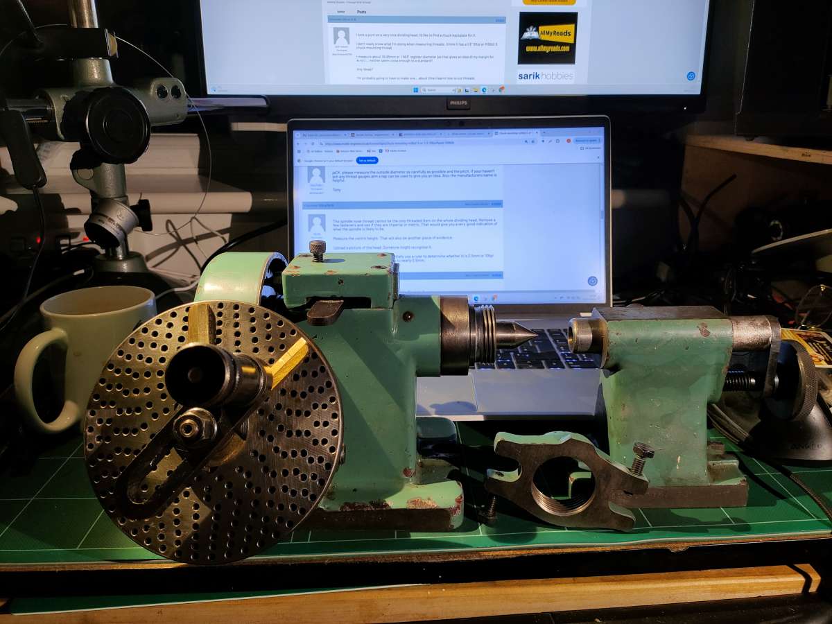

      I took a punt on a very nice dividing head. I’d like to find a chuck backplate for it.
      i don’t really know what I’m doing when measuring threads. I think it has a 1.5″ 10tpi or M38x2.5 chuck mounting thread
      I measure about 39.65mm or 1.563″ register diameter (so that gives an idea of my margin for error) … neither seem close enough to a standard?
      Any ideas?
      I’m probably going to have to make one… about time I learnt how to cut threads.

                    DC31k
                      @dc31k
                      The spindle nose thread cannot be the only threaded item on the whole dividing head. Remove a few fasteners and see if they are imperial or metric. That would give you a very good indication of what the spindle is likely to be.
                      Measure the centre height. That will also be another piece of evidence.
                      Upload a picture of the head. Someone might recognise it.
                      At that course pitch, you could potentially use a ruler to determine whether it is 2.5mm or 10tpi. The difference over 25mm of threads is nearly 0.5mm.

                        jaCK Hobson
                          @jackhobson50760
                          thanks for trying to answer.
                          The register diameter is larger than the thread diameter.
                          I have thread gauges. 10 tpi is amazingly similar to 2.5mm… obv if it was 2.54 then it would be same. But over 3 threads, cheap gauges, and my eyesight…
                          60 degree, not 55.
                          38mm external thread diameter on the dot as far as my eyesight allows which encouraged me to consider metric. 1.496″
                          Horizontal dividing head with tailstock. MT2 in head, MT1 in tailstock. 4″ centre height.
                          I think it is pretty well made… so tolerances might be high.
                          Cap head screws take a 3/16″ allen key. 20tpi. .24575″ diameter (using digital mic instead of vernier caliper). So pretty convincing on the imperial bolts?
                          Green.
                          No markings that I’ve found.
                          #769608
                          jaCK Hobson
                            @jackhobson50760
                            40:1 worm drive with 60 index holes in the head gear.

                            Tony Pratt 1
                              @tonypratt1
                              Elliot dividing head so British.

                              peak4
                                @peak4
                                Have a read of this thread; Elliott maybe??
                                Elliott dividing head
                                See also near the bottom of this page
                                https://www.lathes.co.uk/elliott-omnimil-00/
                                Bill

                                          If its an elliott the smaller dividing heads have a 1.5″ x 10 UNS thread
