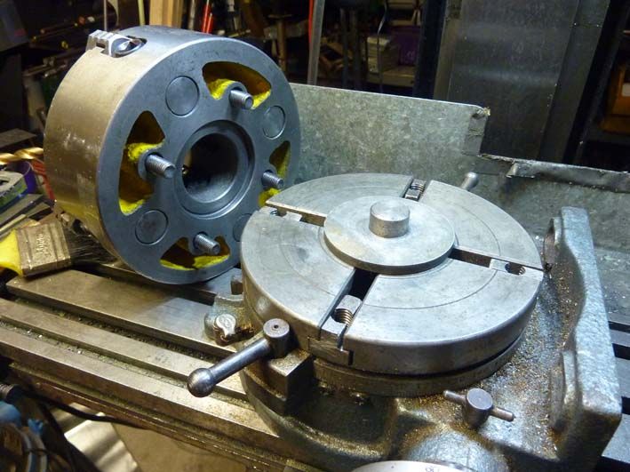

              Hi Chris, I would use a chuck that has 4 bolts to match the 4 slots on your rotary table. I have a 150mm chuck on a 150mm rotary table. It is held by tee nuts and a disc which is located on the rotary table center.
              If you are buying a chuck just for the rotary table I would go for one which is the same diameter as the table. A 4-jaw chuck is more versatile. It can hold odd shapes and is more accurate for centering round parts.

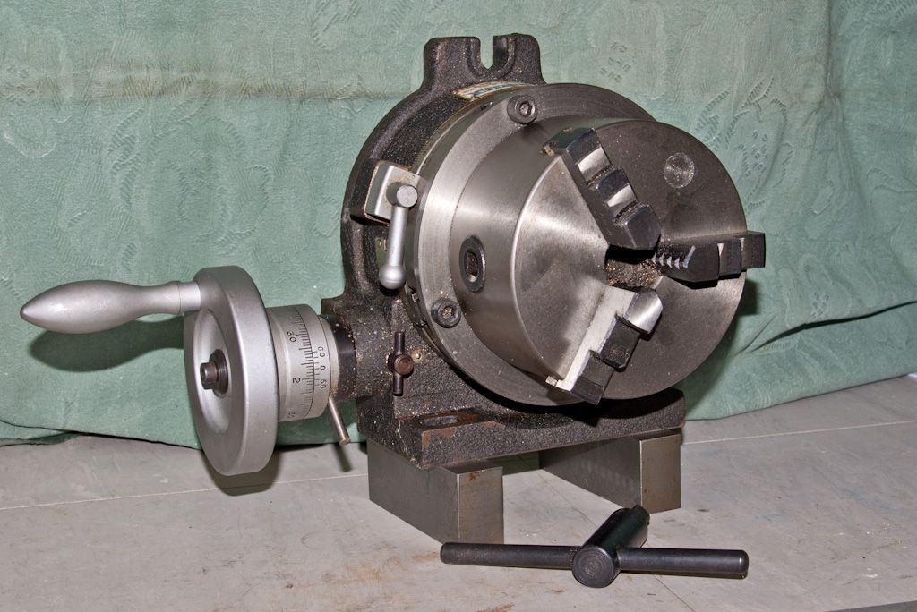

                If you have a chuck like Paul's that fits the table then that is probably the the best solution. In my case the chuck is the type with the mounting bolts at the back. My solution was to make a backplate from a piece of 1/4" plate which was a little larger in diameter than the chuck. The photo probably avoids further explanation!
                Vertex rotary table
                You will see that this IS a 125mm chuck on a 150mm table –  so yes it does work!
                Regards
                Norman
                Edited By NJH on 27/04/2014 09:28:49
                #150822
                NJH
                  @njh
                  "The photo probably avoids further explanation" or it would have done if I had thought to add that the chuck is fixed through the backplate ( from the table side) by 4 socket headed countersunk screws!

                    Seriously though … wouldn't there be three screws holding a 3-jaw chuck?
                    #150832
                    NJH
                      @njh
                      I guess you may well be right Michael – three screws would be more likely than four to hold the chuck. I could confirm this for you but that would mean that I had to take the chuck off the table – and then go through the process of getting it centred again! ( In truth that is not too difficult – I made a long bar with a No2 MT on one end and, with this in the socket in the table and the chuck closed onto the parallel portion, it's pretty close.)
