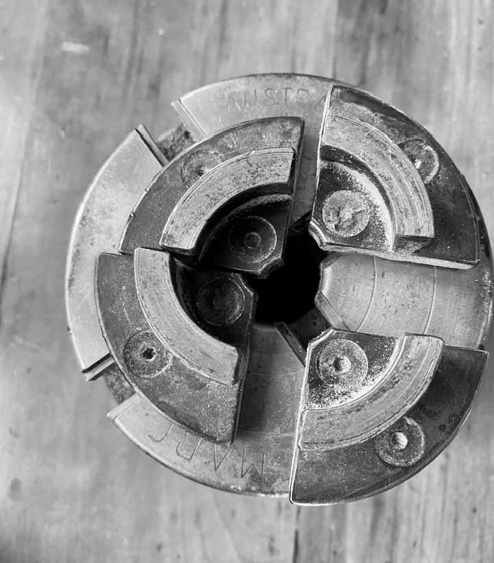

      What happens after a wood turner attempts to clean a chuck. 😄
      IMG_9447
      #717321
      Mick B1
        @mickb1
        Have they just put the jaws in at random, or is there scroll breakage?

            Take them out and start again look for numbers on the jaws and the face of the chuck. or unwind and then turn in a bit from the release point and try again – you will get it right in the end and then mark the jaws ! Noel.
              That would be my guess. Many wood turning chucks have well labelled jaws making reinstalling them straightforward.
              Two of mine are like this but one just has small dots to distinguish them

                  Console yourself that with just four jaws, you have only about five chances of getting it wrong
                  (4x3x2) / 4 if my maths is correct (Of the 6 possible arrangements, one will be correct)
                  If the jaws and chuck body are not numbered, would ikt be worth lining themall up, with the “teeth” showing, so that they can be shuffled around until the Teeth are in the right order, (As you could do with a 3 jaw chuck)
                  Once sorted, i would then mark the chuck body and the individual jaws, to save pain at any future date.
                  Howard

                    Two of my wood turning chucks are clearly marked. The other one I have isn’t, but you can’t remove the chuck jaws (wood turners call them carriages, travelers or carriers 🤣) anyway without taking the chuck apart.

                      I have two of these chucks – the ‘outer’ sections (held on by the countersunk allen head screws) must be fitted to the correct moving jaw part in the chuck body – the segments are numbered as are the moving jaws. Obviously, the moving jaws must also be in the correct slots – corresponding to the stamping on the chuck body.
                      The ‘outer’ sections shown are for gripping an internal cavity in the workpiece, and can be changed for pieces designed to grip the exterior of the work, which is why they are removeable – just like the inside and outside jaws of a metalturners 3-jaw or 4 jaw chuck.

                          This is incorrect. I have Axminster, Record Power and Nova chucks. It makes no difference which chuck jaw goes into which slot, they just need to be installed in the correct order. Same with the top jaws, it doesn’t matter which chuck jaw each one is attached to, they just need to be attached the correct way. After turning, the top jaw assembly is numbered and then cut into four parts. It just makes things easier for users if manufacturers number everything, but not all do.

                            I beg to differ. In precision chucks, the jaws are internally ground after assembly, so it is important they go back into the correct slot. Of course, they can be fitted – in the correct sequence – into any ‘starting’ slot, but accuracy can’t be assured.

                              Don’t forget we are talkimg about woodworking chucks here, so ‘high precision’ does not really apply. As Vic says, they just need to be fitted in sequence to ensure they end up concentric, but you obviously need to know which one is 1,2 & 3. Which slot in the body you start from is irrelevant for this application.

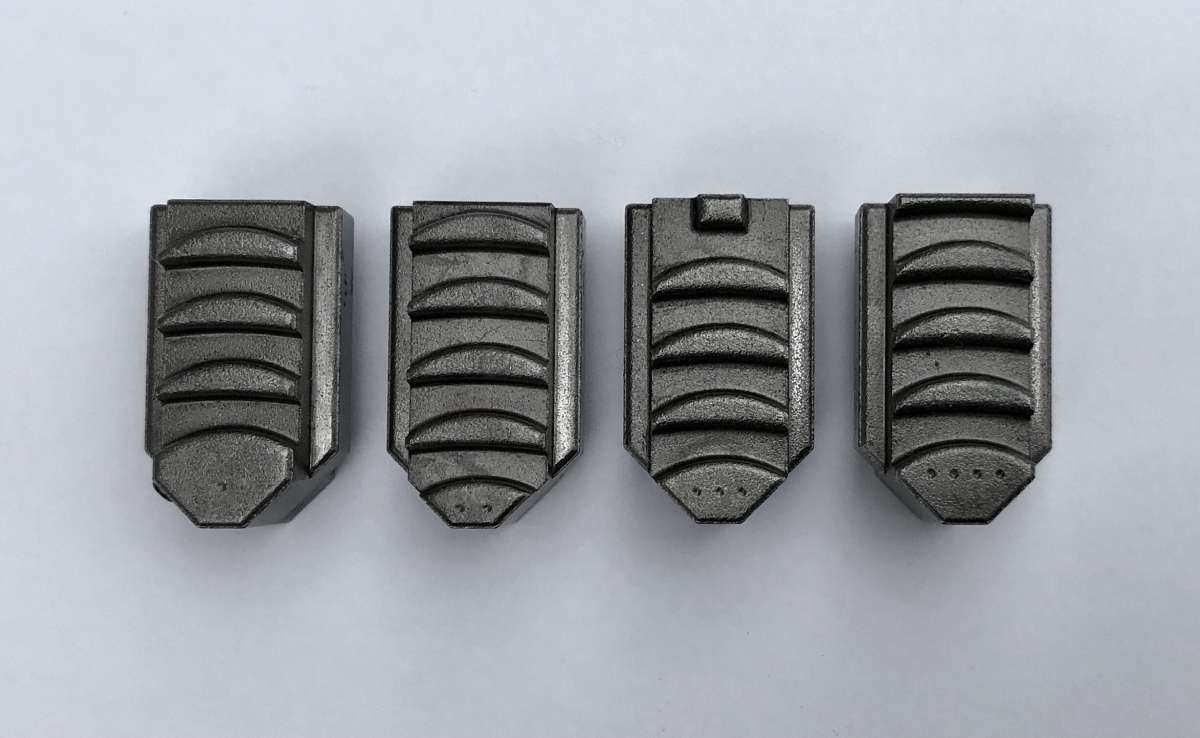

                                  For those not familiar with wood turning chucks, these are the jaws from one of the more popular chucks on the market. More than adequate for the job but hardly what most might term precision?

                                    Hi, I’ve not seen any chucks of this type, but going by a normal 3 jaw chuck, I would think if you moved the two on the right hand side, to the left hand side of the two that are on the left hand side in Vic’s photo above, you would then have them in the right sequence, and put them in that order starting with the one at the new left hand side.
                                    Regards Nick.
                                    #717925
                                    Nigel Graham 2
                                      @nigelgraham2
                                      It helps too, actually to ensure the scroll really does pick up the first “tooth” on the jaw…
                                      Many’s the time when changing between external and internal jaws I’ve had to take them all out and start again. I do it now by carefully feeling each jaw drop into the start of the scroll – oh, and number-for-number.
