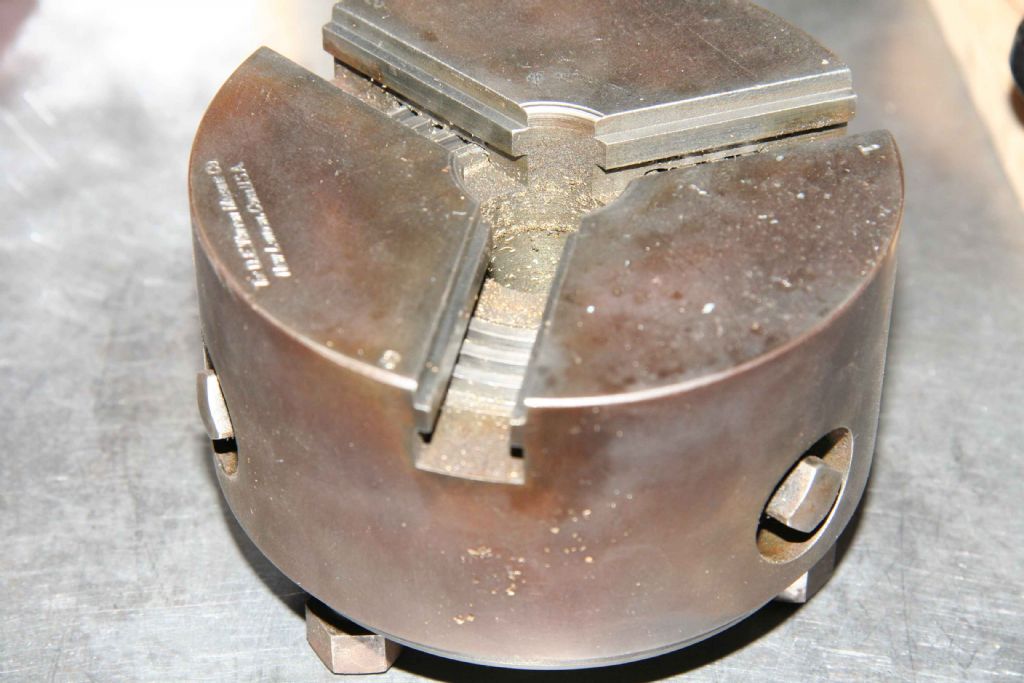

      I have an old (probably very old!) 3 jaw 4 in chuck which I am trying to dismantle for cleaning.
      After removing the backplate it can be seen that the rear centre section will come out but appears to be prevented by the scroll operating gears, and I cant see how they come out!
      The manufacturer is – The DE Witch Machine Co of New London, Conneticut USA (needless to say I cannot find them) and is unusual in that the chuck key requires a female square to fit
      Other chucks I have retain the gears by a pin or screw.
      Alan

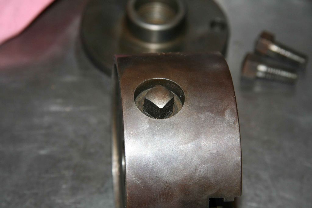

              Thanks for your reply, when the schroll is tapped it moves the centre section (with a join line around the bolt holes) – oily line in second photo
              However it will only move about 25 thou before it stops against the gears (they go tight)

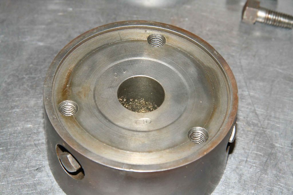

              and I cant see any method of retaining them! third photo
              I believe I somehow need to pull the rear section out to gain access to the gears and their retaining method
              Alan

                Whoops! Thats what happens when you take photos in the half light!
                The name is ‘DE Whiton’, (not Whitch) who appear to be well heard of in the chuck world!
                Having another look it seems I might have to make a puller to extract the rear section.
                Alan

                  I think these chucks have pinions similar to early Pratt Barnard (1940 ish) .. held in place by from the centre unlike later PB which are held in place by a pin. I found it difficult to use a puller. The mallet/hardwood trick is unlikely to do any harm as long as you keep moving around the centre. I think I can see the join line in the cventre in photo 2. A good prior soaking in a light machine oil helps but clean the oil and any debris off inside the centre before using the hardwood otherwise you will get very little purchase. Alternatively use a brass tip on the end of a punch.
                  David
                   PS I think your gear may have gone tight due to corrosion around the part of the pinion at the inner end. If so you should be able to clean it away – do not force any movement of the jaws – that could damage the pinion.

                    If you look at the back of the chuck you will see in the screw holes a discontinuity. This indicates that the centre of the chuck back is separate and splits on a line at about 1/3 of the screw’s diameter. The screw threads actually hold the whole thing together. The front view confirms this. You will see a fine band showing where the inner part joins the outer from the back.
                    When assembled the whole thing would have been machined. The ‘DE Whiton’ company did not mean it to come apart.
                    If you have a small woodruff cutter, cut two shallow grooves just on or below the joint as seen in the photograph. Use a brass punch and drive the back out. If that does not work. If SWMBO is agreeable (or is out) stick it in the oven at about 120° C for an hour and try the brass drift again.
                    Good luck. If you have to be really rude to it well at the moment it will not work so you cannot make it much worse.
                    Dick

                          Thankyou for all your advice! As I said if the scroll was tapped back into the body it would push the rear centre out but would then stop because of the pinions and yes the join line goes through the bolt holes (photo must be better than I thought!)
                          Today I had a surge of inspiration! I found an old suspension rubber bush which was a very tight fit in the chuck bore, I then found some thick close fitting washers and with a length of 10mm studding compressed the bush in the bore – really tight
                          I could then tap out the rear of the chuck, voila!
                          It was a really tight fit but very well machined with the pinions coming out from inside
