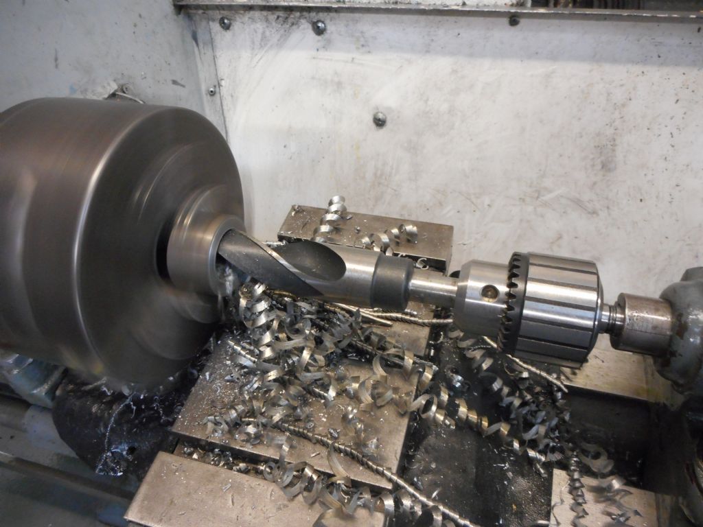

              I did an article in MEW on this very topic a couple of years ago. Two good firm taps with a copper hammer is all it takes. My test example for the article was a 13mm chuck on an MT1 arbor, so quite a small taper the chuck mounted on. I tested it in the lathe with a 1" drill bit with the shank turned down to 1/2". Tried everything drilling a hole in steel and could not get that taper to let go. You would shear the key in the tailstock or slip the belts first I reckon.
              One tip I learned from old time Harley-Davidson racers when assembling their flywheels with tapered crank pins is to wash the tapers with distilled water before assembly. The factory race team always reckoned that degreasers leave a film and solvents including alcohol leave traces of salts on the tapers that can interfere with the fit. Seems to work for me.
              And of course you must go over both tapers first and remove any burrs. The ends of the taper on the arbor always seems to need a little bit of a clean up with a fine file.
              1" drill mounted on MT1 taper in action:
              picture 7. chuck arbour.   taper does not budge under load when drilling a one-inch hole with heavy feed..jpg
