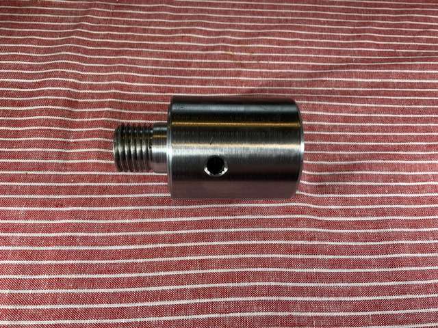

            Ian Parkin
              @ianparkin39383
              I make lots of chuck adapters and can confirm that they are not made in quantity commercially
              this is the style that i make IMG_1692
              #689711
              Ian Parkin
                @ianparkin39383
                That particular one is for a wadkin RU which is 2” 4.5 tpi and it has a m33 x 3.5mm male thread and it weighs 2.5kg

                  Most adapters for wood lathes move the chuck quite a way from the headstock bearings do not such a good idea. One guy on one of the woodturning sites had a new spindle made with an M33 thread for his old lathe.

                    A 6 tpi Whitworth form thread has a depth of 0.1087, so will be too deep to be cut immediately above a 33 mm thread.
                    So the adaptors will have to be such that the 1 1/2 x 8, and 1 1/2 x 6 external threads have to be cut outboard of the internal M33 thread.
                    Possible, but the downsides are
                    1) Increased overhung loads imposed on the Headstock Bearings.
                    2) Decreased centre distance
                    How damaging are these features you have to decide.
                    In most cases, with commion sense, neither should be a job stopper.
                    Howard
