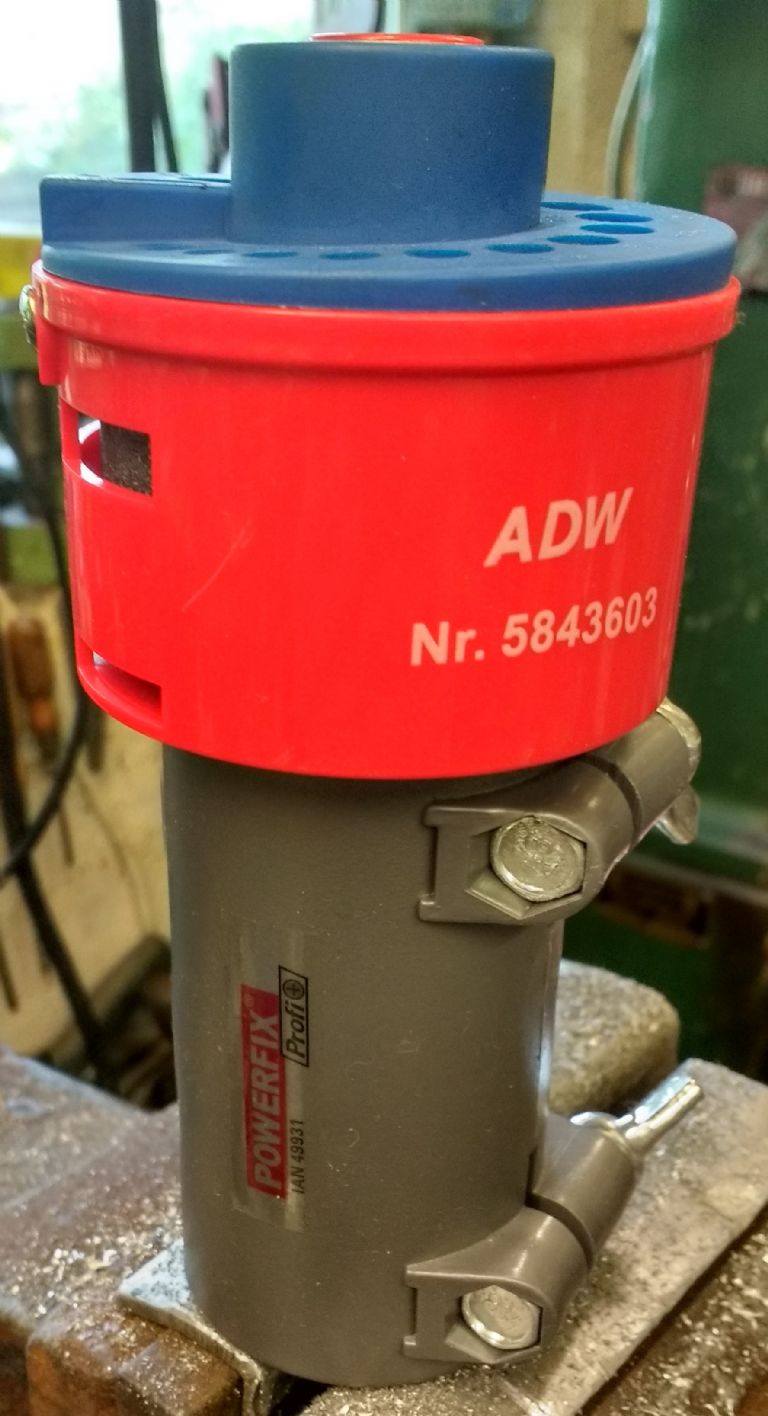

            John MC
              @johnmc39344
              This drill sharpener was a pleasant surprise! I bought it from Aldi (under a fiver, I think, complete with a spare grinding wheel) several years ago as a means of sharpening drills "off site". It works very well. Power is provided from an electric drill, I used a drill with a top speed of about 3000rpm, not really enough but I suspect running any faster would shorten it's life significantly .
              Copes well with both HSS and tipped masonry drills.

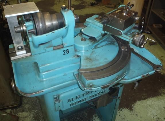

              Buffer
                @buffer
                Why is it that all the drill grinding jigs I see have the drill pointing up? This seems to need a fairly high grinder and a tall jig. Why cant the jigs be mounted horizontally and use the bottom of the wheel?
                Only asking as I am thinking of turning a tripet grinder like the one below into a tool and drill grinder and I have never used a drill grinding jig before.
