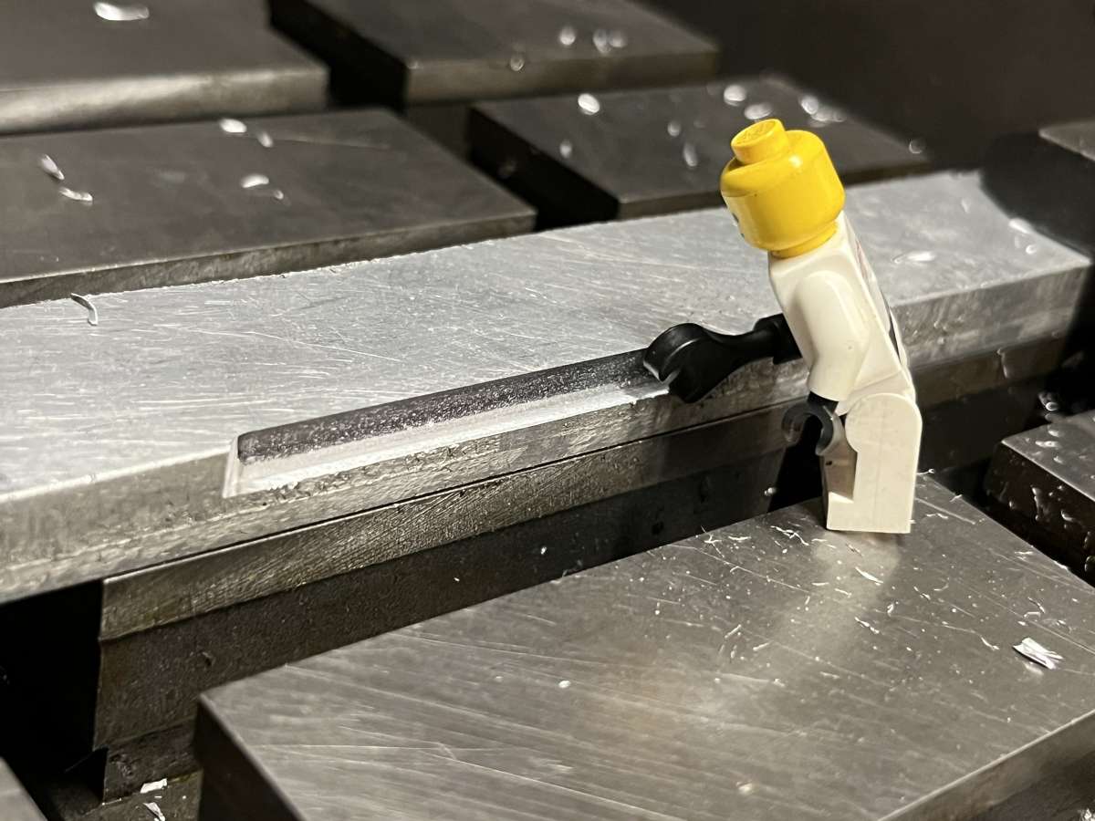

      Evening all.
      Just in from the garage where I have finally made a cut with my CNC.
      Hand coded the GCode as I was standing there, and pressed cycle start and it didn’t break 🙂
      https://m.youtube.com/shorts/QKgoioTU0yU
      13500 rpm, 3300mm/min feed, 6mm 3 flute solid carbide.
      1mm WoC, 8mm DoC, 50mm long.
      IMG_6522
      2 passes. Think 1×8 is at the limit of the spindle – you can hear it on the second pass. The first pass already had a 3mm deep x1mm cut so was more like 5mm DoC.
      Next to figure out Fusion posts and do some precision checks.
      #788382
        Off to a good start. After a while you will find what works best in various situations.
        #788383
          A joy to behold !
          … nice chunky machine.
