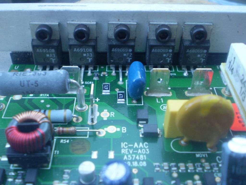

        Just a shot in the dark ,but.
        has anyone any experience with the Mossfits on the PCB. The ones that are used are listed as discontinued and no data sheets are available to cross reference .
        Thanks for any info,

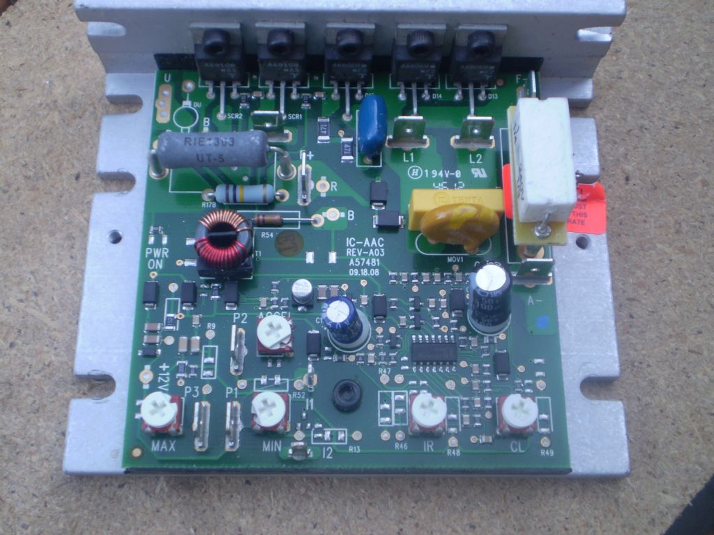

                p1010046.jpgp1010045.jpgHi guys,
                sorry for the delay in posting a reply. I couldn't find my camera.
                I have posted some photos of the offending board so you can see the parts and numbers.
                The board has been tested and the other componants seem to be fine just thes mossfets. I can't find any data sheets so as to cross ref .So in the dark really unless you have any ideas. Its the two mossfets on the left that are causing the problem A69108 .But a alternative for all would be great.

                  Errr, what makes you think that they're MOSFETs? The ref idents seem to be SCR1 and SCR2, which rather implies that they're SCRs.

                    They are SCRs, S8020L might be a suitable alternative (Farnell etc)

                      As does a google search on "A69108 equivalent".
                      That looks like a US controller board, the chinese boards shipped in the UK output nearer to a scary 350V DC and look completely different.
                      The fault may be elsewhere if you are testing SCRs expecting them to be mosfets.

                        This information on these speed controllers suggest that the power devices are SCR's (As others suspect.) not MOSFETS as you suspect. The info in the link suggests that these devices are S8010L or S8020L both of which are available from Farnell.

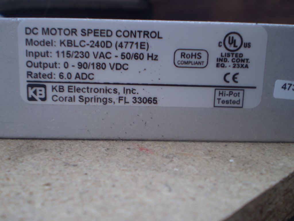

                          If you google the model number thats on the motor KBLC-240D you will find a lot of information about it, I suspect that the board is from a mini lathe, if so which one? Best regards Pat

                            Just found on Amadeal's site new boards at £85.00 if all else fails, regards Pat

                              KB controls are scr based, not MOSFET. On mine when it recently stalled, the fuse blew. Are you sure it isn't just a fuse?

                                Just to add, the scr's used are 'isolated tab' take this inot account if you need to change them……….
                                Which in my experience is unusual for them to blow (as long as the fuses are not changed for incorrect values) and I've repaired many of these boards…

                                  You were correct they are SCRs ,but still causing problems .All this only happened because the speed sensor was diconected and reconnected ( power off &nbsp As soon as it was powered up it blew the fuse and this is where I've ended up. Will check to see the replacements are isolated and see how we go.
