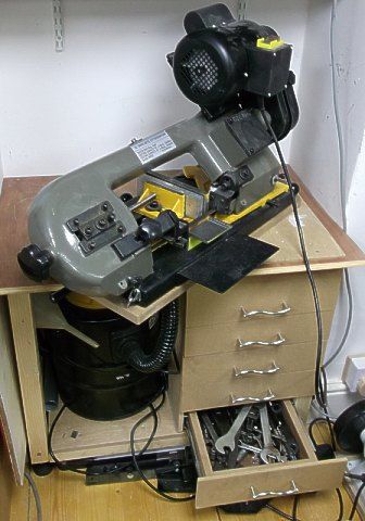

                              Alone day mine is going to get treated to a couple of IKEA Helmer drawer units and the flimsy legs will get thrown. I'm always fighting for space and all that fresh air under the saw is just a waste.

                                It is surprising how much little fillets in the bottom of the legs stiffen them up. The original bases are just folded over and not attached to the other side of the angle.

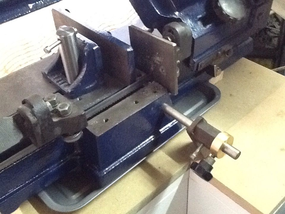

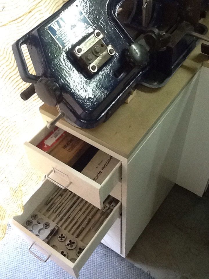

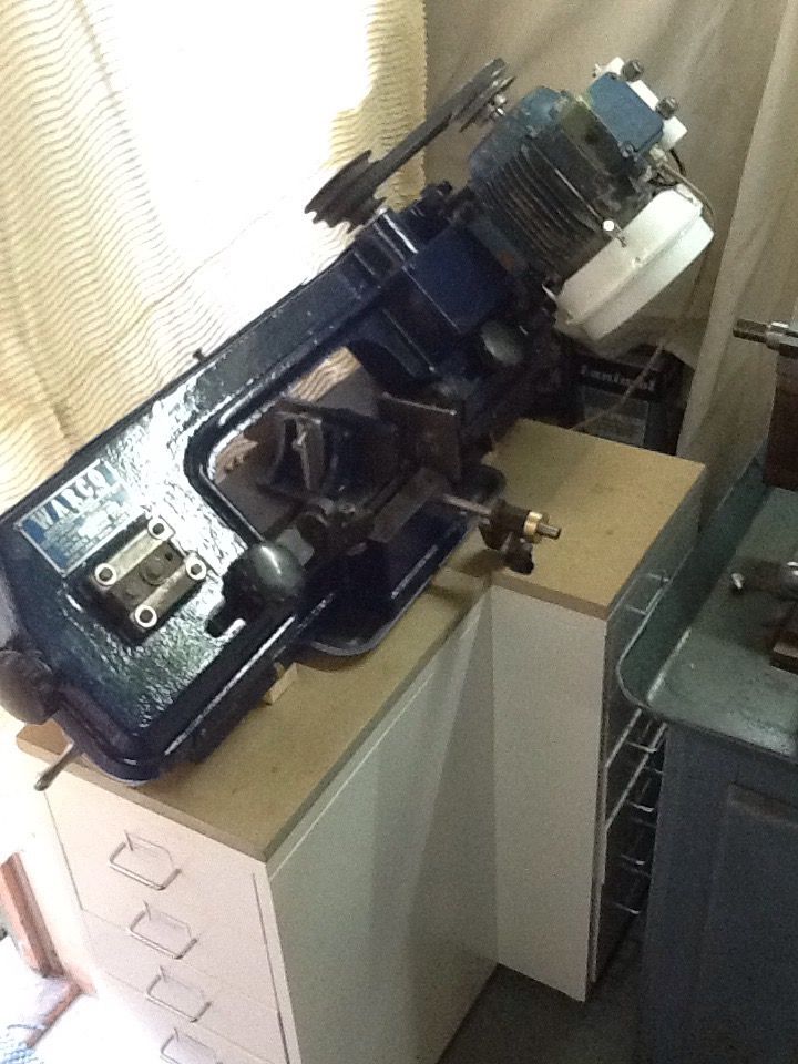

                                    Finally got rid of the useless bent steel legs and replaced with something more useful. The units are the Helmer drawers from Ikea, £25 each, pop-rivetted together with a bit of 18mm mdf screwed to the top. It needs a smooth floor for the supplied castors to run on as they are very small (and as the units are at right angles to each other the castors on the rear unit have to be screwed on at 90deg to the normal position). At last somewhere sensible to store a few bits and pieces.
                                    Some of the mods, following the links given earlier in this thread – a decent clamp for the vice jaw, extra tapped holes in the bed for strap clamps, cheap baking tray to catch the swarf and a moveable stop for repeat cutting:

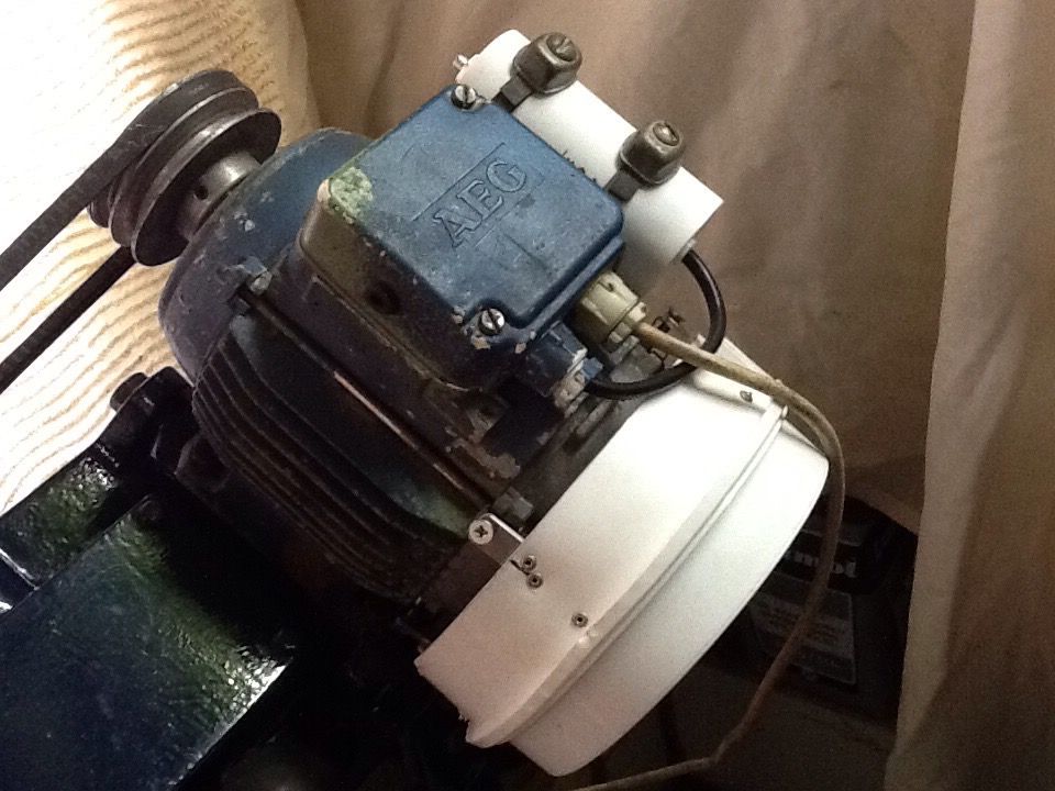

                                    The motor fitted when I bought it was this 3 phase AEG, but it came without a fan and cowl (evidence of it falling over backwards in the past I suspect!), along with a duff capacitor. Made a new cowl from a plastic paint kettle and fitted a fan from an old washing machine motor. New capacitor was from eBay.
