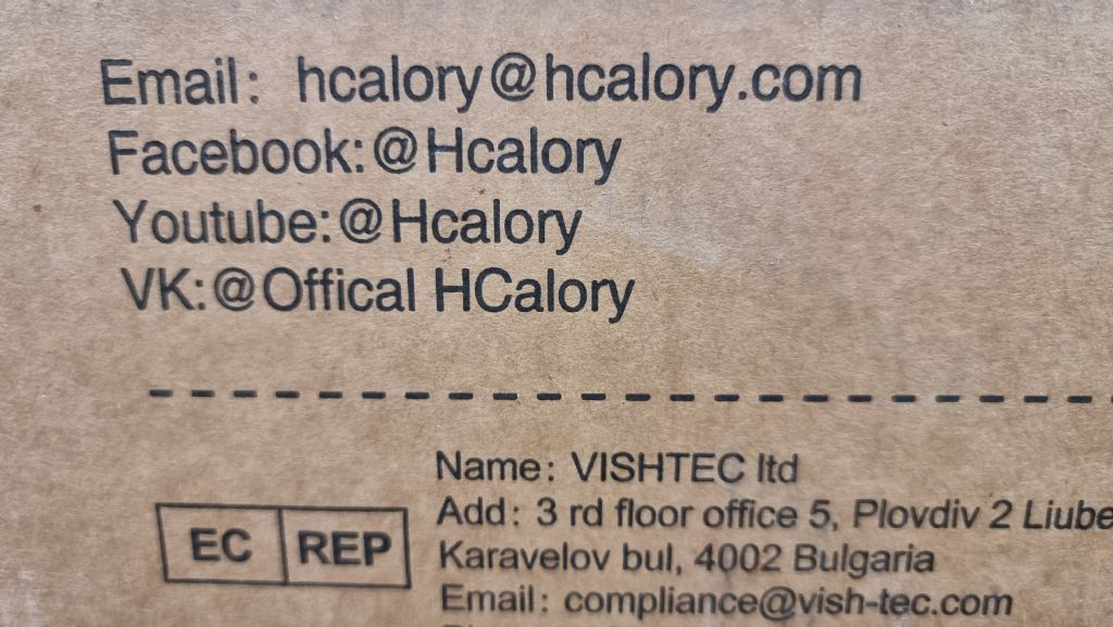

                                        Steve, Does you unit you bought have any approval or certification marks?
                                        Robert G8RPI.

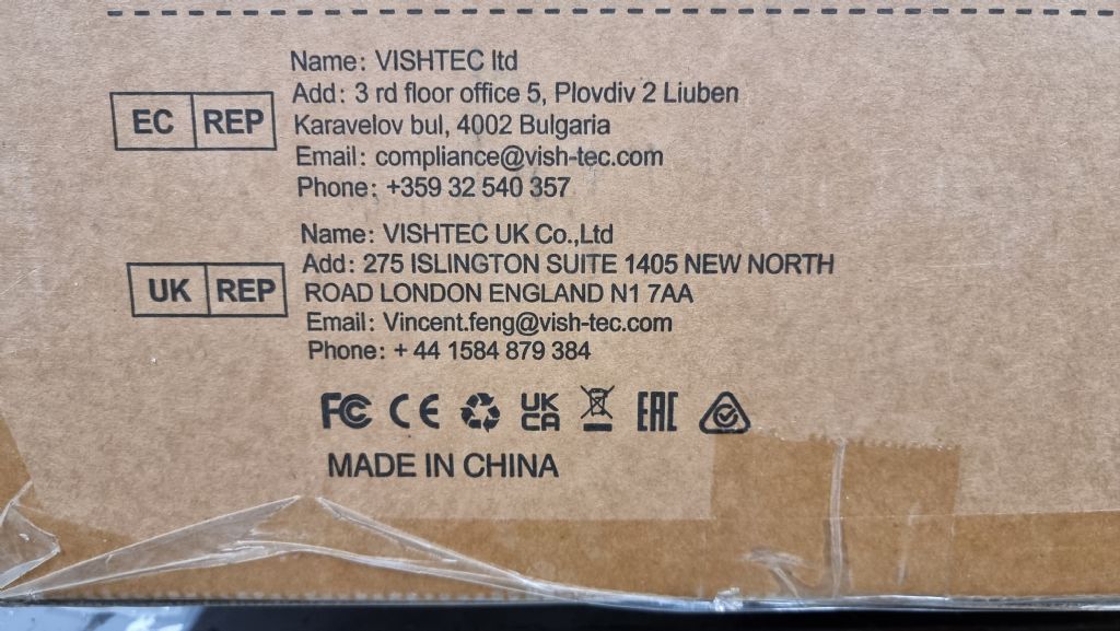

                                              Posted by Steviegtr on 02/01/2023 21:55:26:
                                              Posted by Robert Atkinson 2 on 02/01/2023 21:28:41
                                              Robert G8RPI.
                                              This is the bit I find interesting/amusing.
                                              Steve's package shows a CE mark, which at face value is a valid one, and not "China Export"
                                              Unfortunately we don't know if it's actually valid, or a misrepresentation, deliberate or accidental
                                              The difference is explained HERE
                                              http://www.ce-marking.org/what-is-ce-marking.html
                                              The IIMS, as mentioned in a post above, explain what would be a valid mark, and then show the wrong one.
                                              https://www.iims.org.uk/uk-to-accept-ce-certified-products-with-recreational-craft-directive-until-end-of-2021/
                                              Bill

                                                  Robert Atkinson 2
                                                    @robertatkinson2
                                                    Posted by peak4 on 03/01/2023 02:39:44:
                                                    Robert G8RPI.
                                                    Bill
                                                    The CE mark is actually invalid. It is very subtle but the center bar of the E is too short and the C is too narrow. Also it should have had a energy rating label. We know any energy rating given will be false as the power rating and fuel consumption don't add up.
