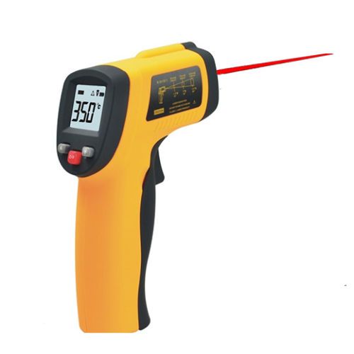

                      Paul Lousick
                        @paullousick59116
                        Get a laser thermometer. Cost from $10 – $30. I bought one which measures temperature up to 550 deg C. Just aim at the target and read the temperature. No wires required.
                        Paul.

                              I agree with Paul above.
                              **LINK**
                              £14.99 from Maplin.
                              #278945
