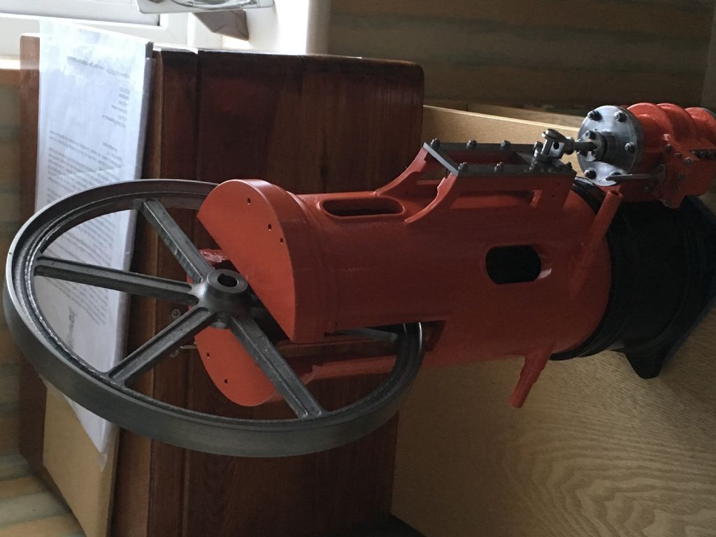

                                Usually find the edges of castings are pot hard after doing a lot of work on them, not wanting to heat up thin flywheels as John says, I find that mounting the Dremel in the vertical slide usually gets a good finish on them.
                                Slow but faster than returning the casting and finding the same problem with the new one.
                                Not usually enough metal to get under the skin of the castings I seem to buy.
                                #331017
                                Ian Hewson
                                  @ianhewson99641
                                  53082d0a-6f3c-418c-8776-66fbd891279a.jpegSkin around the edge was pot hard, dremel fixed it. Pic won’t seem to respond to repositioning though, right way when taken.
