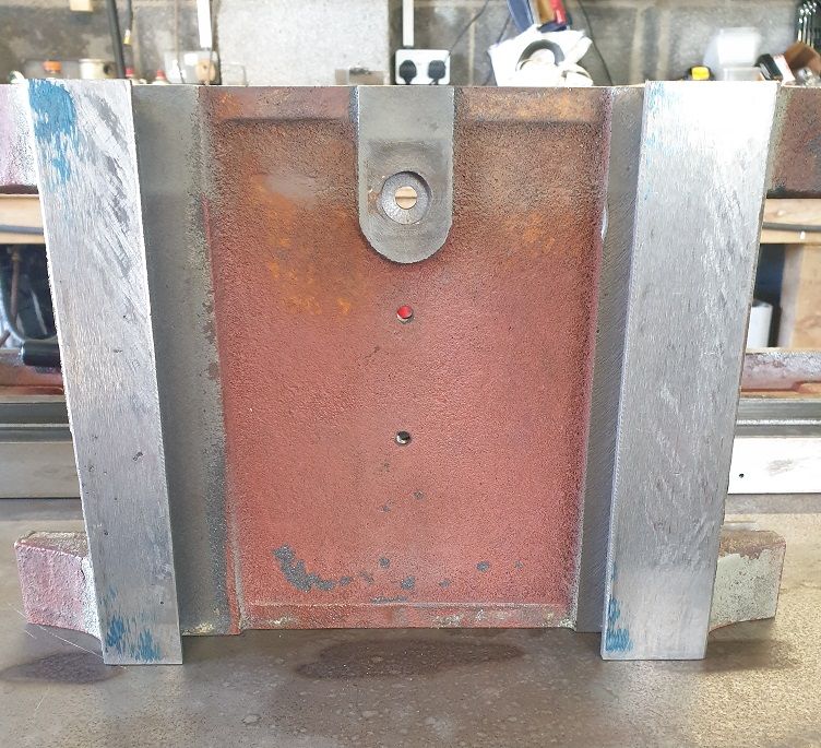

                  Managed couple of hours yesterday before heading up the road to partake in the consumption of a few wet ones..

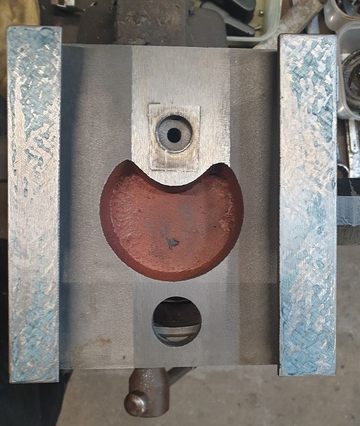

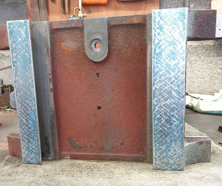

                  So this scraping lark.. please be gentle, it's the first time I've ever had a go at it.
                  Wasn't expecting much but thought I could at least have a go at making the vertical saddle ways flat so I can then fix it to the lathe face plate once that is trued and re turn the head mounting face..
                  Had to do a few passes before there was anything to photograph, there was only a wee spot of blue on 3 corner tips!
                  Might still have a fettle but considering how it was I'm pretty chuffed with that.. but, would welcome any constructive criticism..thumbs upbeer

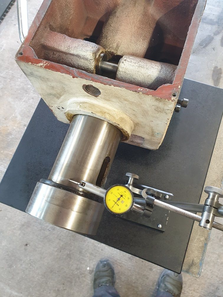

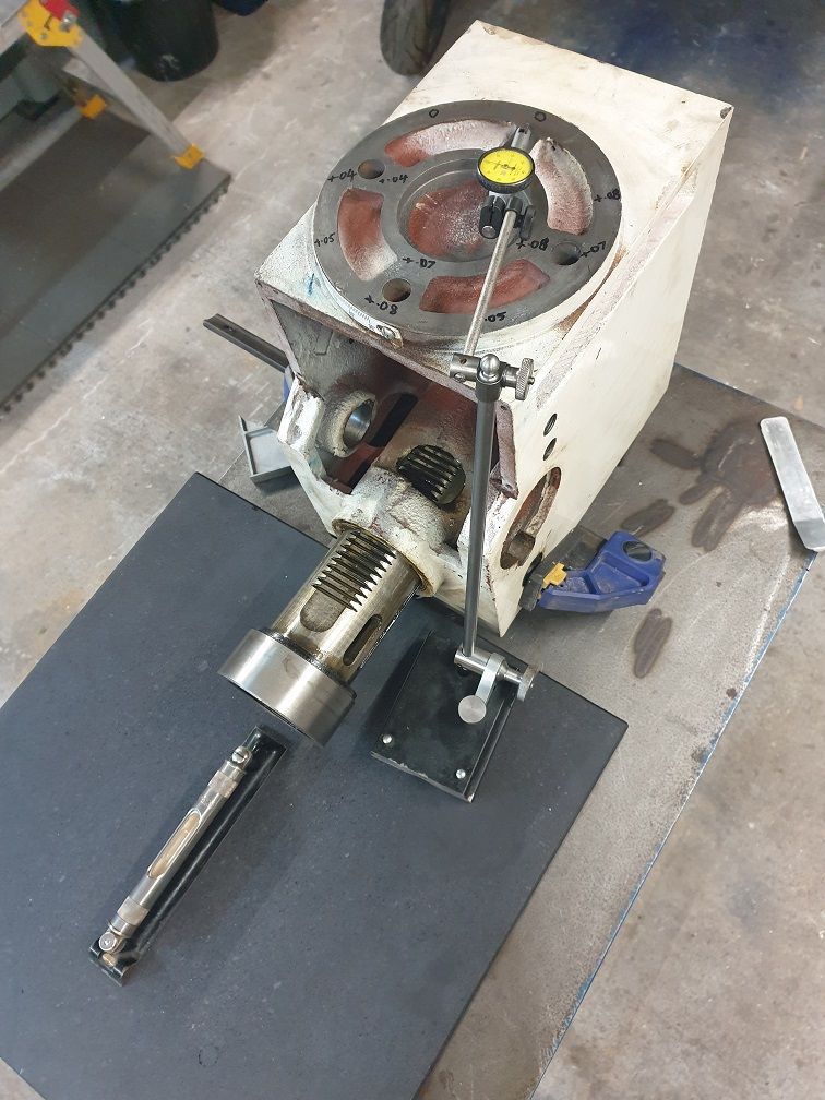

                    So that took up half of today too so then started on a full on Heath Robinson gaff up to see if I could actually measure and more importantly do anything about the head face..
                    Surface plate on table, head next to it and after much arsing about and lots of shimming I got them 'co planer' close enough with a machinist's level. then set about indicating off the partly extended quill and with another bucket load of shimming and faffing the surface plate was co planer with the quill (the pic should explain better!).
                    Then set about measuring the face. no real way of machining that so back to some scraping, lots of use of a new small single cut file, and wet n dry wrapped round a new (and remarkably flat!) Norton stone.. along with stoning too.
                    All that in between constantly re checking the alignment to make sure I hadn't moved anything and it is now within 0.02 all over. I appreciate the level of inaccuracy having such extended arms etc but it's the best i can do with what I've got. All the measurements are repeatable so cant be that far off!
                    Hopefully tomorrow will have it dressed and a decent surface on it ready to mount everything back together so I can check the column and work out a plan for that..frown

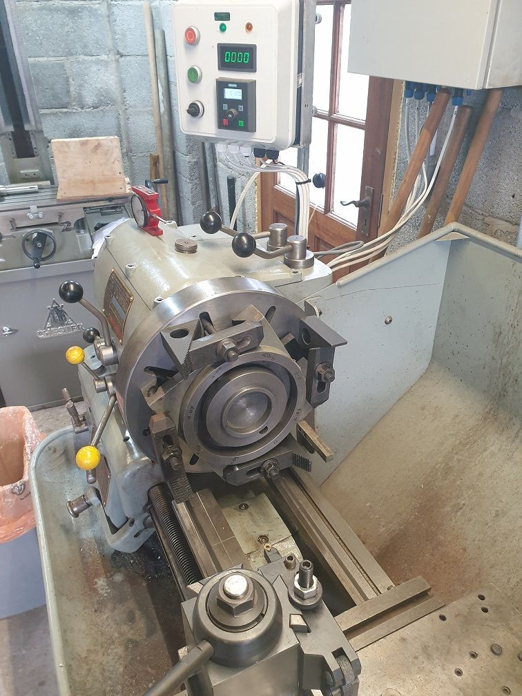

                      Bit more success today, having got the face true to the quill in the vertical as close as I could get with the oddly functional measuring set up it was time to get it on the face plate and get it flat enough to have a decent contact area.
                      To my utter surprise it actually worked! No, I didn't mess with the indicator between measurements..!
                      So on to dressing it proper flat for a decent contact face..
                      After lots of faffing about, I recon this will do. I'm going to leave a very slight relief around the bolt holes to allow for a bit of squish. The light is hiding some of the blue, it was a very thin print so hard to get the colour.
                      Next bit of free time will be to dress my lathe face plate bob on then mount the vertical saddle to that and re cut the head face seat. Need to order some more brazing rods to build up the boss so I can turn that to suit the head recess so it has an accurate mount.
                      Hopefully once I've got all this as accurate as I can, when reassembled I can get a true measurement of what error there is in the column.
                      I think I'll then do as Pete suggested as first preference of taking the base to a firm to get the column seat face milled true, it not then John's suggestion of the resin sounds pretty good to me.
                      She'll get there! Food and Pint now..smileybeer

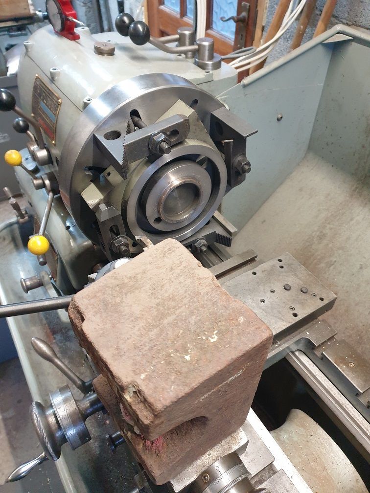

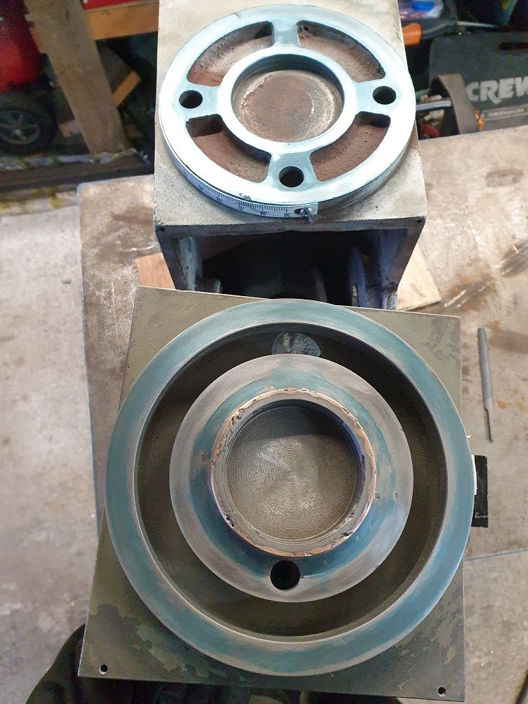

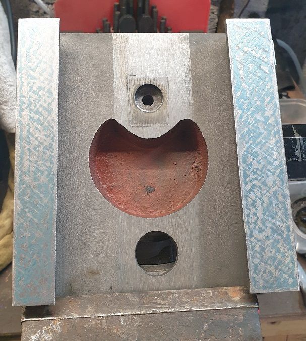

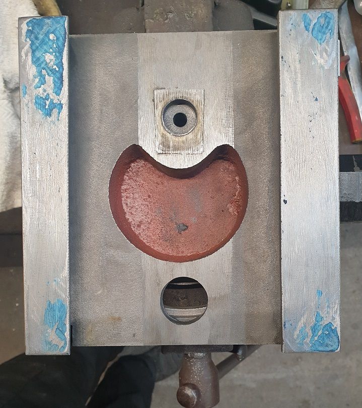

                                      So I believe the 3 golden rules of tig welding are – get comfortable, get comfortable and make sure your comfortable…
                                      Oh dear.. so leaning over the lathe having chucked up the vertical saddle on the face plate after giving it a wee skim to true it up so I could try to braze (I emphasize try as never tried tig brazing before!) the locating boss in the centre and what ever was digging in my ribs suddenly let go as I tried to adjust my view point.
                                      It was the toolpost locking lever.. not the most inconspicuous of things I know but there we are.. so with foot still on peddle (now at full beans as I was sliding over the top of the lathe) I managed to do a lovely job of dragging a 90amp arc right around the inner ring on the face.angry good job I had only set the thing to 90A, god knows what 200A would have done!
                                      Even dafter, while putting the last of the braze around the thing I coughed and added another couple of spots!
                                      And we all know what happens to cast iron when that happens. To quote a certain enjoyable youtuber loads of small spots that were harder than 'woodpecker lips'! I think the sticker he has on the front of his CNC machine is meant for me.crying
                                      After much careful spotting with a die grinder to try and recess all the tiny stupidly hard spots the face turned quite nicely, even if there are now a load of small shy spots.
                                      I also dressed the inner seats for the T bolts as the standard bolts have chewed the seats so very difficult to finely adjust the head rotation.
                                      The insert holder I had that would take my smallest inserts in order to take very fine cuts is only a 12mm stock so being stuck out far enough to clear all the mounting hardware and the compound being fairly well advanced to get in there quickly showed as one hell of a chatter squeal. Raided next doors garden and found a 25lb cast iron weight which when sat on the compound on 2 small slivers of wood worked a dream! smooth as anything so if your wondering what the hell that thing is in the photo ..
                                      All came good in the end, last pic is the almost finished face print. forgot to take a photo of the final one with a very light blueing but it was more than good enough..
                                      beer

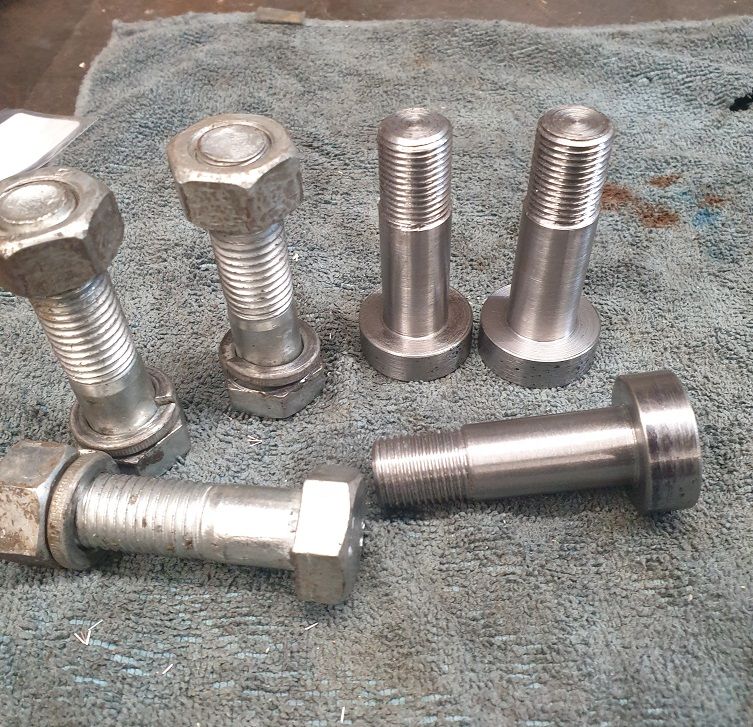

                                        Didn't get a great deal done today, stripped, de burred, cleaned and re assembled the gearbox shafts ready for re assembly.. it was pretty manky to say the least but all good now and made some new T-Bolts for mounting the head.
                                        Turned out OK, nice snug fit through the head face (17mm) reduced to M16 x 1.5 thread so don't need to be horsing up on them – single pointed and just ran a die down to tidy up, was a fairly hard piece of bar stock I found on the shelf, not sure what but she'll do!
                                        A much better contact area for the saddle too, just need to add the flats.
                                        Every bit done is a bit closer I suppose!
                                        The old ones were pretty crap..

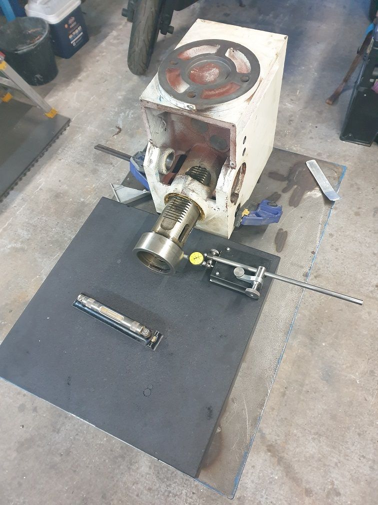

                                          When I dismantled the head, I was surprised at how poorly the gears meshed, by that I mean vertical alignment, and the fact that there was no 'neutral' position so it would be possible to freely rotate the spindle.
                                          Anyway, after an awful lot of shim making, changing the thickness of bearing spacer rings, messing with the shafts etc etc and what seemed like builds and disassembling of the shafts into the head cover using the old bearings I have all shafts turning with fully meshed gears in all positions. thought I'd never get there..!
                                          And even better, the 3 position selector has a fairly large space when between 2 positions so that shaft now has a small detent so it will hold in a neutral position well clear of the other gears (I cant remember if it is between Low and High or High and Med, it's all been upside down!).
                                          All boxed up and spinning lovely & smooth.. the old chinesium bearings were proper rough and sloppy.. ah well, they all add to the scrap weight!
                                          Spindle build next.. then bolt the head to the saddle and lay it on the surface plate to re check the alignment with the quill properly assembled.
                                          Fingers crossed!

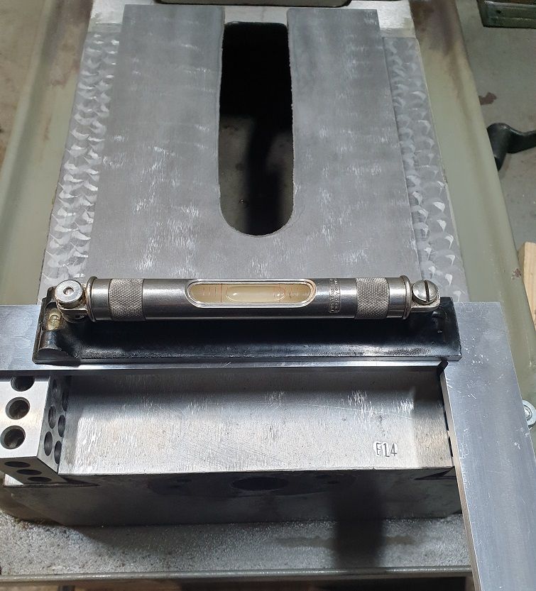

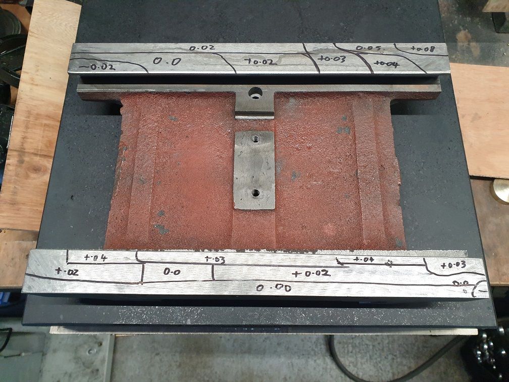

                                                So managed a few more hours today.. now the gearhead is mostly reassembled – leaving spindle build etc till I've cleaned up a bit cos even Steptoe would be ashamed of the place at the mo!

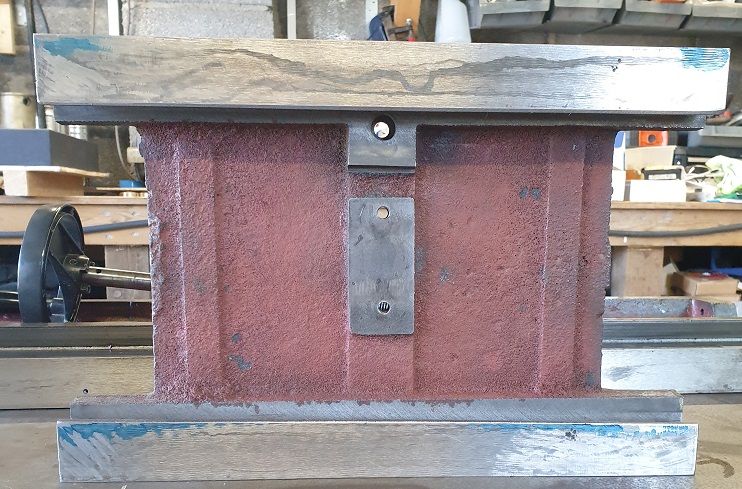

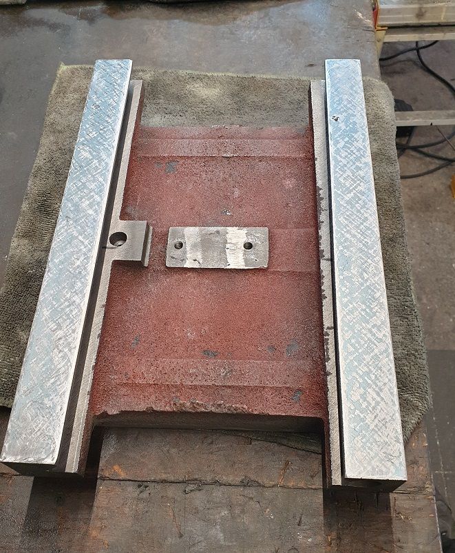

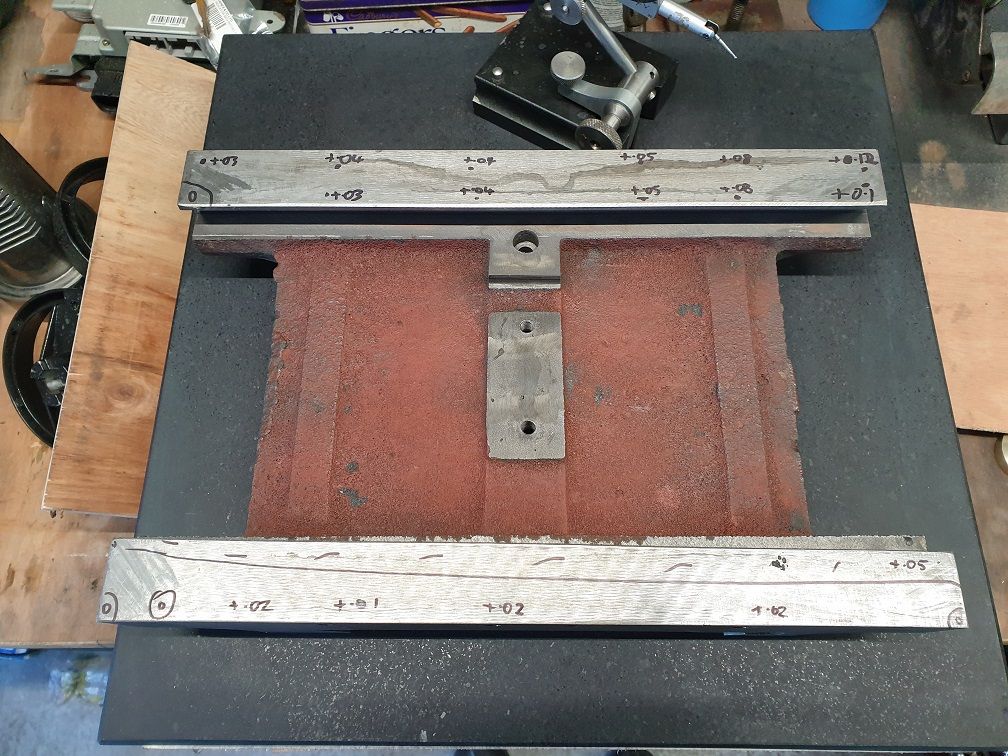

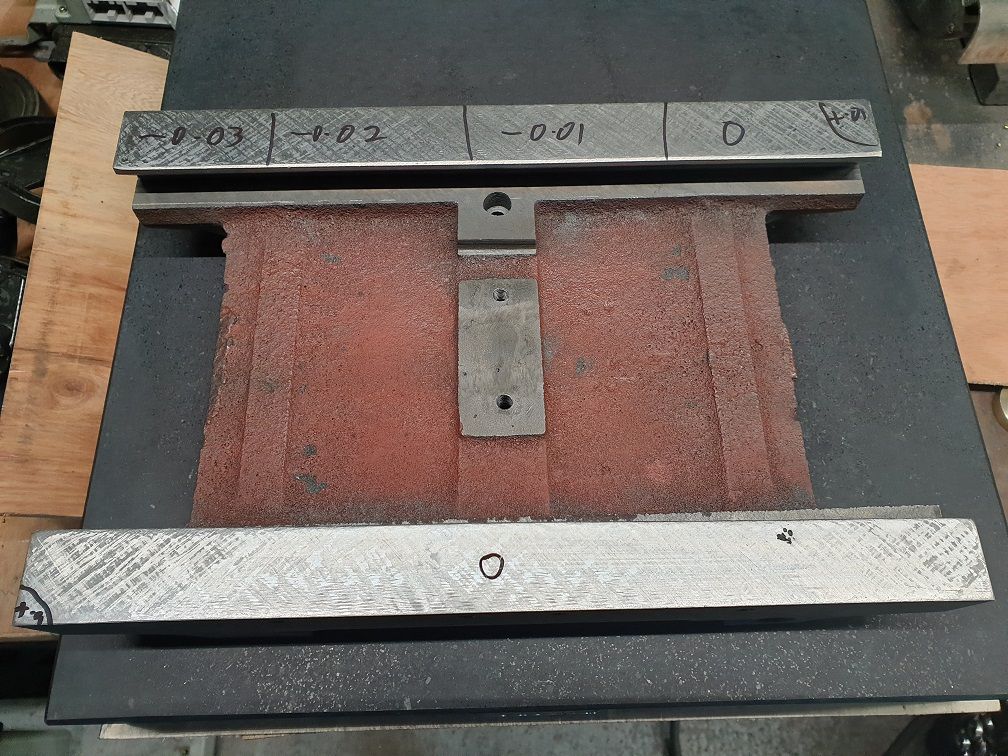

                                                Stripped the X Y Saddle and after a bit of cleaning started to get an idea of how it was.. be ways on the Base appear to have very little ware on them but then I don't have a straight edge / camel back to check (And can not afford one!) but the raised surface between them seems to be a ground (coarsely) surface so I presume that is the reference surface for hen they build the thing and will use that to depth mic the ways as best I can to check.
                                                Did an initial print of the saddle as below.. not the best!
                                                xy_saddle_y_print_1.jpgThe Y ways..
                                                xy_saddle_x_print_1.jpg The X Ways..
                                                So I set to the Y ways. I tried to take as finer scrapes as possible as didn't want to remove any more metal than absolutely necessary thinking that the oil pockets are best on the lower ways so not too fussed about the pattern, just want it flat.
                                                Am I right in this thinking? Or should I be taking some deeper scrapes and making more effort on the pattern and spots per inch?
                                                Anyway, this is nearly done –
                                                Lighting makes it look far more patchy than it is and its a bit heavy.. leaving it like that till I sort the below stuff.
                                                I then set about taking some measurements to the X ways and the high area coincides with the initial Y ways print that was heavyest so need to do some more thinking and measuring to see if i need to try to step scrape the X Ways into co planer with the Y or take some more off the Y Ways to bring the high side of the X down a bit..
                                                Any thoughts?
                                                I suppose any error I get here could be taken out with the column adjustment though – not that that is the right way to do it I suppose!
                                                Which ever way I go, I presume the X ways will need an attempt to scrape properly with decent oil pockets being upward facing ?
                                                1 bonus though, I found an old Eclipse hand scraper so my modified file is fairly redundant!
                                                Foot and a pint now though..laugh

                                                  Evenin' all!
                                                  Got through a bit more, got the X Y Saddle finished.. after checking as best I could from the machined faces on the saddle, I decided to drop 1 of the y faces a round or 2 of scrapes and then have anther check which gave the results below.. much better so set too on the X faces..
                                                  After a fair few rounds got it to this..
                                                  And after a few more rounds of tweeking got the whole thing to 0 with a couple of spots that were -0.01 ..
                                                  All this of course is subject to the accuracy of the new surface plate. A Dasqua 450mm x 450mm x 80mm and according to them its a grade 00 .. Chronos were selling them recently for only £150 something. A grade 00 plate for that.. me thinks not but so far I can not complain, I can not measure any variation anywhere on it!
                                                  I ran a half thou indicator all over it on a 3" extension from the surface gauge base and the indicator barely twitched let alone move!
                                                  There are 2 tiny (match head sized) chips right in 1 of the corners so maybe thats the reason for the price but they affect nothing.
                                                  The print..
                                                  Again, lighting is hiding almost all of it.. David Bailey I'm not.. but it's pretty much there.
                                                  Once I was happy I set to it as heavy as I could to scrape some oil pockets into the surface's and called it done.
                                                  Forgot the final photo but naff all difference really.

                                                    So next I set about trying to check the Table itself.
                                                    After much cleaning and stoning I placed it top down on the surface plate. Yes, it's far too long with a fair bit of over hang so crap for taking any measurements. I ended up placing weights in the centre in an attempt to counter the over hang and with only about 14lbs of weight the indicator readings on the ways became perfectly repeatable even when moving the table slightly left & right so with that being the best I was able to achieve it would have to do.
                                                    Both sides were out over their width, very slight slope of about 0.05mm although from centre out towards the ends was spot on along the rear way and the front way was good 1 way but tapered down to 0.05 low about 10 inches out the other.
                                                    After many .. many finger aching hours of scratching and stoning both sides are within 0.02 which considering the probable inaccuracy in measuring is way better than I could hope for.. leave it alone now!
                                                    Again, forgot the pic.. was so excited that repeated set ups gave consistent readings!
                                                    The Base ways.. cue a proper Heath Robinson set up but best I could come up with with what I had.
                                                    I used what appeared to be the ground face between the ways as I presume that is the reference surface for when they build the thing.
                                                    Put a machinist's level (as far as I can check it's a thou / foot, a J Rabone & Son's but no rating on it) on the freshly stoned surface and centred it with bubble just touching line on left.
                                                    Then a pair of 123 blocks on each way and a so called precision square between (it was fairly cheap, not bad at all though) and the level on top. Moved along to 5 different positions down the ways with level and square positioned in same way on blocks each move.
                                                    Worst position was the 1 above, 1 division out . Here we go with the scratching and stoning again..
                                                    Managed to get it so the rear half is bob on and just less than half a division on the level out at the front.
                                                    All things considered I think that will be good enough but I may have another attempt at because I know it's not quite there..blush
                                                    Think I deserve a pint now although I'll probably drop the bugger the fingers are aching so much!
