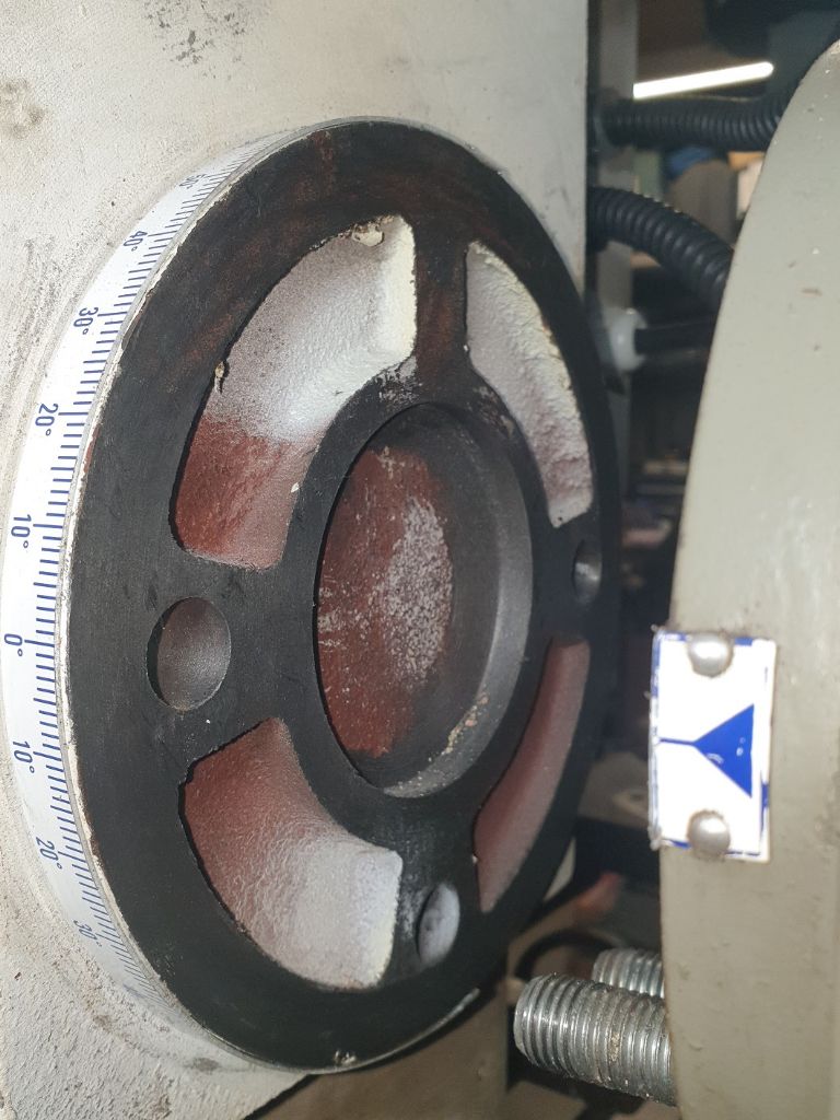

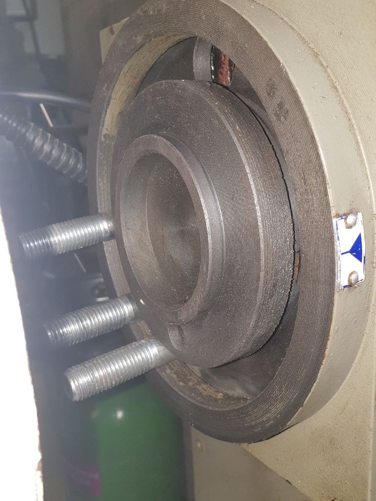

                                          Knocked up a wooden frame and removed the head. You can clearly see that the lack of contact around the top third ish on both faces. I was a bit surprised that the head inner locating recess isn't a machined surface. I was expecting T bolts in the Z saddle but they are regular bolts. What I though felt like a small detent where the 0 angle was is just where the bolts have been tightened and marked the casting – no wonder adjusting was problematic.
                                          On a side note, I contacted Chester to get an idea of a couple of costings.. shouldn't have bothered. The price of the gib (part numbered on all the other branded versions of this I've seen)?.. don't know, don't do them. Does the newer spindle that is R8 rather than MT3 fit this mill ?.. don't know .. how much is it anyway? don't know.. probably a few hundred quid. Ah well..
                                          Pics of the faces..

                                              Well, I believe the first stage of success in fixing something is finding what's wrong.. Had some success!
                                              Just had another hour or so fiddling and after an inordinate amount of blue I got a print onto the saddle form the head face. Not sure I really needed to as with the head horizontal and the saddle placed on the face, it could rock top to bottom.. non the less I blued.. then blued again and eventually got enough of a print to see what's what.
                                              I really don't know how I'm going to measure what is out and by how far but using the best straight edge I have the deformation seems to only be in the head face.. disappointed in that as if it were the saddle I could take it to a place that would surface grind it flat. How I reference the flatness of the head face in relation to the quill is going to be interesting..
                                              And the gib has a 2 thou bow in it..
                                              Oh well.. best I try and wake the wee grey bits up top and see what I can come up with.

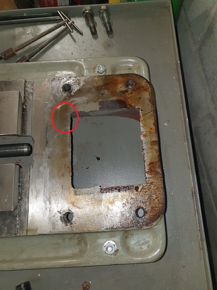

                                              #620423
                                              Taf_Pembs
                                                @taf_pembs
                                                Evenin all..

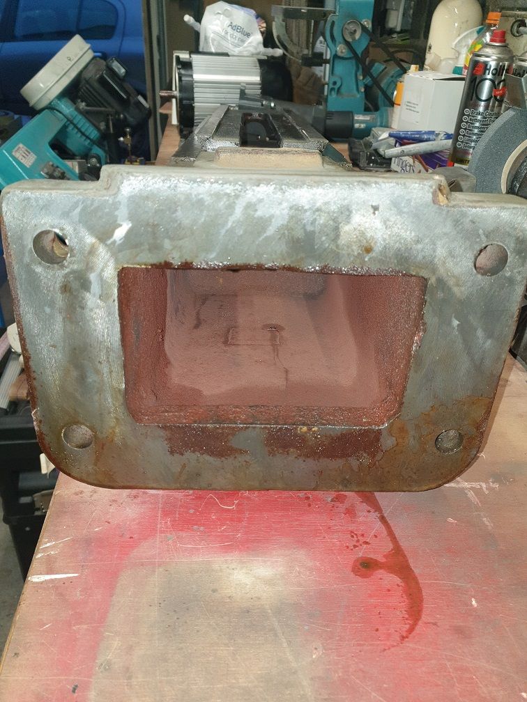

                                                Had a bit of fiddling time. Column removed, not what I was expecting, either really badly made or deliberate.. Maybe someone could shed some light on this one?
                                                The machine base column mounting surface is partly flat then tapers off towards the back, by a significant amount.
                                                My thinking is either as said, vert badly made of deliberate so column angle can be adjusted forwards / backwards?
                                                There was also a really thick chunk of red paint stuck under the front towards the left (circled in photo).
                                                Either way, you can clearly see where there was some contact but not much.

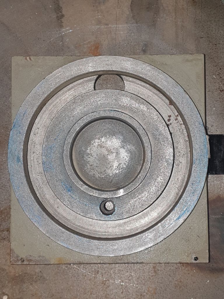

                                                  Had a quick look at the column saddle on the surface plate, aprox 0.2mm of rock across 2 corners, nothing that cant be sorted I suppose and the face is about 0.1 fatter side to side but I will go back to this once I've got rid of the 'wobble' in the way faces.
                                                  At least it is reasonably parallel for a budget machine!

                                                  #620428
                                                  Taf_Pembs
                                                    @taf_pembs

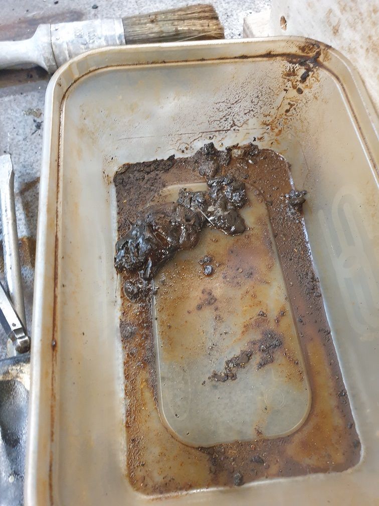

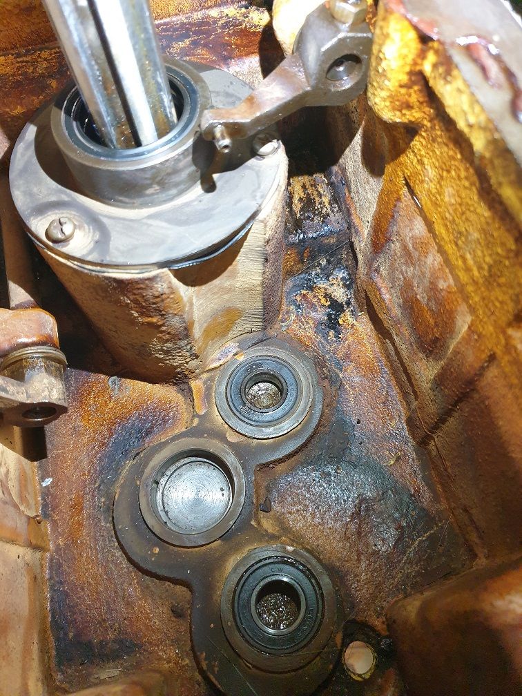

                                                    Oh.. decided to clean out the head (and make it lighter to lump around!).
                                                    Glad I did, there was some serious gunge in there. Almost like the sealer they used on the head top plate (resembles Hermatite Red) had also been liberally applied to the inside of the head for fun..
                                                    Oh well, it's only cleaning..indecision just a lot of it to get this stuff out, it certainly takes some dissolving!
                                                    She may as well have a set of bearings while I'm in there, they are the usual unbranded chinesium items and aren't the tightest or smoothest .. might make her a bit smoother running.
                                                    the gears look in pretty good shape, no real burrs, chips, wear etc.. all good.
