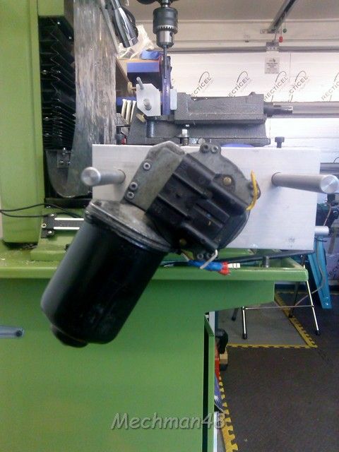

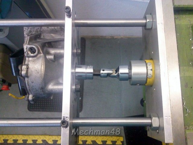

              "I had also posted a question on this forum asking if any members had any suggestions as to either a source or any other means of driving the x axis but to date there has been no response.''….
              …. How about trying a either of… 12 / 24 volt window wiper / winder motor, via appropriate transformer + DPDT switch… I have fitted a 12v wiper motor to my WM 16 x axis drive, used surplus u/v joint & sockets from spare socket set …

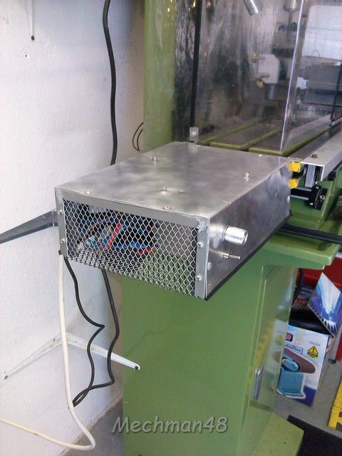

                    Hi George (Mechman48)
                    Your reply is exactly that I have looking for and I believe that for me this is the way to go.
                    Could you perhaps just advise how you sorted out the variable speed for the wiper motor.
                    Best regards,
                    Mike

                        #178674
                        Robbo
                          @robbo
                          Mike,
                          Ready made variable speed electronics are readily available on ebay, in various capacities including 12 volt.   Search for "motor speed controller".
                          You can build your own but if, like me, you are an electronic ignoramus, this is a godsend.
                          I bought a fully enclosed version, which will handle up to 15 amps – real overkill for the fan which it is currently (excuse the pun) controlling, but it may be required for more testing duties in the future, and it is excellent.
