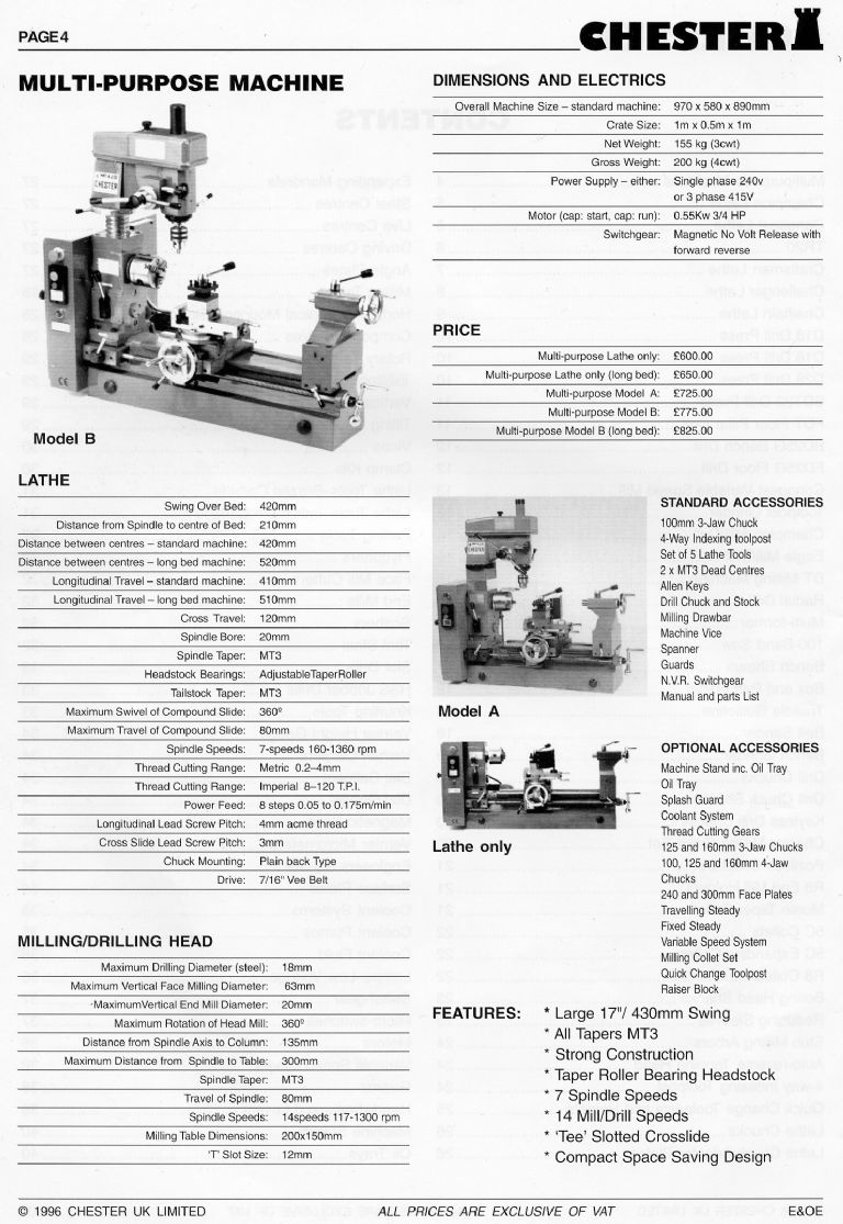

                Hi James, I take it this is the machine you have.
                The blocks you refer to are just keys and are not a necessity and as Clog says, use a dial gauge to set your vice square, nip it down lightly and tap it square with the dial gauge on the fixed jaw of the vice and then fully tighten it down.
                Regards Nick.
                P.S. use a mallet/hammer to tap the vice square, not the dial gauge. angel

                                Nick Farr yes thats it.
