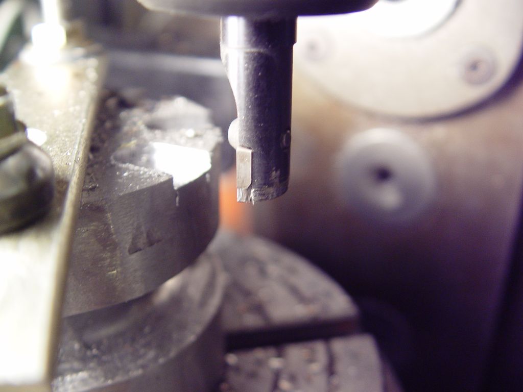

                                                  Dave Halford
                                                    @davehalford22513
                                                    Posted by JasonB on 27/07/2023 06:51:16:
                                                    Have you never turned any square or hex material Dave? I don't find it a problem with cabide and have also used a turning tool in a flycutter with no problem.
                                                    Nope, but I have used them unknowingly for milling, you get the below effect on En3 after a couple of slots. Insert supplied with the holder both alledged to be Seco.
                                                    I have since used a proper milling insert in the same cutter to widen a lantern tool post which still looks like new.

                                                      Like Dave Halford, I find that brazed carbides seem to chip very easily (More easily than inserted carbide tips, and are very difficult to hold to sharpen with a diamond wheel ) so avoid them wherever possible.
