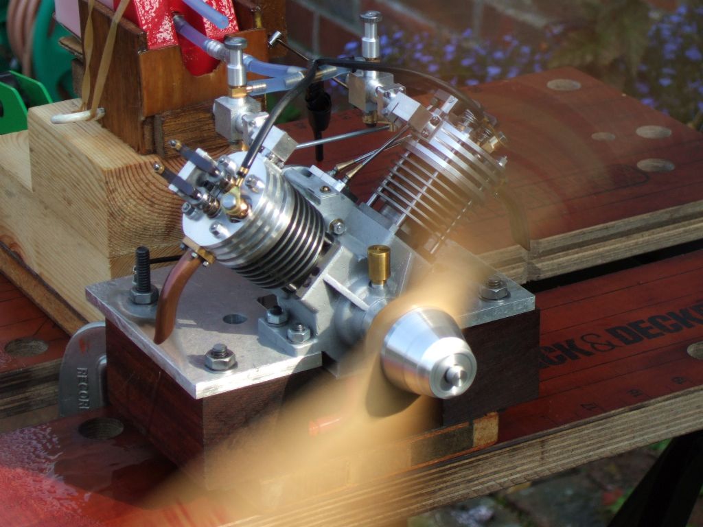

        I'm sure that the cooling effect of the oil, being more effective one side, is a factor. I wonder if another might be the uneven timing of the suck strokes resulting in two different mixture strengths. A look at the plugs after a good run would be revealing – I bet the cooler head has a blacker plug. It could also be that one cylinder ignition is timed later than it should be – a further good reason for overheating.
        Cheers, Tim
        #336846
          I had an e-mail from another member who said the same thing Tim , the uneven induction gaps between the two cylinders caused problems when running on a single carb, when changed to two carbs it came to life.

                    I had no problem with uneven running, once I had increased the compression to work on glow plugs. I did not make the Chenery designed manifold and made a tee shaped one . I tried various carbs trying to get max revs together with a decent slow running, with good transition between, but ended up with the original single one that I had in my bits, not the Chenery design.The trick was to get the size of the inlet correct and I made several before I was satisfied. . I did not have pressure lubrication, just 5cc of oil in the crankcase and drained after each running session.The breather was replaced from its drawn position,as it made a mess over the crankcase, I replaced this with a plain 3mmm pipe in the rear face ,which allows oil fume to pass over the camshaft. If you use sparks you might not be able to do this.
                    Keith.

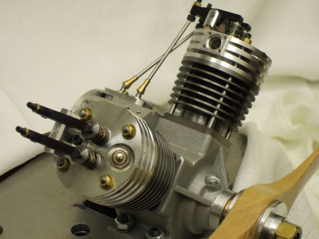

                      Graham Meek
                        @grahammeek88282
                        The above engine was owned by Dr John Beddard. You will see it has been modified quite a bit from the original design. Most of the modifications can be attributed to me and include cast iron cylinders , re-designed cylinder heads and valve gear.
                        The engine was originally run using a single carburettor, but it ran very un-evenly. This was put down to the induction periods of the 90 degree lay-out. Converting to a twin carburettor set up made this engine more docile and a joy to run.
                        Regards
                        Gray,
