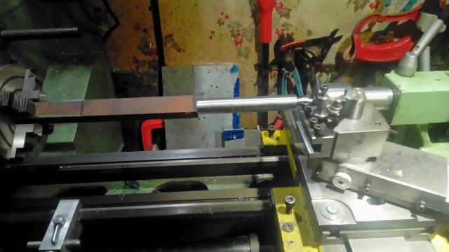

                    Is the 500mm sticking out of the chuck to be worked on? If so, who is going to machine it without a steady and/or live centre? If it isn’t and the required part is short, why would you waste time and a chunk of the material cutting it off a long length before working on it? 35mm isn’t a large or rare size for me.
                    I would have been a lot happier if I could have pushed this 3/4″ square bar back into the headstock instead of having barely enough room to machine the M20 threads on each end, especially as I didn’t have any more material: TurningNewHeadbolt

                      Yes, and I can get over a metre of rod into my lathe, and spin it up to 2800rpm!   Not an unusual turning operation, for example “Oil-Country” lathes are specifically made to turn long lengths of pipe, and are more likely to work that way than not.
                      I do it to save stock, because it much reduces the need to chop metal into itty-bitty short lengths just because the headstock bore is too small.  But it’s good for axles and anything else on the long side.   The Myford’s narrow bore headstock isn’t an advantage.
                      Of course you can’t just bung long work in the chuck and hope for the best.  Being bendy makes steel rod liable to kink and whip, and a metre of rod flailing at 2800 rpm at the end of a headstock is about as dangerous as it gets!   Necessary to provide some means of controlling it – I usually pass the rod through a block of wood clamped in a Workmate and carefully aligned with the spindle.

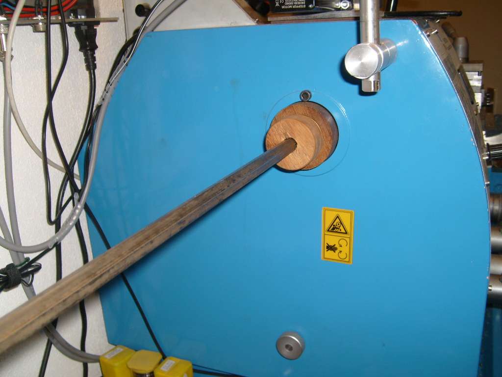

                              I do this often without a problem. At the back of the spindle I screw on an adapter to keep the part on center and relieve the spindle bearings. The max RPM depends on the resonance that will occur.
                              Below a long ( 1000 mm or so) hex shaft.S7300692.

                                The gunsmithing guys over the pond use a more precision gunsmith’s lathe spindle spider on that end of the spindle to hold rifle barrels dead true when machining the chamber etc on the other end. Very handy. Just a collar that clamps on the end of the spindle with four adjustable bolts to hold the job. Simple to make and could be left in place permanently for use with long bits of stock etc.
                                On less precision jobs, I have seen old timers stuff rags into the spindle to stop a length of bar moving around too much.

                                  I have a spindle spider installed, comes in very handy for those long parts and doesn’t get in the way of normal operation. Highly recommended.
