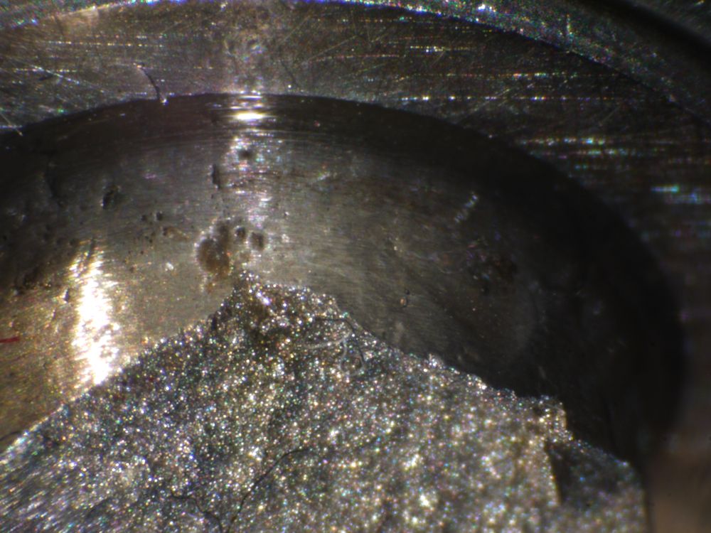

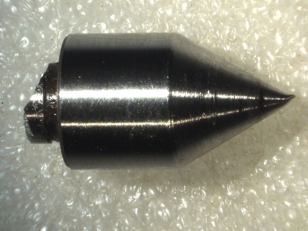

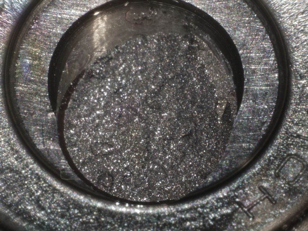

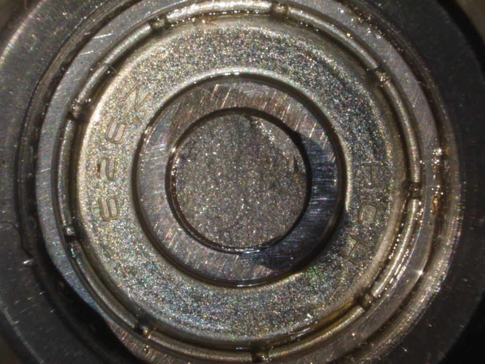

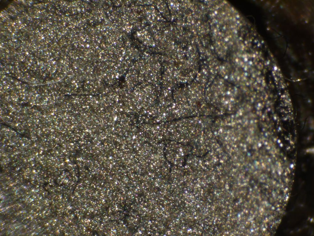

                  #172591
                    UPDATE:
                    Nick kindly sent me his broken centre, and I have taken some close-up photos of the fracture [three posted here; more in my album].
                    I think this is best categorised as a Brittle, or Chalk Stick, fracture
                    There is no visible evidence of fatigue: The failure is typical of a brittle material subjected to a high unidirectional bending load.
                    The material has a granular structure, with some surface defects and some inclusions. … i.e. It looks more like cast iron than steel.
                    The fracture clearly originates at the edge of the narrow groove, and breaks-out diametrically opposite.
                    It is worth mentioning the surprisingly small dimensions of the component parts of this SlimBody centre.
                    Although the fitting is No.2MT, the major diameter of the rotating centre is just under 10mm, and its shank is only 6mm diameter. … The front bearing is a 626Z, and I presume there is another behind it.
                    In the New Year, I plan to section and polish the broken shank, for inspection under the microscope; in the hope of better identifying the material.
                    Edited By Michael Gilligan on 14/12/2014 23:23:54

                          I would like to know how the tip got bent (see last photo) and if this had any bearing on the fracture. You would expect that if it is an over brittle material the tip would not bend like that. Maybe when it was heat treated the thinner stem cooled quicker than the larger dia working end?
                          Michael, it would also be interesting if you could test the hardness at both ends
                          J

                            Posted by JasonB on 15/12/2014 10:31:27:
                            Ditto.!
                            It certainly was not there before I started turning and the rascal broke.
                            I was taper turning at the time of breakage using the compound slide if that helps with the investigation. Even taking into consideration when doing such the cut gets deeper as you progress the cut was quite light.
                            Nick

                                  #172649
                                    Posted by John Stevenson on 15/12/2014 13:12:05:
                                    Michael,
                                    Try a quick and dirty spark test to clear up whether or not this is cast iron.
                                    O.K. … a few quick tests on the 10mm-ish body
                                    • A good needle file will just mark the surface, but not really cut
                                    • A scriber point will just produce a faint scratch
                                    • Sparks from the grindstone are quite short, but white and sparkly
                                    My preliminary conclusion is that this must therefore be a steel … despite the appearance of the fractured surface.
                                    … Expert opinions welcome !!
                                    #172655
                                    Jon Gibbs
                                      @jongibbs59756
                                      Hi Michael,
                                      If you take a look at the Metcalfe experiment conducted here **LINK** you may get a clue to what may have happened.
                                      In short I think it looks very much like a fracture of badly hardened steel.
                                      HTH

                                        #172689
                                          Jon,
                                          Thanks again for the link
                                          … I have watched the videos and learned a lot.
                                          Assuming that I have understood correctly: the shank on Nick's centre was too hot prior to quenching, and was not [sufficiently] tempered after hardening. … I suspect that the heat treatment process is 'just right' for the head of the centre, and unfortunately wrong for the much smaller cross section of its shank.
                                          Until I saw those Metcalfe results, I had no idea that steel could go so granular !
                                          I do however remain concerned/confused by the surface defects, and the [graphite?] inclusions visible in these two photos:
                                          #172690
                                            Note:
                                            There is a small white hair visible in the upper left quarter of that second photo; but I thought the black lines were graphite inclusions. [getting worried now] … Might not be certain until I section it.
