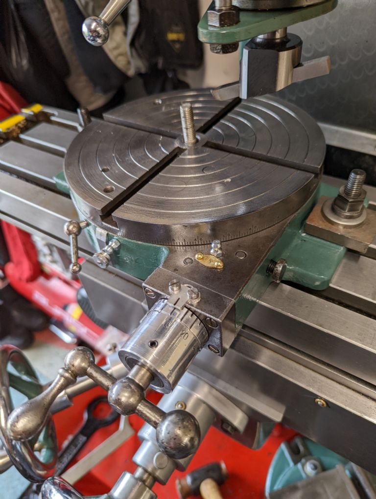

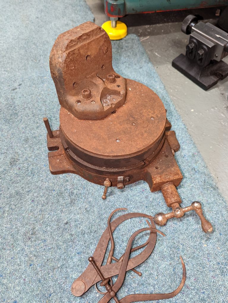

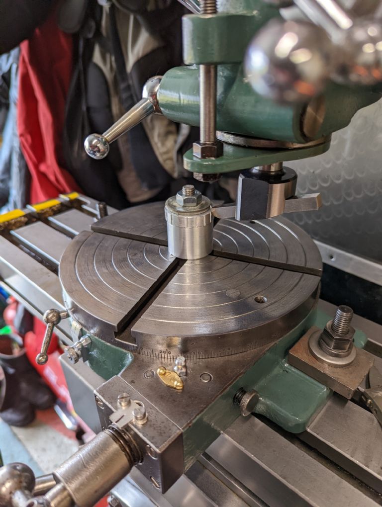

      I picked up this scrap looking rotary table cheap, a few bits missing but tuned smoothly.:

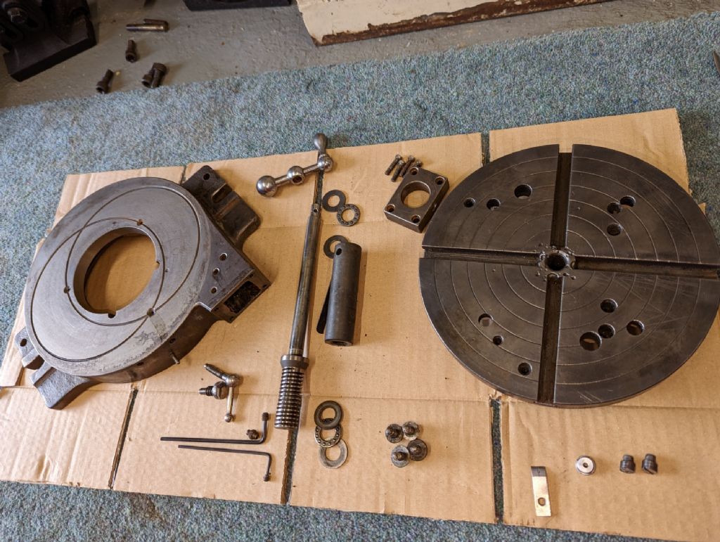

      Stripped it down and derusted in Citric Acid:

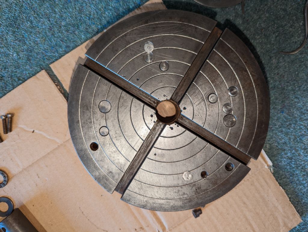

      Plugged the holes in the table:

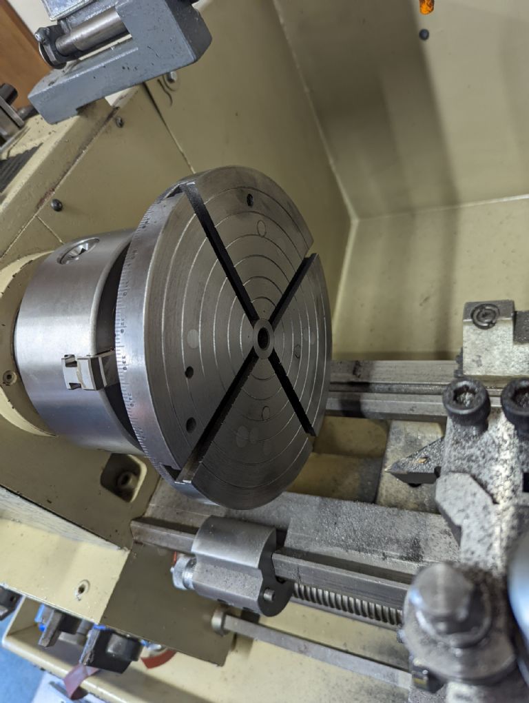

      clocked to ..0002" and skimmed on lathe:
      Had some fun figuring out how to make the sale, ended up locking the spindle on the mill and using a sharp flycutter:
      Works fine now:

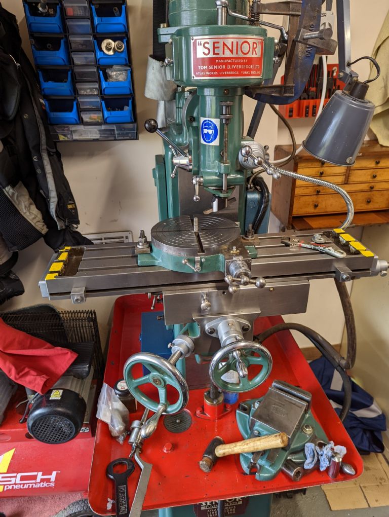

      And a bonus being a Tom Senior like my mill:
      I can get back to rebuilding motorbikes now….

          The rotary table certainly looks much better now, well done.

            Thanks, it is a nice low profile, I picked it up a week after I bought a second hand Vertex.

              It's amazing what a little careful restoration can do, I'm glad to see that you did not try to "over restore" like many people do.

                Excellent job, a useful addition to the mill. 😀
