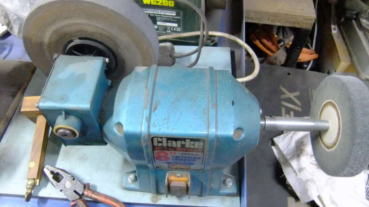

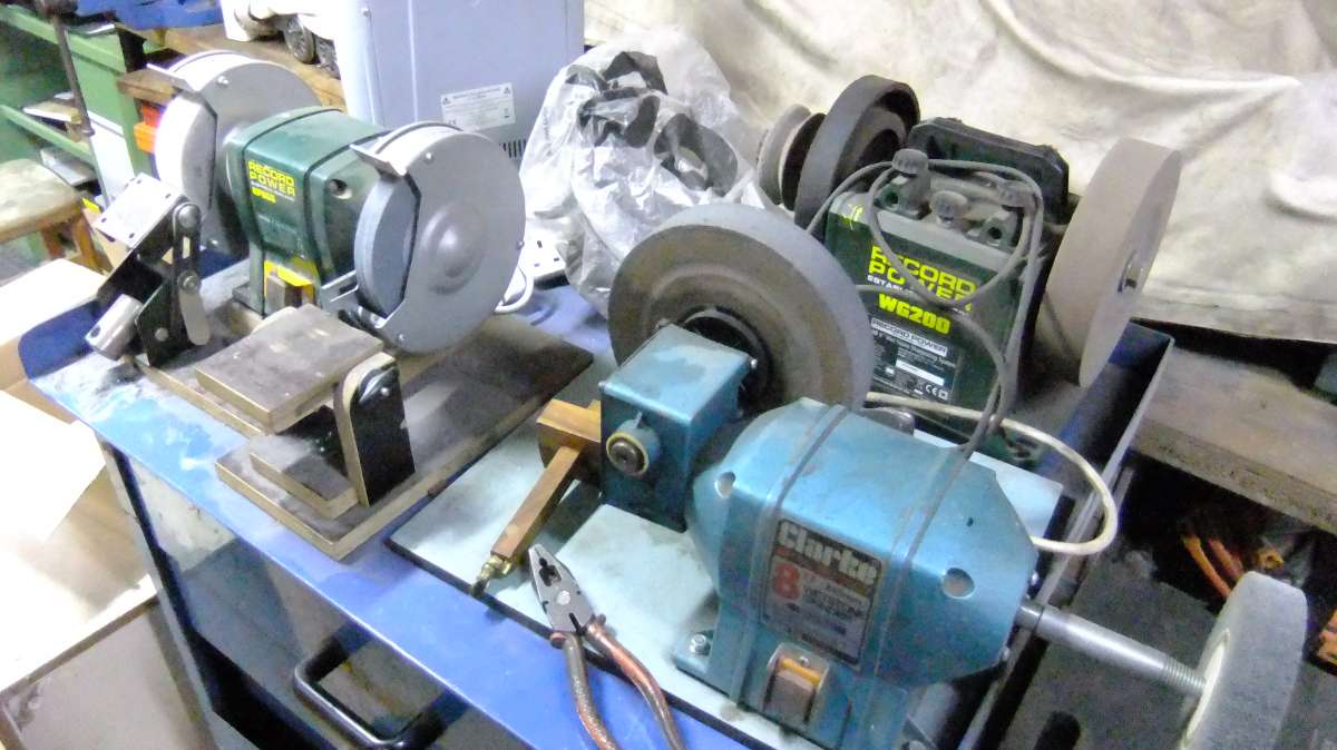

      I have a cheap grinder that I have converted to a scotch brite type wheel on the fast side, and I was wondering if it could be used as a sharpening station if I fitted a diamond wheel on the slow side where the wet stone is.
      Looking to grind lathe tools to start with. I can use the other grinder to get the rough shape then use this to do the final grinding
      I know that I would also need to make a rest of some sort (design to be looked at later)
      My grinding bench set up needs reorganising

      And the grinder in question
      clean up (6)
      #773023
      Bazyle
        @bazyle
        First measure the runout in all directions.
        #773025
        Dalboy
          @dalboy
          I will check it. I did think of that but forgot to put in my original post. It is just that the slow side was sitting doing nothing. As can be seen, it is mounted on a separate board so that it can be turned around on the unit which is also on wheels so I can move it around.
          #773036
            I had one of those about 20yrs ago. The slow side was so untrue you could not even sharpen a chisel or plane iron on it and I don’t just mean the stone needed dressing the spindle was just wobbly.

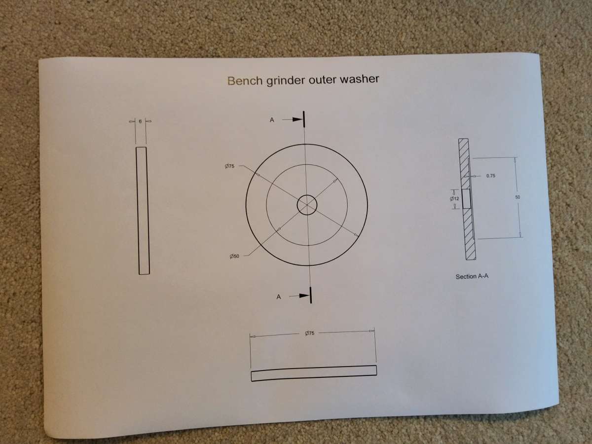

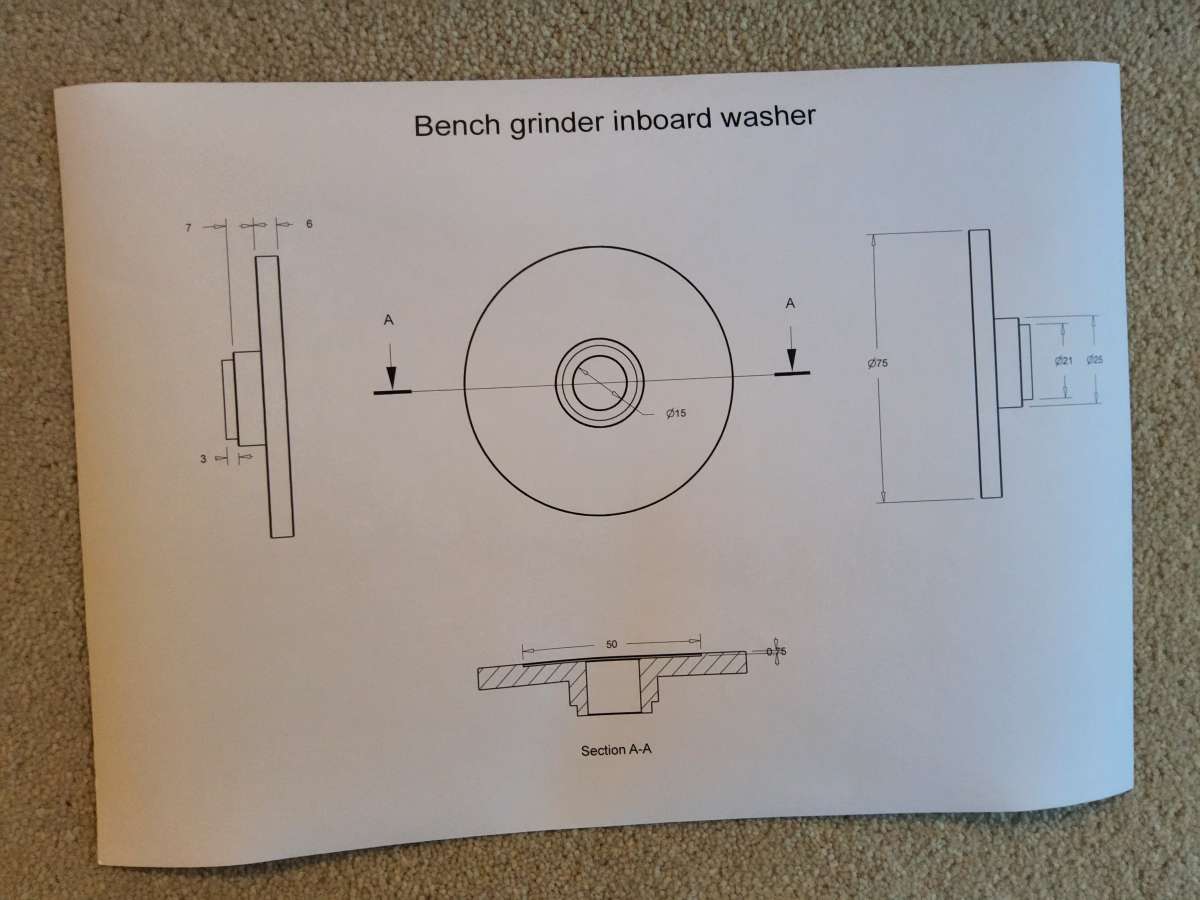

            David George 1
              @davidgeorge1
              Make some new washers for the grinding wheel spindle the ones suplied are cheep pressed type and you can make ones which are wider on the spindle diamiter which stopps the wobble.
              20240704_211443
              20240704_211416
              Similar to these but measure your grinder spindles.

              #773038
              Dalboy
                @dalboy
                The first thing I want to look at is the gear box and what they describe as bearings before I check any run out of the shaft.
                And yes I will check the flanges and as you say David make new ones, I did not think of those at the time of posting

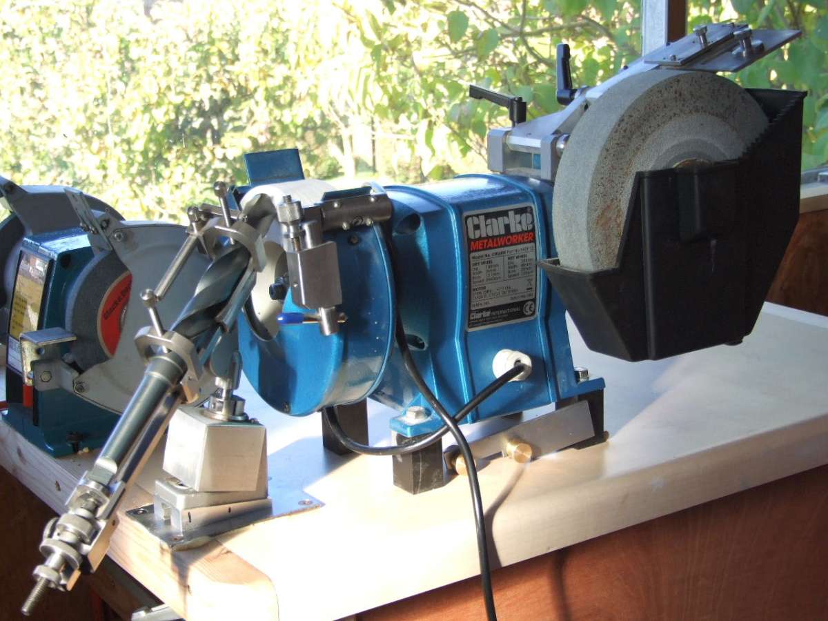

                  #773041
                  Graham Meek
                    @grahammeek88282
                    This grinder came with plastic wheel washers on the slow moving wheel. They were of course changed. The bearings were Oilite bushes.
                    New Set-up
                    Regards
                    Gray,
