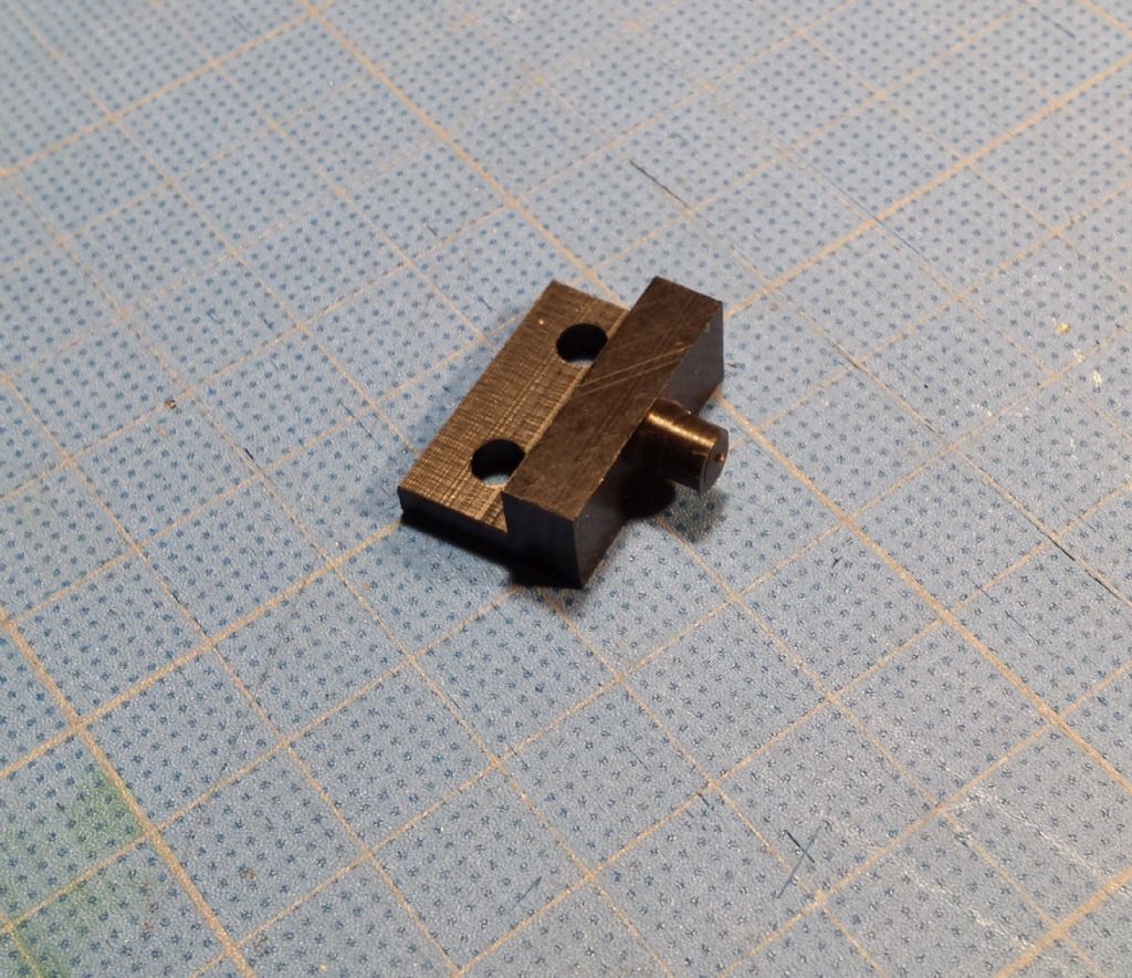

              I have some parts to make and the idea of an affordable (less than £250 say) printer rather appeals to me because making the part in the picture on the milling machine is a pain (I need about 50 of them) in about three weeks time. Currently I use Delrin because it machines nicely but the material is really not critical, although black is preferable.
              Its about 20mm long and the protruding peg is 5mm diameter, am I being realistic in expecting to buy and assemble a printer and get usable results without a long learning curve?
