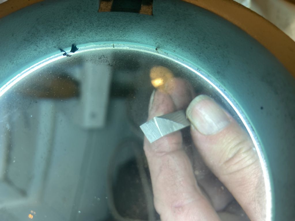

            Unless I'm not seeing clearly, the tool appears to have a short area of negative rake. If this is the case, whilst it reduces or eliminates the risk of dig ins, it may not be the ideal geometry for turning brass.
            FWIW, my method would be, for brass, a knife tool with zero top rake, and to wind the tool out before winding the saddle back. Front and side clearances are necessary, but only about 5 degrees

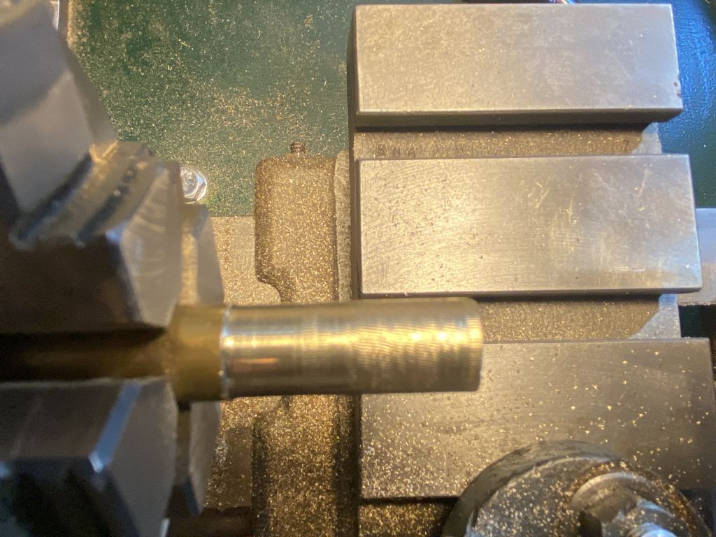

            (That coarse helix does look like the Saddle being wound back while the work was rotating. )
            Are you hand or power feeding?
            If the lathe has a Leadscrew, the changewheels / gearbox can be set to give a fine feed of 0.004" / 0.05 mm per rev. If the tool geometry is correct, and mounted on centre height, that should result in a good finish on brass.
            You will need to calculate the gear train to give 250 tpi, or 0.05 mm pitch for the fine feed. As aleady said, you are producing a screwthread of fine pitch.
            The finishing cut needs to be shallow, especially when using HSS tools, probably of the same order as the feed rate, or maybe less..

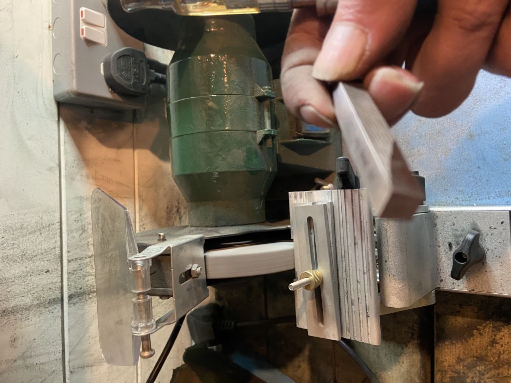

                    Well, I ground my first HSS cutting tool. Is that right? Luckily I have suitable kit to do that due to my woodworking habit. I’ll give it a proper test after work.

                      From your photo it looks wrong, but if the point of that little triangle is not as far out as it's base (top of tool) then it will work. A rounded edge would be better.
                      PS I've never seen an HSS blank that didn't have polished sides.

                                I get the rotation, it's the little flat that you ground on the point to widen it looks to have no clearance
                                  Agreed. It will in fact give a severe negative rake to the cutting point.
                                  If you want to have a small flat, or a rounding, on the point it should be ground all the way down the leading edge.  The top of the tool must remain flat.

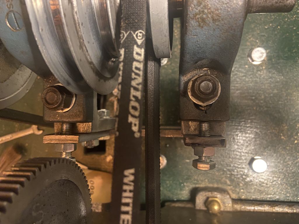

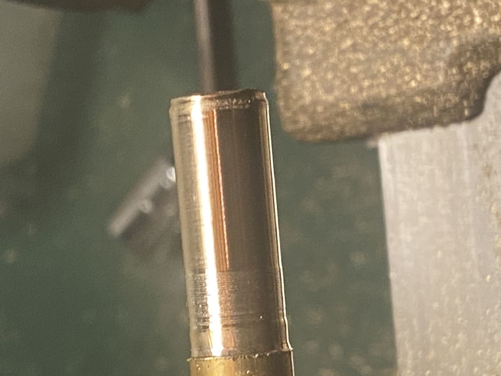

                                    Right, thanks for all the help from this excellent forum, I think I’m starting to understand some of this. I think there are actually three problems:
                                    1) a problem With the collar at the tail end of the spindle, looseness was causing longitudinal movement of the spindle. I think I have fixed that.
                                    2) A problem with tooling, resulting in the finish being a “long thread” when tail support is applied. The tail support would also stop any longitudinal movement of the spindle. I will re-grind the tool tonight and give this another go.
                                    3) I have also noticed that in order for the spindle to turn, the bolts that secure the spindle in the headstock need to be only slightly more than finger tight. Whilst it seems that there is no lateral movement on the spindle, if I pull the spindle with a little force, I can feel the headstock slots flexing. So therefore there must be very little rigidity, and it may explain The test cut I did last night, where on an unsupported pace the finish is horrible further out, improving markedly closer to the Chuck.
                                    But if I tighten the headstock bolts, the spindle will not turn. A couple of questions:
                                    Does this make sense? Might this be a problem?
                                    What tension should the V-belt be? Is there any way I can measure it?
                                    It’s a basic cheapo eBay V-belt. Is this the wrong kind of belt? I have seen a myriad of different belt types on lathes.co.uk.
                                    I will get to the bottom of this!
                                    cheers
                                    Steve

                                        Steve,
                                        Don't for one minute believe that when you acquire an old machine that it was assembled properly by the 10 previous owners.
                                        Looking at the 'lathes' Zyto photos there are no grubscrews, come to that I can't see a collar either. The bearing slits are approx. half the size of the head stock slits
                                        If both bearings are the same size I would try swapping front with rear so that the grub screws and oil holes still line up, but the bearing slot is now at the back, and see if that makes a difference. I still think there should be a dense felt strip trapped in the bearing slit which would also help. If this lathe was built like it is now the bearing bolts would be knurled knobs, hex heads imply more than finger tight was required. You can very easily crack the head stock with slits as large as you have using a spanner.
                                        You can also see the proper fit of the belt in more modern pullies, tension is about right when you can twist the belt 90 deg. or deflect the belt inwards 1/2"
                                        BTW your last photo shows a classic case of too much stick out from the chuck causing chatter.

                                          The bronze (not brass) bush in the headstock is split for adjustment. The grub screw is to stop it rotating and shouldn't compress the bush. The casting the into which the bush is fitted is also split so tightening the hex headed bolt will compress the bush to take up slight wear. I would imagine that there should be a stack of shims in the slot in that casting to control how far the compression goes. Thet would allow the bolt to be done up tight without locking the spindle.

                                            I suspect that the OP's poor finish is largely due either to the grinding of the tool, with the small flat on the tip, or possibly, and less likely, to bearings worn badly out-of-round.

                                              Right, I am getting there at last…..
                                              I lashed up a belt tensioning system so could tighten the bearings to stop the chatter without the belt slipping….
                                              Belt tensioner

                                              and the result was a much, much better finish, and no chatter marks further out along the piece.
                                              now to watch some more videos on grinding tool bits properly.

                                                Some cheap V belts have a swollen area near the join.
                                                Good quality belts don't. A lumpy belt will cause a slight variation in speed of the Mandrel, which will not help your problem.
                                                Looking at the tool that you ground, it has a flat on the corner where it should be cutting.
                                                A Knife tool will have a sharp corner. By very slightly stoning a radius, as said, all the way down the edge, the finish will improve.
                                                But start with a SHARP corner, before trying to stone a radius.
                                                The radius must extend down the edge, or the tool will rub rather than cut. For the tool to cut, the pressure at the point of contact must be great enough for the metal to shear. Hence the need for an almost point contact, to give minimal area to support the applied load, and produce high pressure..
