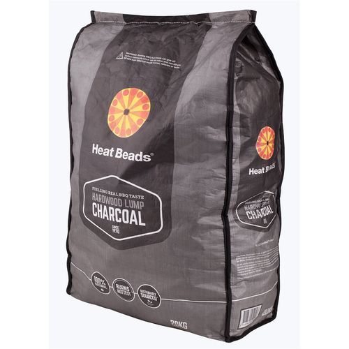

                  As Nick originally stated, it is difficult to get coal in small quantities for model engines, even though Australia has vast quantities. Fortunately, I also belong to a full size steam engine club that gets it by a 20 ton truck load.
                  Nick, this the type of charcoal that I have used which is made from hard wood but at almost $60 for a 20 kg bag is expensive and I would burn 2 of these on a full days steaming.
