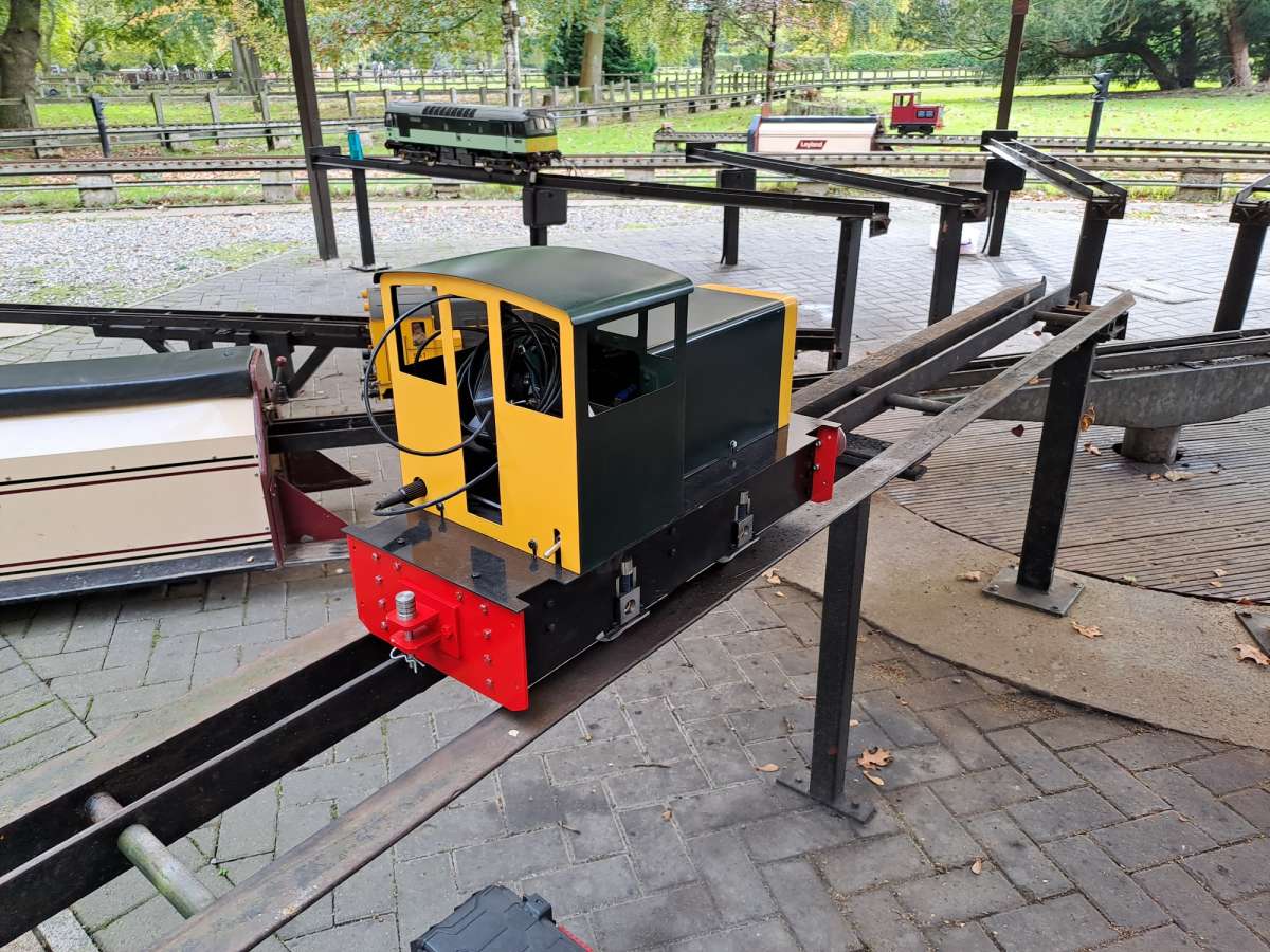

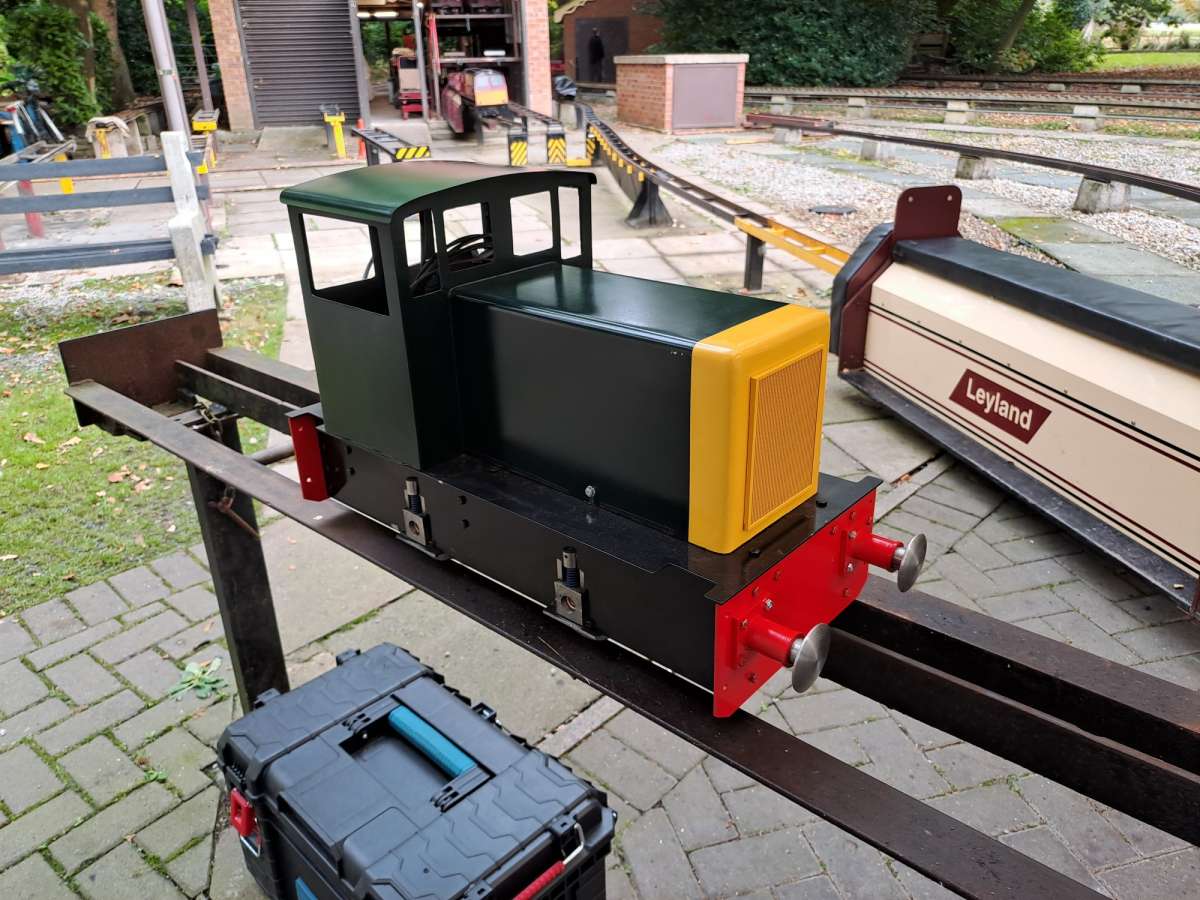

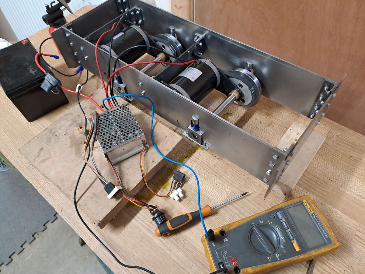

                            Ron laden described 2 locos. Here are the links:
                            https://www.model-engineer.co.uk/forums/topic/class-22-diesel-next-project/
                            https://www.model-engineer.co.uk/forums/topic/5-inch-0-4-0-shunter/
                            I have made an 0-4-0 battery shunter using ideas from Ron’s locos.
                            I used 2 x 12v 150w scooter motors and toothed belt drives to the axles. The 12v ones aren’t listed now but this is the equivalent 24v one from the same supplier. My loco can pull 2 passenger trucks with about 4 adults and 4 children.
                            https://www.ebay.co.uk/itm/164841631820
                            Stuart
                            #769946
                            Stuart Smith 5
                              @stuartsmith5
                              Some photos of my loco:
