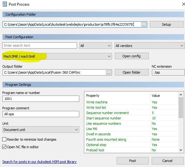

                      I have been using Fusion 360 for some time now and am now branching into the CAM or Manufacturing function. My CNC machine is a Sieg X3 upgraded with a 400Hz , 24,000RPM Inverter drive ( from CNC4you.co.uk) running under Mach 3. The basic Fusion 36 does not list a Post processor for Artsoft – Mach 3 but there is one on an AutoDesk website :- https://cam.autodesk.com/hsmposts I hope this is of use to anyone using Fusion 360.
                      #500259
                        Should do, I had no problem finding it the first time I wanted it and it comes up as that each time now
                        #500263
                        Emgee
                          @emgee
                          Mach 3 mill was in the pp list but not Mach 3 Turn. I had to import the Mach 3 Turn post processor from the Mach 3 forum into the Fusion list, as Jason says once you've used the pp it remembers for the next time of use.
                          Emgee
