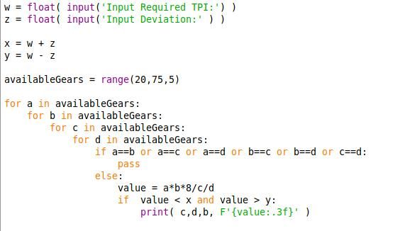

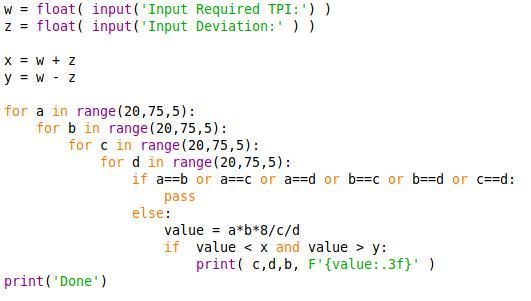

          For historical reasons, BASIC isn't my favourite language, though it should appeal strongly to anyone brought up on ZX-Spectrum, BBC or any other Home Computer from the heyday of 8-bit computing. BASIC isn't a good choice as a beginner language today, and – of the alternatives – I recommend Python.
          In his other post Ian announces Micromite BASIC is available for the Raspberry Pico, undoubtedly good news for BASIC writers who want to develop on a microcontroller. However, as the Raspberry Pico arrives off the shelf with Python, it's worth showing what Ian's program looks like in Python, especially as it provides a simple demonstration of a Python feature BASIC struggles to emulate.
          First, this is Ian's program in Python. (Any mistakes are mine!)
          Very similar to BASIC, but note the syntax is cleaner. There's no need for the STEP label, or the list of NEXTs at the end. The print statement shows off a format string: value is output to 3 places of decimals.
          One improvement to the Python version by making it more general is using the range() statement to generate a list of availableGears, which all the for loops share. Reads a shade better I think.

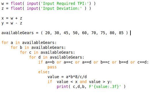

          That's not the best bit. BASIC for loops are limited to numbers, whereas Python's for can iterate several different objects, such as lists, sets, ranges, dictionaries and other containers. Helps solve a real-world problem: the gear-set my lathe has doesn't match the simple number sequences generated by BASIC's for statement. No problem in Python because I can list them:
          availableGears = ( 20, 30, 45, 50, 60, 70, 75, 80, 85 )
          And it would be easy to add 63 or 127 or any other gears wanted.
          Although it's not difficult to code for odd sets of gears in BASIC by indexing them from an array, it's more work and opportunity for mistakes. Python makes working with lists as easy as working with ranges. Substituting a list for a range is a simple example, but Python's ability to apply the same pattern to nested containers of different types is very powerful.

                      I'm not going to get involved in the 'which language is better' issue, but both the original Basic and SOD's python omit to print out the value for the first gear in the train, 'a'
                      I think the Basic should read:
                      If A*B*8/C/D < X And A*B*8/C/D > Y Then Print A," ", C;" "; D; " "; B;" ";A*B*8/C/D
                      and the last line of the Python should be
                      print(a,c,d,b, F'{value:.3f}&#39
                      or even better print("a = ", a, "c = ", c, £d = ", d, "b = ", b, "tpi = ", F'{value:.3f}&#39
