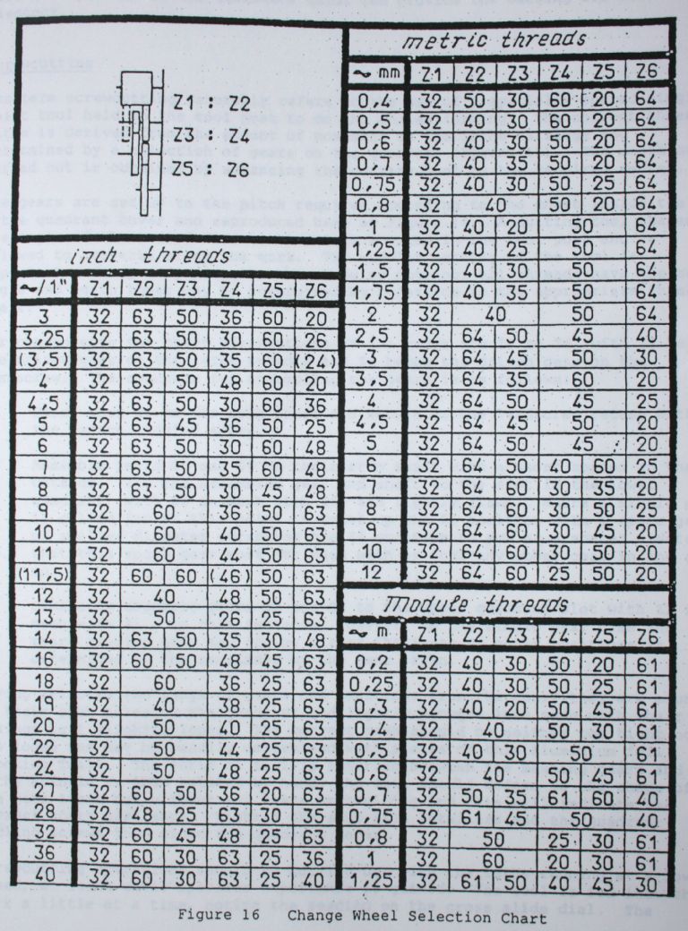

                                        Hi Chris, as I’ve stated previously, the 61, 63 and 64 on this lathe are never used in the same train, let alone on the same shaft. So unless the combination is embedded in the other wheels somehow, in the train saying the 63 or 64 is the driver in all aspects, doesn’t seem to follow.
                                        Viz. selection chart.
                                        Peter, in my photostat copy, the inch calculations are expressed thus;
                                              7 x 25.4/28.0035 multiplyed by z1/z2 x z3/z4 x z5/z6
                                        this dosen’t seem to tally with the chart. However.if it is expressed like so it does;
                                              7 x 25.4/28.0035 devided by z1/z2 x z2/z3 x z4/z5
                                        maybe there was a printing error
                                        Regards Nick

                                                Your chart cuts off at 40tpi and is labelled Fig 16. Mine goes down to 72 tpi, and is labelled Fig 8.
                                                As regards the formula for tpi, I had picked up that there was a discrepancy therein, and had found that eliminating the “0035” figure made it more accurate. (Decimal point is  deliberately not shown.) This still gives errors of a few hundredths.
                                                However, adding 0.0035 to 28, as you have shown, then gives dead accurate figures for tpi, accurate to 15 decimal places according to my spreadsheet.
                                                Which suggests to me that Mashstroy, have deliberately chosen ratios to give an exact conversion, in which case, the fact that one wheel is 63T, and is not quite 127/2, is for us irrelevant.
                                                It is of course possible then to simplify the formula even more, and I get this:
                                                                177.8            Z2            Z4
                                                 tpi =     ———–   x    —-    x    —–     x    Z6
                                                              896.112          Z3           Z5
                                                This takes into account all the fixed values and the fraction values are exact. Calculating 177.8 / 896.112 gives an indeterminate number, hence leaving as a fraction.
                                                For those who are wondering, Z1 is always 32, hence can be incorporated into the fraction.
