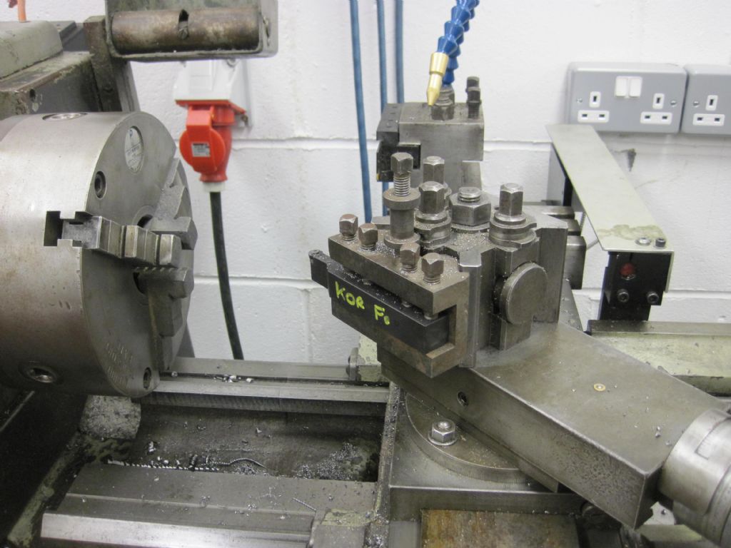

                                        #153407
                                        Colin Heseltine
                                          @colinheseltine48622
                                          Hugh,
                                          I cant help with your chamfering issue but am interested in which QCTP you are using. I also have a Colchester Student lathe (squarehead) and am looking to obtain a QCTP for this lathe rather than use the not very nice 4 way toolpost.
                                          Thanks,
                                          Colin
                                          #153435
                                            > if you have a good indexing base
                                            I do, it's as repeatable as swapping toolholders and changing back again.
                                            #153436
                                            Hugh Gilhespie
                                              @hughgilhespie56163
                                              Colin,
                                              The QCTP came with the lathe when I bought it. It is a Dickson type and I believe it is size T2. It is a pleasure to use and particularly as I was lucky enough to buy a goodly number of tool holders from an ex-employee of Colchester lathes along with some other goodies, including the reat tool post that I use for parting off with an upside down tool.
                                              I will try and post a picture of the QCTP.
                                              Regards, Hugh

                                                #153443
                                                Hugh Gilhespie
                                                  @hughgilhespie56163
                                                  Colin,
                                                  This is the toolpost on my Student
