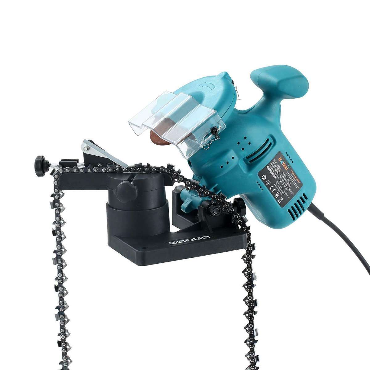

          I brought a small electric chain sharpener for mine this involves removing the chain to sharpen it. Something like THIS

            A friend who uses his chainsaw a lot has an electric sharpener from either Lidl or Aldi – I guess they come up every now and then.

                            Tree surgeon friends I trust say those cheap electric ones do work well for DIY peeps like us. It is still worth learning how to sharpen with nothing but a file – for a quick tune up during a long day in the woods or when you don’t have electric power handy.

                                I’ve used my chainsaws a lot.. perhaps less the last couple of years. I started out learning to sharpen with a file and generally results were acceptable but every now and again I’d end up with a chain that didn’t cut straight down rather it would cut at an angle. Sometimes it took a few resharpening goes biasing the amount of file to get the chain cutting straight again.
                                In contrast a simple cheap lidl type electric sharpener gives excellent results. I just set mine up just to kiss the front of the tooth and the bottom of the gullet. The chain cuts  longer than when I hand sharpened, always cuts straight and produces good chips. Yes it’s worth having the file handy if going off into the woods where trees may have mud and stones embedded or you’re cutting fallen stuff but you can’t beat the electric sharpener for results.
