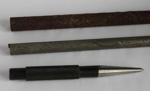

                    I make my own punches using some high carbon steel I have but they can be easily made from silver steel. PM me if you need advice and are interested. Here is an example made from some salvaged silver steel The bottom one is the home made punch. It too about 20 minutes from start to using:
