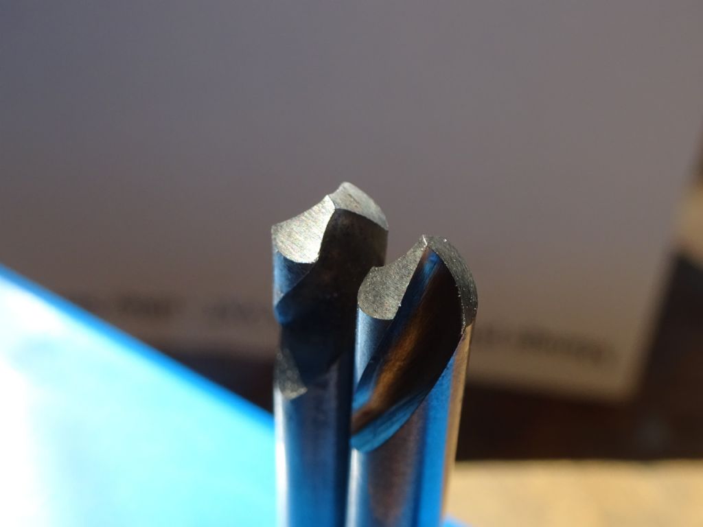

                                      Colin see my post earlier this morning for my thoughts an angle for all round hobby use. Don't know what size work you tend to do but 1/8" and 3/16" (3mm and 5mm) cover my work. As for sources MSC Direct, APT, Cutwel, Drill Services and good old e-bay to mane but a few. I think Tracy may also do a small range and JBcutting tools have also had them on their stand but not on website.
                                      Also worth pointing out that not all spot drills are created equal, in the forground is my usual KEO brand and the one behind I think was Interstate, the KEO has a lot more web thinning so the chisel is smaller and makes for easier spotting.
                                      Edited By JasonB on 27/04/2020 10:16:00

                                                  Took a look at a 5mm carbide spotting drill I bought for the CNC and could not see any chisel on the end of that, or if there was it was far less than those pics I posted earlier, will post a photo in a while.
