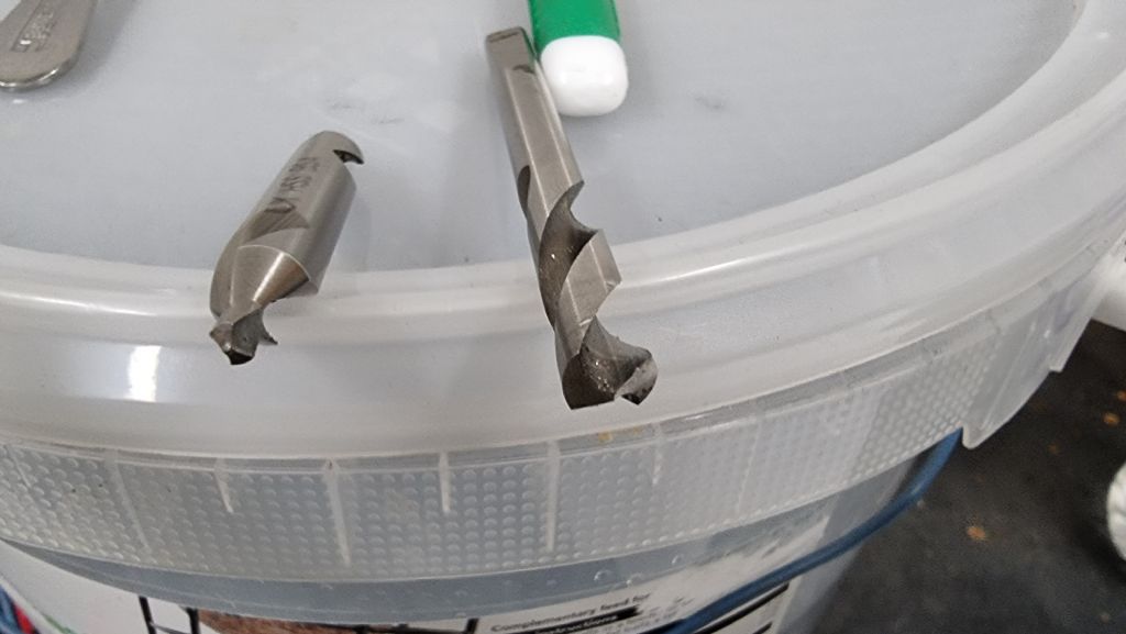

          The centre drill on the right is my go to for when i need to drill a hole. The left one for drilling for a centre on the lathe.
          Steve.

                If you take a close look at a lathe centre drill the cutting face is too broad to be used for spot drilling.
                Steve.

                                        The centre drill on the left has a wide flat at the tip which is not ideal for starting a very small drill. When it is used for its intended purpose, the 60 degree flanks provide the seating for a centre, and the tiny extended nose makes sure that the tip of the centre is not touching the workpiece. A proper spotting drill has very little length of flute for stiffness and a much sharper point which leaves a better starting hole for any size of drill. The drill on the right looks like a sheet metal drill rather than a centre drill.

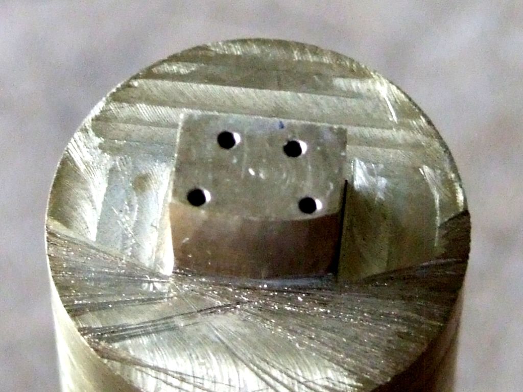

                                                For many holes you simply don't need to centre, or spot, drill first. The holes in this brass fixture –
                                                – were drilled No.70 (0.71mm) to fit 0.64mm pins soldered to a small PCB prior to press fitting into a plastic housing. Driling was done on a Bridgeport and no centre drill or spot drill was used. Even the smallest of both leaves too large an impression.
                                                Of course, I'm lazy and I'm not going to waste time doing operations that are not necessary. smile
