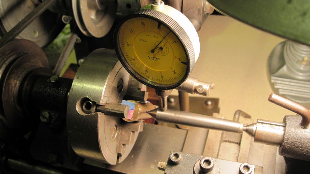

          After approximately centring using the method you describe, you can either use a dial gauge with a flat foot to clock the corners, or the same but with a standard tip to clock the flats. In each case you obviously have to be careful not to wreck the gauge – manually lifting the tip away from the work as you turn it into position.
          Start with one pair of opposite corners (or flats) first, and when they’re ok move on to the remaining two opposites. Much quicker to do than to describe.

                      Obviously start by rough aligned using the lines on the four jaw face. A bit of low cunning with a depth micrometer or the probe on a vernier / dial/ digital caliper on the outside of the jaws can help get it a bit better.
                      Put a suitably hefty bar with the end accurately perpendicular to the axis or similarly accurate and decently rigid L shape in the tool post to act as a setter reference. Something around 1" x 1" bar or 1" wide L will do. Run it up until it contacts the side of the square being centred. Lightly rotate the chuck bar and forth so the contact is true to the side. Note cross slide dial reading or zero dial. Retract setter, flip 180° and note dial reading. Re-set cross slide to halve the difference, remember backlash, and adjust four jaw to bring the square bar up to the setter. Flip 180° and check dial reading should be close. Repeat on the other sides. Go round again if need be. Quite possible to get a thou or less TIR.
                      Best to have a cross-slide stop when using a dial gauge so you can withdraw the cross-slide to get the gauge safely out of the way before rotating to the next side and go back to same position. One day you will forget. Even if its a fancy one with locking retract lever, mine would have been mega expensive at list price!
                      Make a note of the TPI or pitch of your jaw adjuster screws. Gives you a good idea of how much to turn them when adjusting. If you don't do a lot of four jaw work you loose the feel for how much a fraction of a turn shift things.

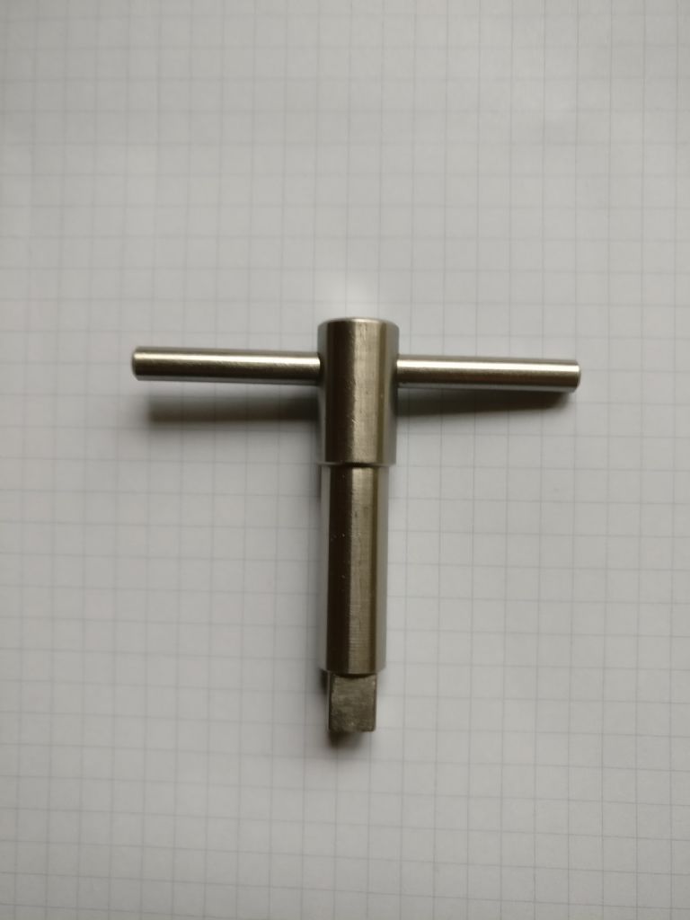

                                    Use 2 keys with your 4 jaw chuck and they become very quick to use. For and Aft or on a diagonal like when using a myford. My second key is just a piece of key steel made to fit the chuck with about a 38mm -1-1/2 inch disc attached.I use 2 of these, and the final tightening is just with one key that came with the chuck.

                                        One advantage of the hefty bar or L shape setter technique described in my first post is that bringing the setting piece up against the side of the bar pushes it back to perpendicular if you have rotated things a touch.
                                        Bar under a jaw as mentioned in my second post is also pretty effective at keeping things square. Just hold the chuck jaw down onto it to keep it horizontal.
                                        In my view routinely using a dial gauge on square stock is asking for trouble. Bound to forget about moving it out of the way one day. Usually when being frustrated by that bit of stock which refuses to come back dead right. Nearly but not quite.
                                        Needs a decent chuck and educated feel for the loosen two jaws and replace approach to work really well. Wasn't until I got my Heavy 10 that I had a chuck good enough to really behave.

                                                    As mentioned earlier in the thread, small chuck keys make adjusting the four jaw chuck easier and faster. I made two of these:
