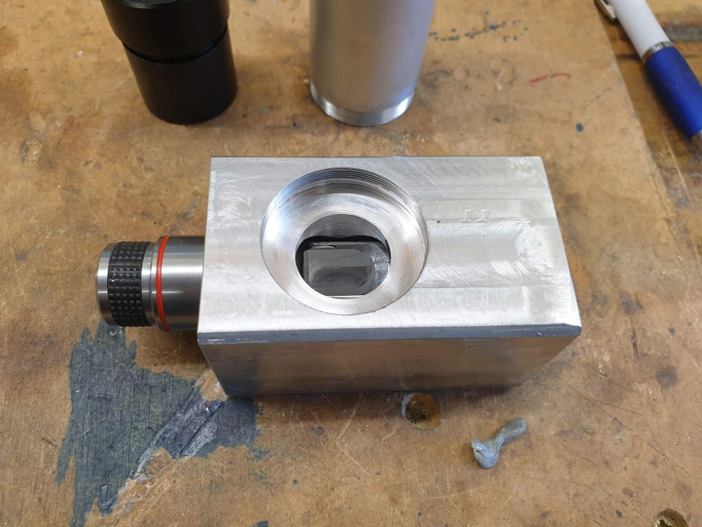

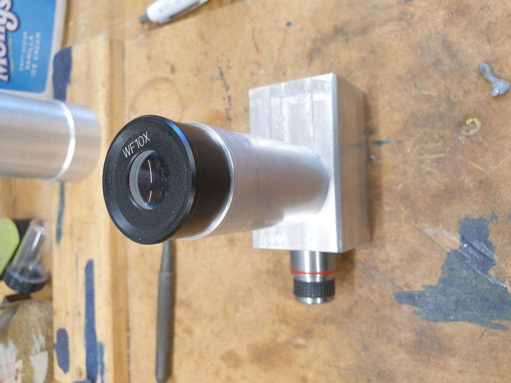

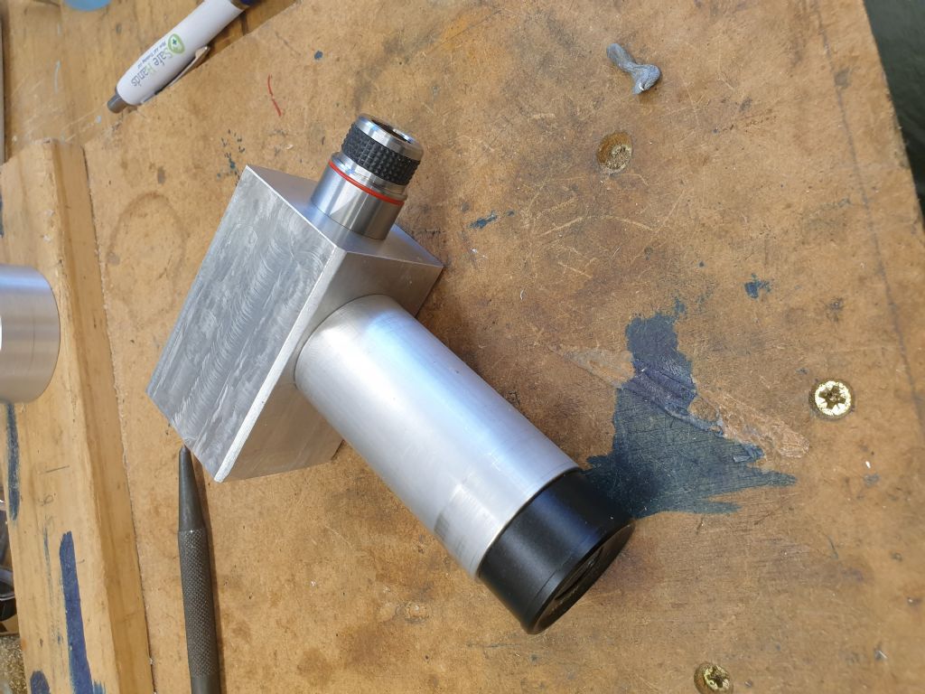

      I'm in the process of making myself a centering microscope to my own "design". I've already prototyped it to get the dimensions correct for the optics and am making the real thing now.
      It consists of a 4x objective lens, a glass prism and a 10x eyepiece with a a cross graticule.
      Pictures so far:20200705_201101.jpg
      I worked out that calibration is probably best achieved by small adjustments of the prism position, but I've not worked out best to achieve this yet. Looking for suggestions from anyone who had made one of these before.
      I'm currently thinking that with the prism mounted in a slightly undersized holder it could be moved via grub screws which would move it from the outside.
      Anyone made one of these before and knows of a good prism adjuster?
      Thanks

            Could you show the optical prism as there are a couple of types which need different mountings to adjust. Circular movement and centering. Also an adjustment for vertical position. This means a grub screw to set it in the vertical plane. All fixings have been soft setting epoxy glue as araldite will crack the prism(Glass) on setting hard. and causing stress in the glass.
            maybe mount on a circular mount with a sloping side so that long grubscrews can be used to move it set at 120 deg.
            Close focusis essential and I assume you will mount it on a taper or parallel stub to hold it.

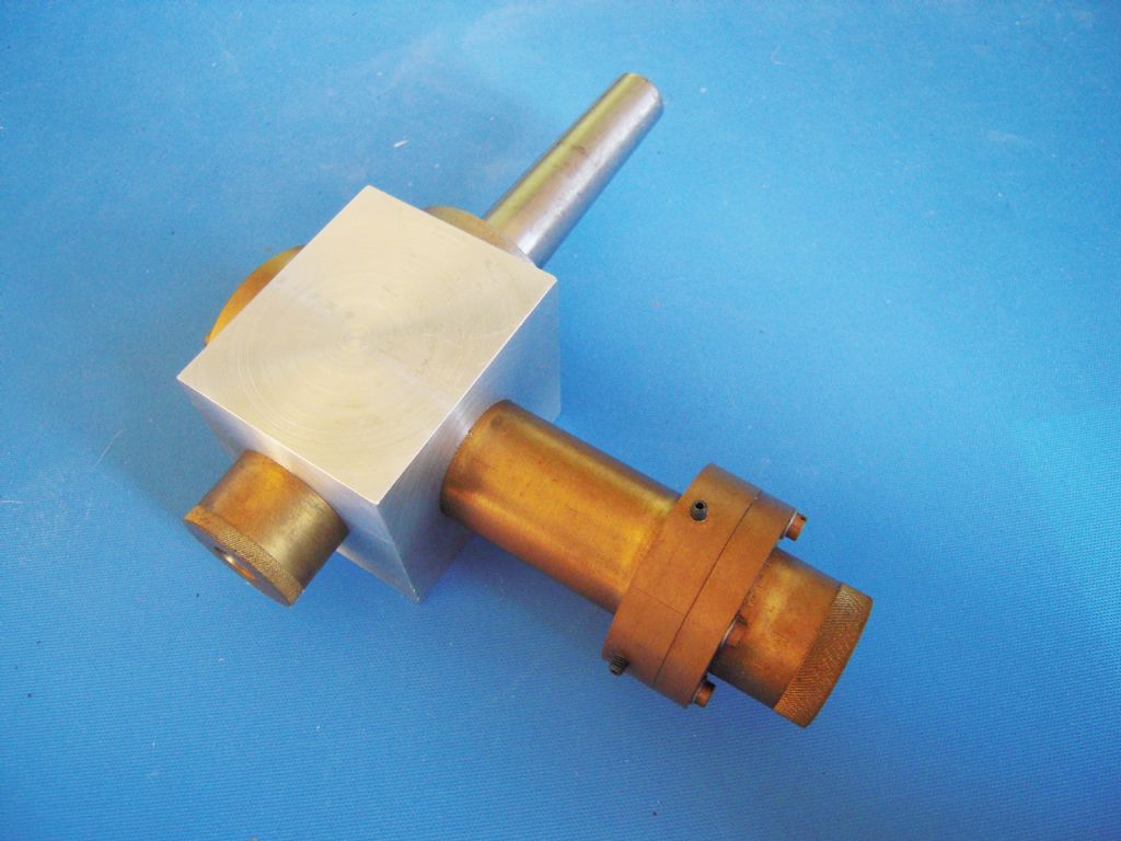

                I made a centring microscope that followed D A G Brown and R O Stephens' design which appeared in the Model Engineer in September 1999. I made a couple of changes: Used different focal length lenses (that were available) and a prism instead of a mirror. In both cases the mirror or prism was fixed and adjustment was made by moving the graticule. The graticule carrier was laterally held in place by four grub screws.
                The microscope is a useful tool but suffers from two failings: The object viewed needs to be well illuminated and one needs to be a bit of a contortionist to use it in a vertical milling machine. If I was making one now I would try to put a camera on it and view using a computer.

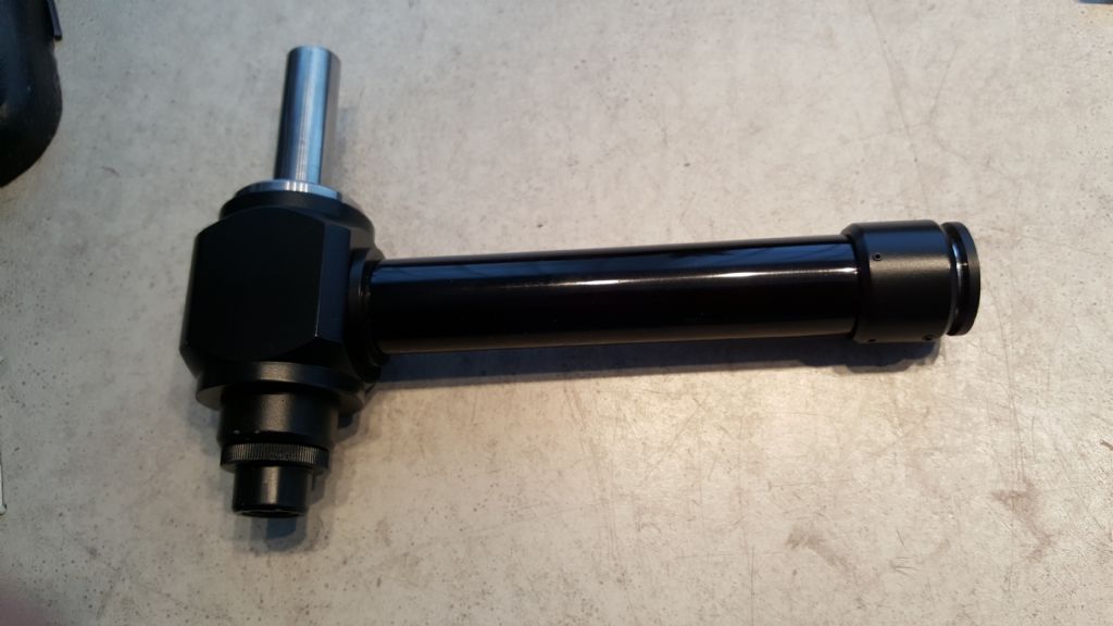

                    I made the Hemingway centring microscope which I highly recommend and wouldn't be without. The prism is glued in place and the graticule centred using four screws.

                      The Hemingway centring microscope is a redesign of the one described in the September 1999 issue of the Model Engineer.

                        I have experience with optical instruments. I see you have assembled the components except for the spindle mount. the current image location could give you an idea of the adjustments needed. I would lock the eyepiece in place in the tube to eliminate movement. I would also Lac the reticle in. Some eyepieces have a wire ring to hold it in, some have push in type holders some have screw in type holders. I have seen some where the reticle would rattle in place if moved. Clean the reticle well on the eyepiece side prior to setting in place. Depending on the quality of the reticle there can be small black dots on the photoetched side that are not removable. The photoetched side goes toward the eyepiece. If using a small compressed air can hold it upright pointing up to avoid the liquid propellent being sprayed on the surface making a worse mess than you started with.
                        It looks as if your prism mount slides in a round hole and the fit will effect the adjustment. I would put adjustment screws in for left-right movement and up-down movement. If your image is satisfactory that may be all that is needed. A second set would give an angular adjustment pointing to the left or right and angling up or down.

                          Thanks all for the replies, photographs and comments. I've not decided exactly how to proceed yet, but I've got several options here for finishing the project.
                          I'm thinking that having an adjustment for the graticule / eyepiece is going to be easier than a prism adjustment. If I can get the prism almost correct, fine adjustments can be made with the screws for the graticule/eyepeice.
                          I also like the idea of using an eyepeice camera to view on a monitor screen. That would be a future improvement.

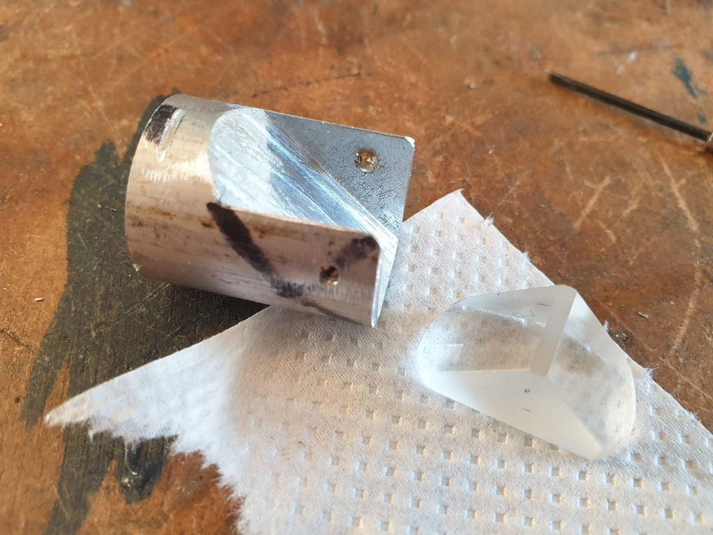

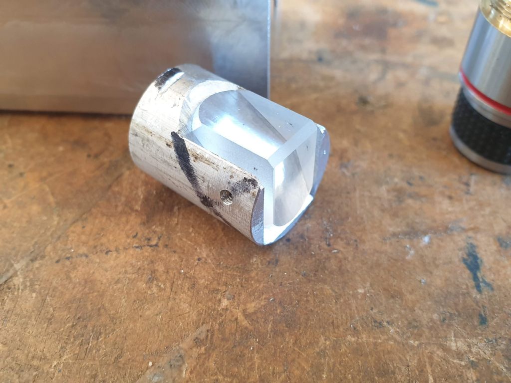

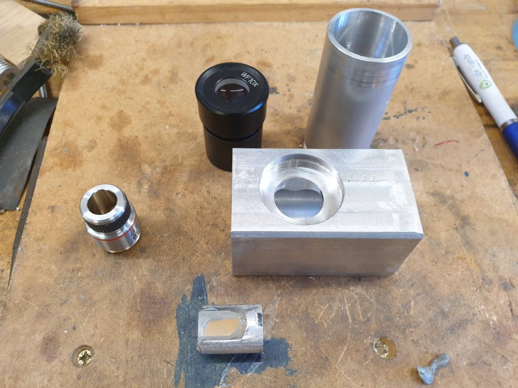

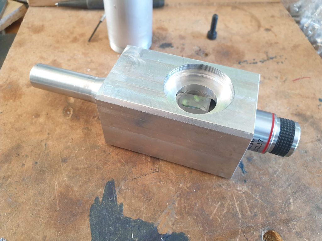

                              Going back to your original post here is the prism I am using. It is a prism from a broken pair of cheap binoculars without any prism adjustment for me to take inspiration from!
                              The holder is quite crude and I'm expecting to have to make something different to allow for adjustment.
                              Here is a view of the prism in place. At the moment it is held in the body of the scope by a single scrub screw to keep it fixed – no adjustment possible at the moment.
                              Looking through the scope, the image is very clear so the prism and optics feel like the right components…

                                      Mark B, the prism mount is fine except for one thing. Do not seat the prism flat on the machined surface, mill out a clearance leaving a shelf iether side of the slot so only the edges touch the prism. As for fixing, use thickened shellac . The prism mount needs a hole drilled opposite the grub screw so you can apply shellac to reach the prism. You can also apply shellac under the grub screw.
                                      That type of prism ensures you have a right angle linne of sight through the optical system, when fitted to the prism mount you can swing the prism left and right in the right angle optically, movement backwards and forwards of the mount will give you further adjustment in the other plane.
