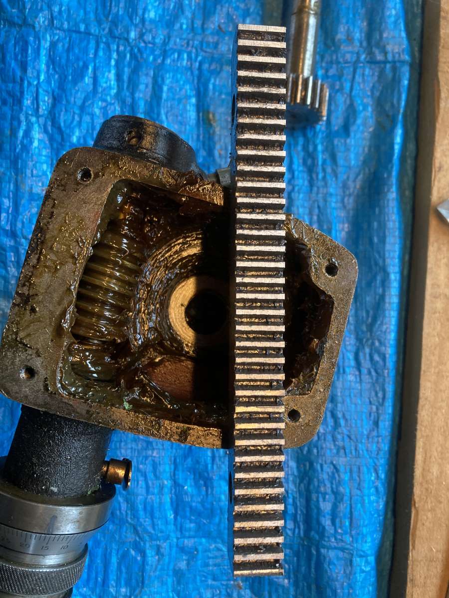

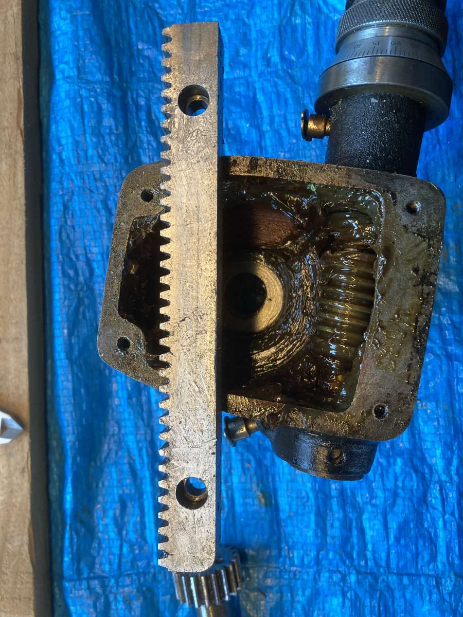

            DC31k
              @dc31k
              On Dave Halford Said:
              If the worm end of the shaft has the .074″ correction built into it changing the 20T will throw the worm out
              I am not sure that is so. You build the correction (translation gears) downstream of the worm wheel and upstream of the rack pinion gear. Effectively, you cut the shaft between the worm wheel and rack pinion, install a 54t on one end of it, a 53t on the other end of it (both gears cut on the same pitch diameter so they mesh at the same centres) and a double width idler pinion to mesh the two and maintain the direction. It would be very similar to what goes on in a set of Gamet dual dials.
              The existing 20t 0.200″ CP gear is 1.400″ OD. A 22t 1.5 MOD gear is 1.417″ OD. A 20t 16DP gear is 1.375″ OD. This means the space requirements of any change are 17 thou increase or 25 thou decrease. I would find it hard to believe things are so tight there that these requirements are unmanagable.

              martin cross 1
                @martincross1
                I’ve counted the teeth on the worm gear and it’s 40, also I’ve checked by turning the handle and 40 turns gives 1 revolution of the gear.
                I’ve re-measured the pinion and it’s 1.4″+/- a thou or so due being a bit abused. I’ve also posted a few pics of the rack. IMG_7070IMG_7071
