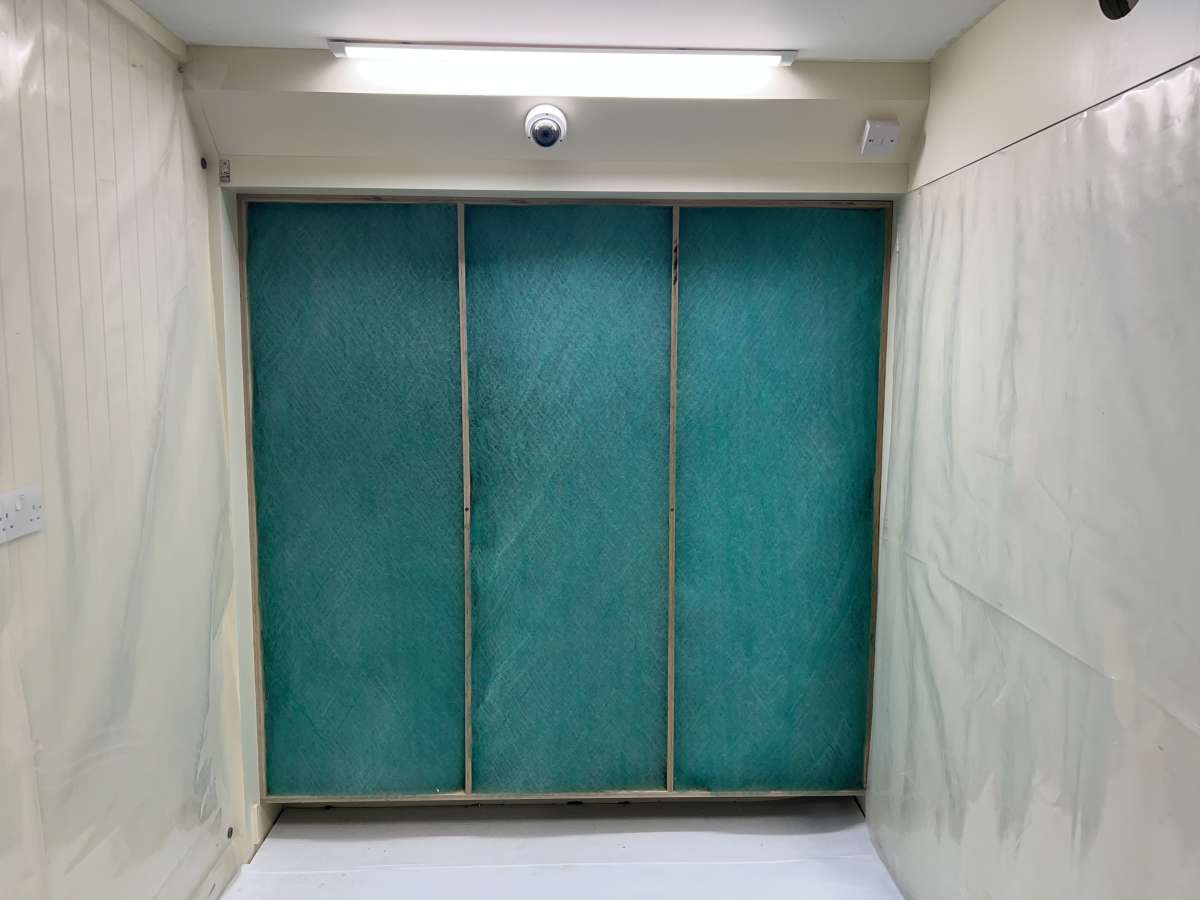

              #785193
              Graham Horne 2
                @grahamhorne2
                This is the folding open front spray booth.

                #785641
                Graham Horne 2
                  @grahamhorne2
                  Spray painting the parts went pretty smoothly overall. It was a bit tricky getting enough coverage in all the nooks and crannies, especially on some of the more complex shapes like the Mk3 vertical head drive shaft and the spindle shaft component. Luckily, the more intricate parts turned out great with no sags, probably because they didn’t have any big vertical flat sections. The bigger parts, like the column, which has vertical flat sections, ended up with a slight sag on one side (you have to be picky to see it). The column’s just too heavy to move around, so I had to leave it upright and paint around the gear shift covers on one side.
                  I’m going to let everything dry completely for a few weeks so the paint cures properly. After that, I might try lightly sanding some paint in an inconspicuous spot (probably on the back of the base) and then do some fine sanding up to around 2000 grit before a buff. If it works well there, I’ll give the column a try. If not, I’ll just leave it as is. The finish is super shiny, and I’m pretty confident once it’s fully cured, it’ll be hard and durable.
