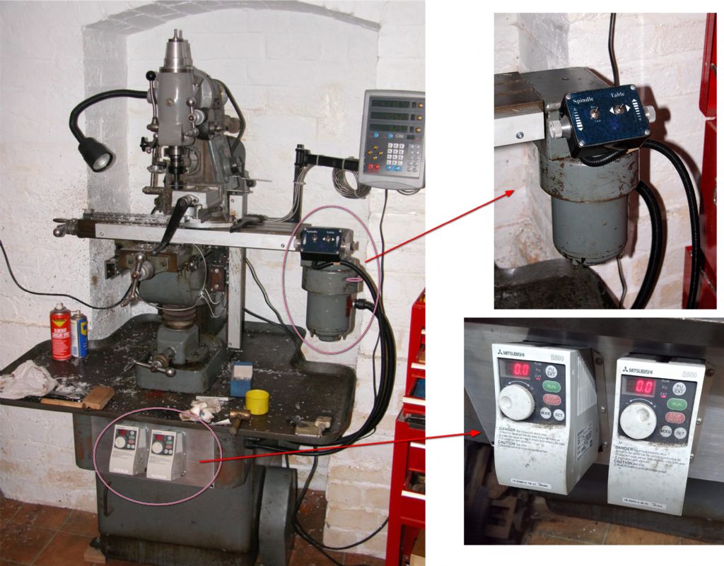

                                                  I actually burst the star point on my two 3ph motors and added two 2nd hand Mitsubishi VFDs under the suds tray. I have no need to access them, but they are easily visible and out of the way. The major difficulty was the removal of the table motor – see my album. I made a little control box which I mounted on the end of the table – this provides finger-tip control of spindle and table speeds and directions. I would hate to be without it now.

                                                    Thanks for posting the pictures Gary this gives me some good ideas about positioning the inverters and also setting up a remote console too. I've also been looking at your Centec album and like the setup you have for the DRO – I will be doing something similar myself.
                                                    The riser block you have on that machine looks very useful – where did you get that from, or was it something you made yourself?

                                                      I have one just like that. Most certainly Gary’s was made by himself (he made several) and I expect mine was made by him, too. A very handy piece of kit. The long version saves a lot of manual exertion (which is getting to be too much, for me, these days).🙂
