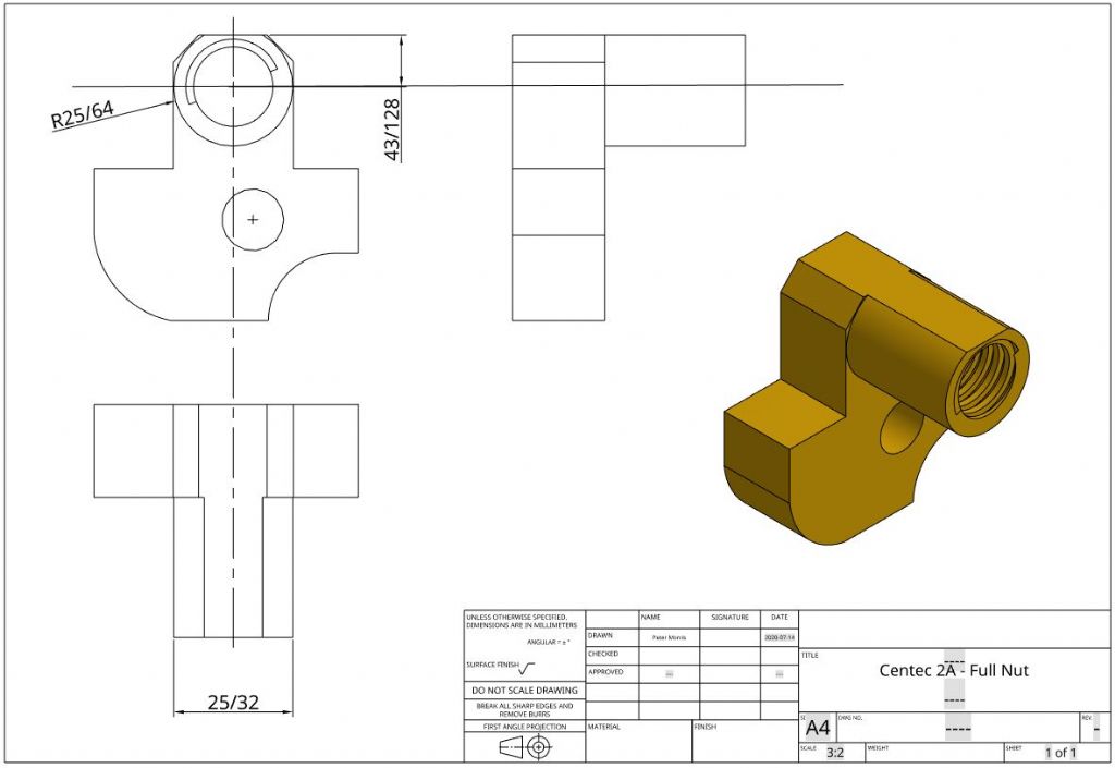

                  If you've got a full nut on a 5/8" screw could you tell me what the OD is. It all looks a bit tight to me as the screw is close up to the underside of the table, but I've been thinking of a swapping to a full nut (in the distant future, same as a lot of my projects).

                    I removed the table before I even discovered the nut – its about 30years since I've seen this mill working so have been stripping it blind!. I'll do a drawing and photo of mine and post here – it might be more helpful.

                      Full NutHi Duncan,
                      Hope these help. If you want more from the drawing I can share using Onshape (my goto CAD package)..
                      Regards
                      full nut drawing

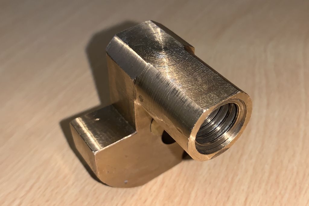

                        Avon, (Peter),
                        I had a dig around my “ may come in useful some day” box , and found the half nut .
                        It is now packed and awaiting posting ( which will likely be on Thursday, since our trips out are extremely limited just now ) , but it will be on its way this week.
                        I think we should mark this one down as a ; thank you for giving me the opportunity to do a good turn for someone .

                            Thanks for the drawing. It's the first time I've ever had a drawing with dimensions in 1/128 ths. It confirms I'm not going to get a ball screw nut in there. I've sent you my email address by pm, if you could send me the drawing in dxf or dwg format I'd be obliged

                              Email sent with both DXF and DWG. For info the link to the ONSHAPE drawing is:
                              https://cad.onshape.com/documents/a2e0a0ebaf385baddcff3f15/w/d4fa5ebbd6215d9ab93d4805/e/cf7ccd99fd7d2bb21ba9292c
                              I use 1/128" as that's what my calipers give me – I'm measuring as built/worn out so its almost never a nice number, though on occasion I have thought that my lathe in particular is more metric than imperial!

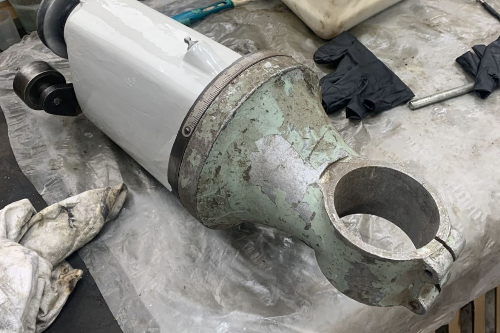

                              For info, do you have any idea what dirty green accessory might really be for in my picture above? Its a perfect fit to replace the Quill Head on the Mk3 vertical unit, but I found nothing in my fathers workshop to fit it – my suspicion is it should be a grinder attachment, but thats a guess.
                              Any ideas?

                                @avon
                                Hi David,
                                Amazing response – really appreciated as parcel arrived this morning. But sadly it’s the smaller size as mentioned elsewhere. I can either return it or hold it in case someone else has a need.
                                I guess we should have checked. Such is life.
                                Let me know what you’d like me to do.

                                D.A.Godley
                                  @d-a-godley
                                  Peter,
                                  How very disappointing; as you say , we should have run a few checks before committing the parcel to the post .
                                  If it’s no great imposition, then yes , please return it , I will only spend hours looking for it , having forgotten in short order that I had found a new home for it , and I do hope your back up plan works , you certainly appear to be very capable with the CAD ,

                                  Dave Halford
                                    @davehalford22513
                                    Perhaps to hold a slotter, though Centec didn't make it.

                                        Hi David,
                                        Can you message me with your address and I'll get it sent back – absolutely not a problem, I'd rather it was in a good home and I know what you mean about searching for things you no longer have!!
                                        Hi Dave Halford – I've never been aware of a slotting machine, though the name obviously gives away the intent. I guess its an adaptor intent on languishing in a box until its use is obvious!!
                                        Hi 'not done it yet' – looking at the half nut supplied by David I suspect that my father was trying to make a halfnut and then decided that a full nut was easier, I can even see where he filled in the slot.
