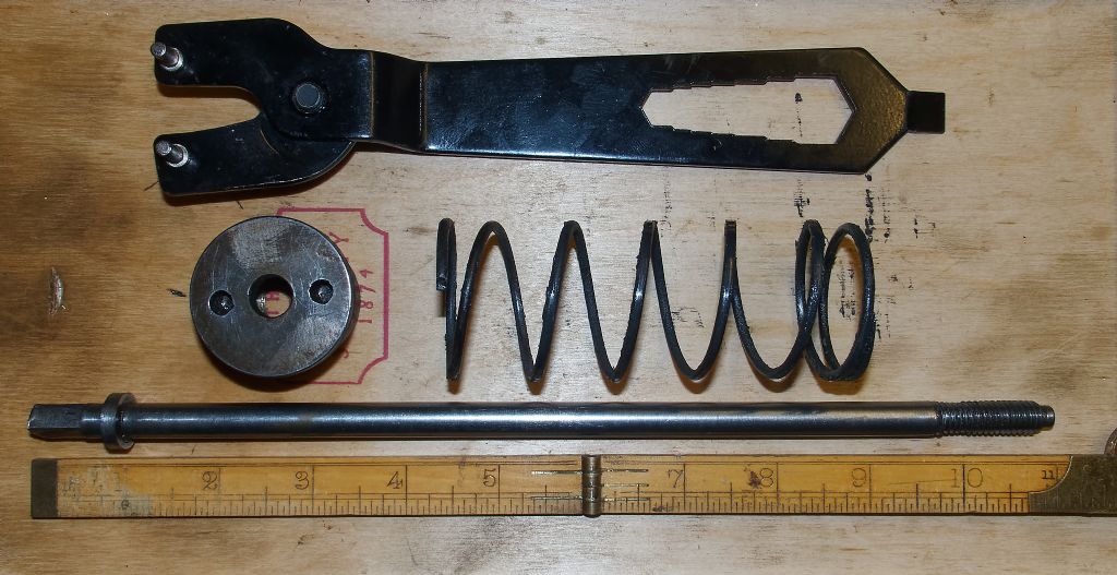

      I need to make the drawbar eject for a centec 2A mill (mine is missing). I came across this picture on a previous thread and it all makes sense, except, what is the spring for ?
      https://www.model-engineer.co.uk/wp-content/uploads/sites/4/images/member_albums/94472/823008.jpg
      #14627
      Andrew Shelley
        @andrewshelley86629
        What’s the spring for?
        #608073
        Dave Halford
          @davehalford22513
          They never had one to start with Andrew. smiley
          #608078
          Andrew Shelley
            @andrewshelley86629
            Thanks, that explains my confusion. I should probably dig out some exploded parts diagrams.
            #608081
            Gary Wooding
              @garywooding25363
              The drawbar is just the long piece above the ruler. The spring sits on top of the quill and is not part of the drawbar at all, it is held in place by the circular nut. The nut is removed by the spanner, which is only required if you need to remove the quill for some reason.
              #608082
              peak4
                @peak4
                That one's my photo, and is the drawbar and cap from a Mk3 vertical head, on my 2B, to help return to the quill to the top of the vertical position.
                As it happens, I've just made two new ones, one 3/8" BSW and the other M10, so whilst you're geared up, it might be an idea to make a matching pair.
                My older milling/drilling chucks are all imperial, whereas new replacements are normally cheaper if you buy M10 ones.
                My horizontal draw bar doesn't have a spring.
                My clamping kit, T bolts etc, are all M8 with 17mm flange nuts, so I also made a peg socket with a 17mm hex head to facilitate swapping draw bars, rather than struggling with the peg spanner shown in the photo.
                Bill

                  Posted by Gary Wooding on 01/08/2022 13:50:34:
                  A typo maybe Gary, you need to remove the circular nut to change the vertical drawbar, rather than just to remove the quill.

                    Ah ha, pushing the quill back up makes sense. I'd never really thought about the quill not returning as I normally use the rotary handle to wind it up and down then lock it off when not in use. I'll factor that into the design, looks like it'll want a bit of space for the squashed spring on full quill extension.

                                On my vertical head M10 threaded bar will drop through the spindle but it doesn't take much runout in a piece of 10mm rod to bind up. I've opted for 9.5mm final dimension on the bar with a short threaded M10 section (20mm) to engage with the taper threads.
                                I'll post a picture and prints when I'm done. First attempt in the scrap bin after trying to press fit a collar that was a bit more interference than I expected and noodled the rod. Second attempt just turning out of solid bar, you live and learn.

                                  Posted by peak4 on 01/08/2022 14:10:19:
                                  Bill
                                  No typo. On my MK3 VH the drawbar is not retained in any way. After unscrewing it from the tool-holder/chuck whatever, it is free to be removed. I suspect that my VH isn't standard because its ISO30. With ISO30 a gentle tap is all that's required to free the tool from the taper – there is no need to forcibly eject the drawbar.
