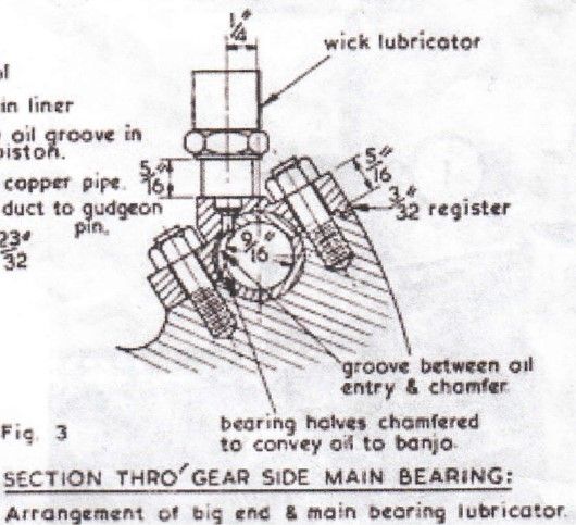

        Had my new build Centaur engine running for a bit now and seems to have freed up well as I had made the fit of parts a bit snug!
        Upon dismantling for final painting I noticed a couple of points which I am hoping someone can help with.
        The big end bearing looks as if it has not had sufficient lubrication, oil is supplied to it via a banjo fitting on the crank web which supplies oil from a main bearing. Mains bearings are a good fit with excess oil supposedly entering the banjo and on to the big end but I don't think sufficient oil is leaving the main bearing.
        Could it be the bearings are too good a fit or would the main journals benefit from a groove somehow? Oil used was a fully synthetic 5-30 grade so quite low viscosity.
        Also all though I assembled the piston rings with the gaps opposite each other and not on the loaded side of the piston they have both turned to end up on the loaded stroke side? Do they turn in normal operation?

          There is a modification for the banjo oil feed, I also fitted a oiler to the conrod bearing, not sure why your piston rings are moving.

                Hi Alan, The Centaur mods are from a article in Model Engineer 19th November 1976, Volume 142 No 3549 and titled Experiences With The Centaur By R.R.May.

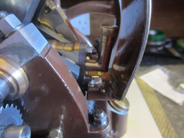

                My conrod oiler has a screwed cap, as photo. Michael.

                  Thanks Jeff, not keen on Edgar's design then! Michael, how on earth did you know about that article! We're not the only ones to witness lubrication deficiencies then.
                  Priorto assembling my newly painted engine parts I took the opportunity to modify the crankshaft bearings.
                  Now as the oil flows through the top bearing caps it enters a 1/16 wide and 0.010 deep channel I have milled axially in the top bearings. On the flywheel side the channel stops just short of the bearing ends but in the banjo/gear end I have taken the channel to exit the bearing which should allow oil out into the banjo.
                  After assembling the engine and filling the lubricators I definitely had oil flowing through to the big end so fingers crossed it also does this while running!
