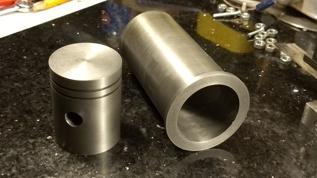

      Did a bit of ‘fettling’ today to enable assembly of parts that I have machined on my Centaur engine.
      I trial fitted crank with con rod and piston into engine frame with water jacket and cylinder.
      It suprised me to find the piston protrudes out of the cylinder top by 1/8 inch?
      Checked through the drawings and it appears to be correct – meaning the piston will be entering into the cylinder head space?
      Does this sound right, I just assumed the piston would rise to be flush with cylinder top.

          Adding up the sizes on the drawing I get that the piston should be Flush the end of the liner at TDC
          Bed 4.500" + Hopper 2.250" + Liner lip 0.125" = 6.875"
          Crank Throw 1.000" + Conrod 4.312" + 3/16 + Big End Bearing 0.375" + Pistion 1.000" = 6.875"
          Looking at your photos the wrist pin does not look to be in the middle of the pistion
          Edited By JasonB on 30/12/2018 12:29:51

            Yeahbut, the other pic, with the piston t’other way up, looks like the piston pin is closer to the other end.smiley

                  NDIY, It does look a longer piston in the other photo, ring and distance of pin from ring groove looks about the same in both. Drawing has a 2" long piston with the pin centrally placed eg 1" from either end.

                    Thanks for your replies, must be an optical as the gudgeon pin is in the centre of the piston!
                    Jason, I can confirm the dimensions for the non moving and some of the moving parts but the drawings I have for the connecting rod give an overall length of 4 5/8 (4.625), gudgeon pin c/l to end where big end is secured, which gives the ‘moving parts’ overall of 7.000in?
                    Which is what’s giving the 0.125 bit sticking out the top.
                    I guess it’s supposed to end up flush, I will have a measure up of how much material thickness is in the piston crown for a possible mod?

                      Just looked at the ME series and that gives the conrod as 4 7/16 + 3/16 and overall as 4 5/8 but sheet drawing shows 4 5/16" + 3/16" but with a total length of 4 5/8" which is 1/8" different!

                          I know it's to late now for you, but I took the length for con rod / piston off the job when making my Centaur, the piston finish's flush with end of liner.

                            I’ve decided to shorten the connecting rod, I silver soldered the big end flange on (quite nicely I thought!) So will remove it, I have a centre in the bore of the shaft so I suppose it could be worse!

                              Shortening the Con rod will produce more side thrust on the piston, and so more friction. It will accentuate the tendency for the piston to "rock" within the bore clearance, which could lead to problems with the piston skirt and the rings, risking scuffing!
                              My advice would be to shorten the top land, if possible. If the drawing calls for a taper, it would be advisable to maintain the clearances, to minimise the risk of problems.

                                I did look at reducing the height of the piston but there isn’t really enough material at the crown to do this although this is obviously the easiest option.
                                By shortening the con rod I agree it would impart more side thrust to the cylinder/piston but this will then comply with the other drawings which are around.

                                      Today saw removal of the big end flange from the connecting rod, shortening it the required amount and silver soldering it back together.
                                      Didn’t seem to take as long as I had feared and because I had a centre in the flange end of the rod it was a straightforward modification.
