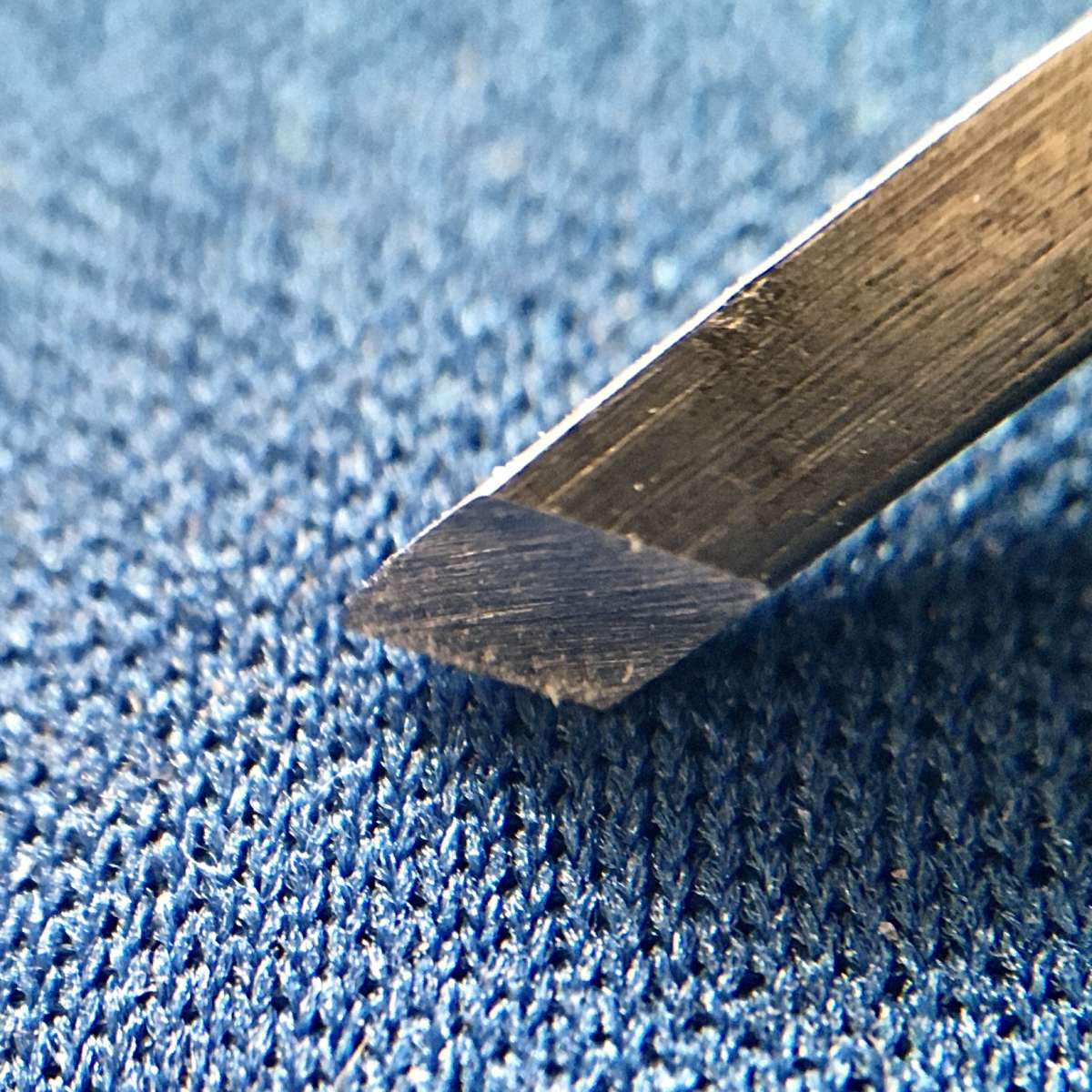

      I spent some considerable [but strangely therapeutic] time recently, correcting the tip-shape of an old graver … using a little sharpening jig and a ‘credit card’ diamond hone.
      The result was very good, but it still needs that final finish.
                I would normally use an Arkansas stone for this […]
                The scratches are from the ‘Fine’ 201 Diamond Hone:
                IMG_9754
                #735978
                bernard towers
                  @bernardtowers37738
                  Michael, I use 3M micro polishing paper in various grits down to 3micron and it finishes to the degree that you can see clear reflections, this is presuming the graver is HSS. One of the good things with this micro paper is that the grit size is carefully managed so you should not get the gouge marks you are seeing. Best of luck but it makes your hand ache!
                  #735985

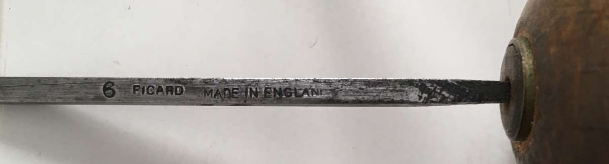

                    That’s interesting, Bernard … I had never considered using paper.
                    The graver is almost certainly a high-carbon steel and is, I think, of considerable age .. it is marked thusly:
                    IMG_9735
                    … which was a surprise to me.

                                                  Just a note about my PICARD graver …
                                                  I should really have mentioned that, as manufactured, this one is clearly more suitable for engraving than turning.
                                                  The blank is, by no stretch of the imagination,  ‘square’ in cross-section !
                                                  From my experience of re-shaping the tip on a diamond hone, I feel quite sure that it is very high quality ‘crucible steel’ … like the very best plane-blades.
                                                  I plan to keep it for that purpose: The Swiss gravers being ‘square’ are much better-suited to lathe work.
