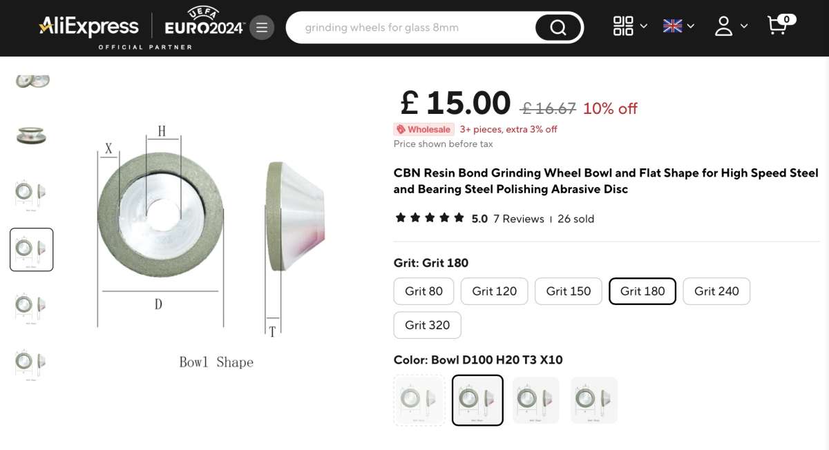

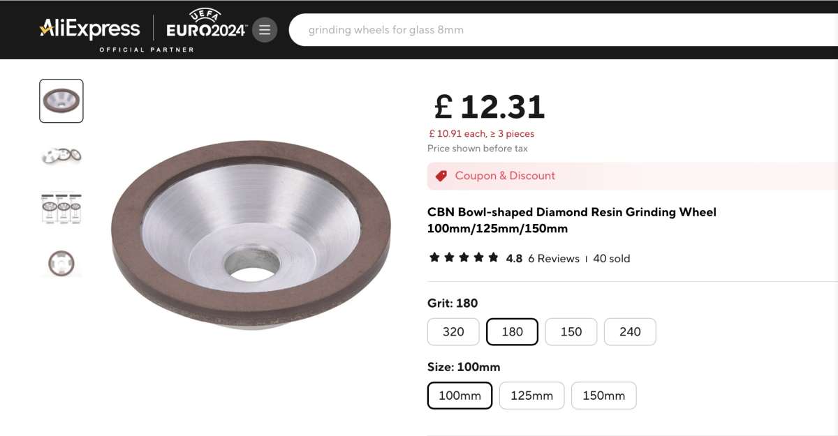

      Anybody has any experience with CBN wheels for HSS tools? It seems to me that they have only advantages comparing with aluminium oxide types. No dust, no danger of breaking apart, no need to dress it, no glazing and perfectly balanced out of the box. I think I’ll buy one for my bench grinder. Just can’t figure out what grit size to use, maybe 180?
      #732050
      John Haine
        @johnhaine32865
        Seems to be a very limited choice anyway, only seen 80 and 180 grit.  I have the latter, excellent.  80 would be too coarse I think.

            Apart from the price, 2 to 5 times more than an aluminium wheel!
            In my workshop, CBN is unlikely to be ‘value for money’ because it takes me so long to wear out a grinding wheel.
            I also use the same wheel ‘general-purpose’ on mild-steel and non-ferrous metals.  I understand CBN to excel at grinding hardened steel, but is it good for anything else?

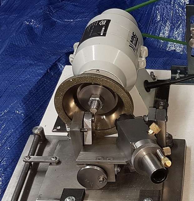

                    I have a cbn cup wheel on my t & c grinder and as you say no dust just grinding debris, I use it for drills up to about 1/4 inch

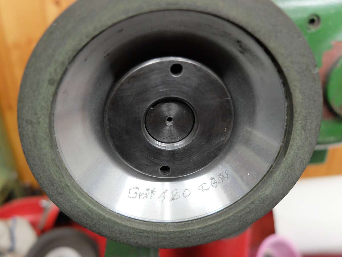

                        Sonic Escape
                          @sonicescape38234

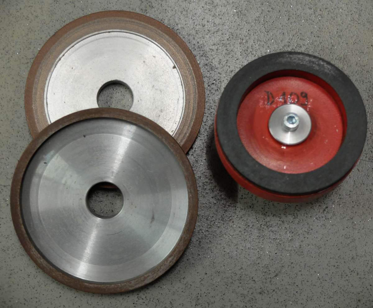

                          I also have a cup wheel but I always thought it is a diamond wheel. Could it be CBN? The grit is W28, equivalent of 500-600 I think.
                          #732138
                          John Haine
                            @johnhaine32865
                            That looks like diamond to me.  CBN has the grit embedded in metal surface

                              bernard towers
                                @bernardtowers37738
                                My CBN wheel is made the same way as the one pictured and its an English manufactured one

                                Sonic Escape
                                  @sonicescape38234

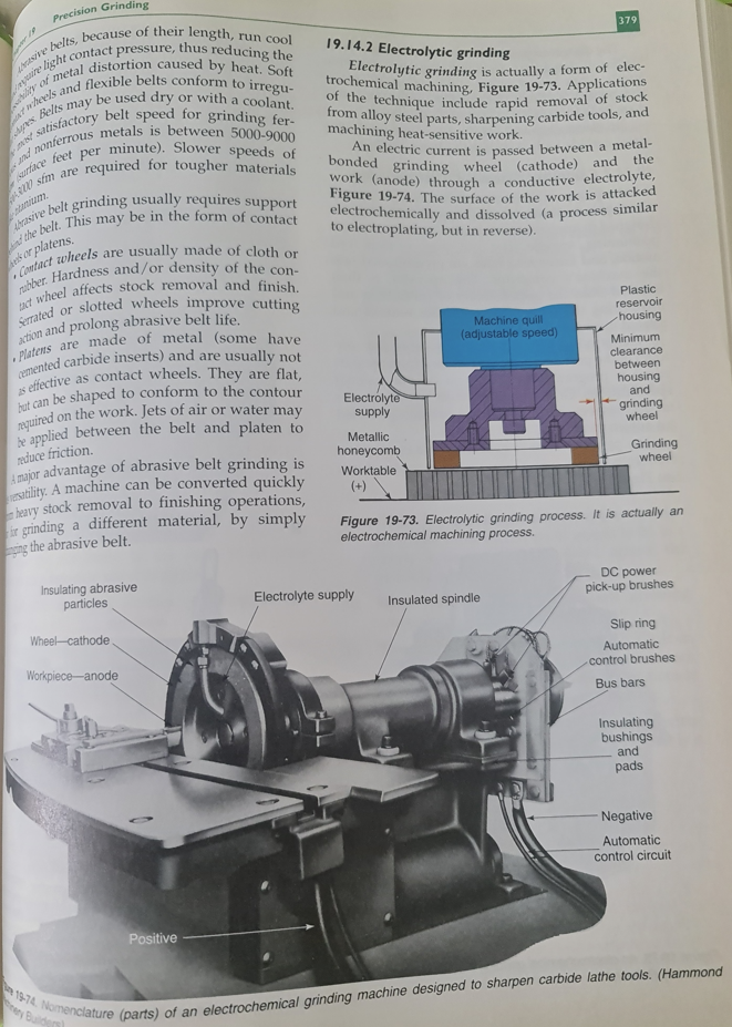

                                  I can’t remember where but I read that when you mix soft metals with steel on the same wheel you can embed steel particles in the softer material. There was also a picture with rust spots on an aluminum part.
                                  And here is what Machining Fundamentals recomends:
                                  #732163
                                  Sonic Escape
                                    @sonicescape38234
                                    And is has the same color? I want to figure out what kind of wheel I have. I read that carbide tools destroy the CBN wheels.
                                    While I was browsing the Machining Fundamentals looking for the page from above I found some info about electrolytic grinding. I looks like an alternative to CBN to get rid of the dust. Looking at the cables I guess some serious current is required. I think it has even cable drop compensation connection!

                                      Versaboss
                                        @versaboss
                                        Well, that’s not always the case.
                                        Here is a picture of my CBN wheel (coming from somewhere in the very far East iirc) on my Thommen grinder
                                        DSCF4540
                                        DSCF4541
                                        And another picture of 3 different Diamond wheels. The left pair comes from ARC, the one to the right from Eternal tools.
                                        Sorry, can’t move the text above the picture… Same problem as in the old forum.
                                        Regards, Hans
